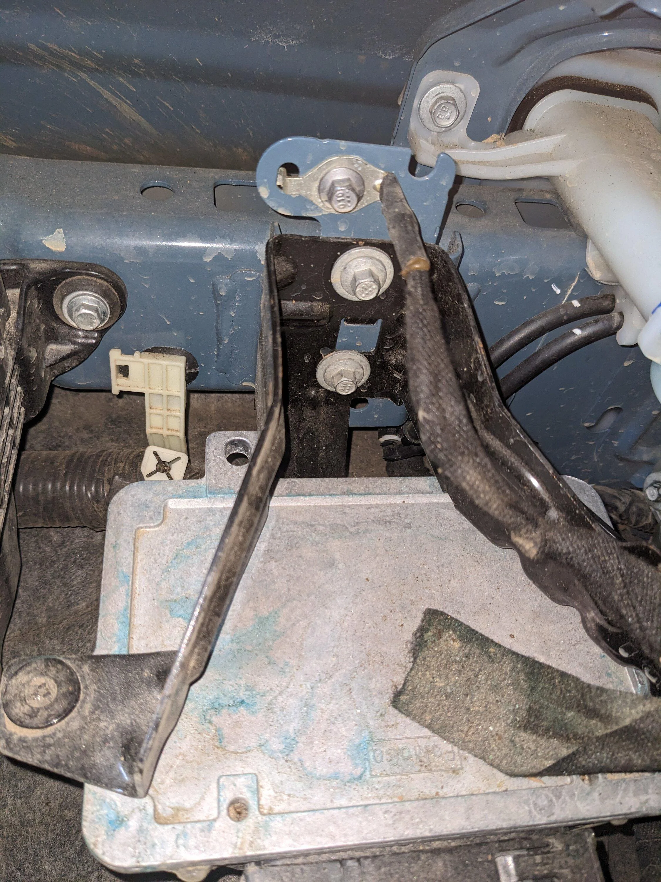

Seems like Ford is intentionally Isolating bolts from ground, I checked the bolts I could get to on the radiator support, and all of them are high resistance to ground, including the ones that hold the hood latch on, and yet the support itself is 0 ohms to the battery negative everywhere I could get to it.
I looked a the places under the hood that you'd have to have a ground, and found that all of them have dedicated ground wires.
Some good examples;
The PCM Bracket;
Ford Bronco Alternator Upgrade 1672006459091
The Ground strap at the top has 0 ohms, and the PCM case itself has 0 Ohms (Delivered through the PCM Connector itself, not the bracket). The two bolts holding the bracket on are high resistance, The Bolt to the right is on the airbox, And it is starngely 0 Ohms to ground.

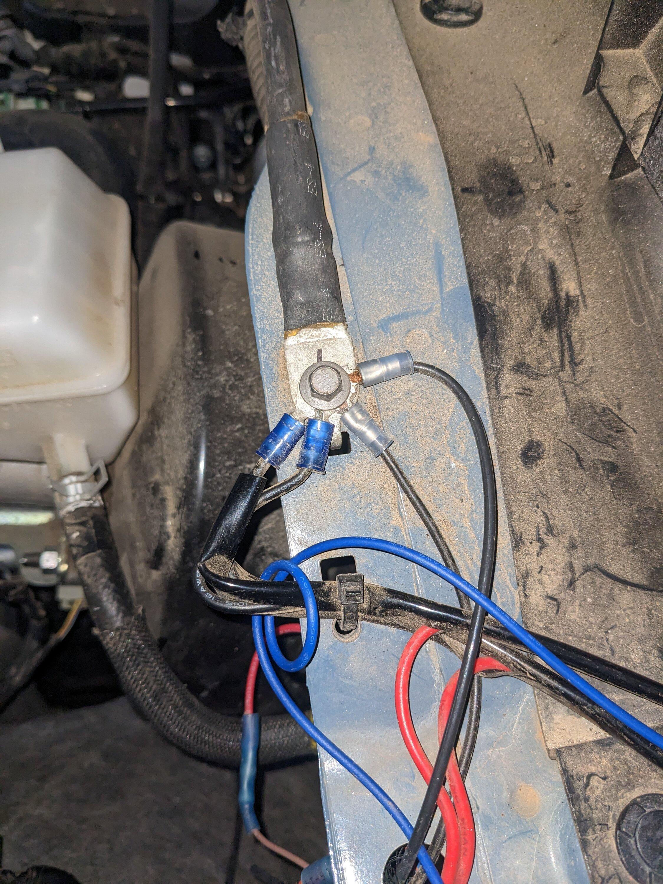

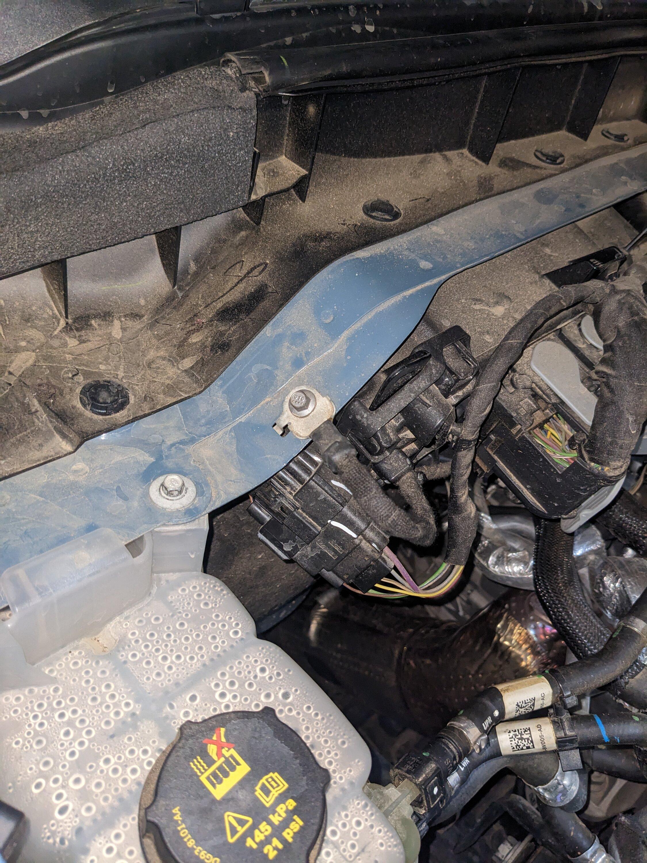

The Cowl has two;
Ford Bronco Alternator Upgrade 1672006990519
Ford Bronco Alternator Upgrade 1672007322309
The Bolts on the radiator overflow to the right have high resistance.
I've been using the one on the driver's side to hook up all the grounds for stuff I add, But that was because it's right by all the Aux Wires so I just went there, I didn't realize it was going to be the only decent ground around there. All the other other exposed zinc bolts on the cowl have high resistance.

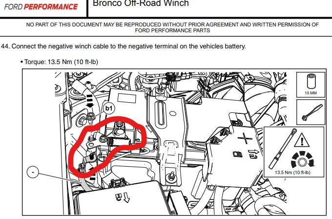

I hooked my winch negative to that open hole, and I've been wondering if I should be running it directly to the battery or not. The idea of pulling that many amps through that sensor does worry me a bit.
if it's any consolation, that's where Ford itself instructs you to ground its own Ford Performance/ Warn winch kit (and where Everglades models do the same from the factory).
