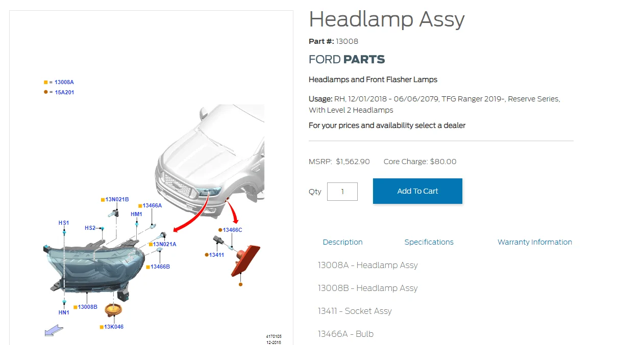

  • MSRP for each headlight is $1,600 (assuming no core swap)
  • Please note that for Ranger the grills are identical between signature and base lamps. I do not know if there are grill differences for Bronco, I'm assuming not as they heavily advertised that there would be many grills to choose from and they are single-piece replacements.

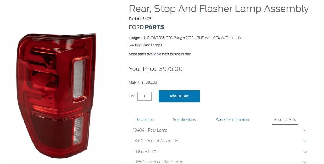

  • Price for Ranger is $975 eachfor BLIS equipped tail lights. This includes the BLIS sensor and controller, so expect Bronco part to be cheaper individually, but about the same price overall.
  • First you must understand that the Signature (LED) tail lights for Ranger & Bronco contain the BLIS sensors. You will NOT gain BLIS simply by adding Signature tail lights with the sensors. It is also not known if they will function properly as tail lights.

  • Price for NON-BLIS tail lights are $275 each.

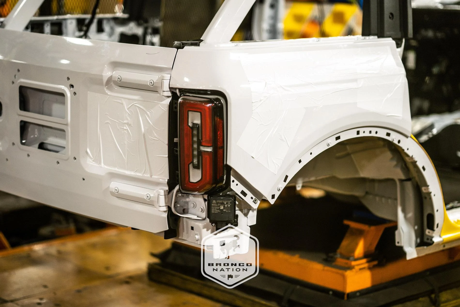

It’s worth pointing out that current information makes it appear that BLIS is *not* in the taillights of the Bronco... which if true, would at least remove that complication and expense from the equation.
No indication on the tail lamps, and these modules are on both side of the Bronco behind plastic on the rear. They have a harness going to them.... might be the BLIS sensors.

Unknown, we know the BLIS controller is down there, and it makes sense to divorce the systems. If they were divorced, i'm guessing there was some insurance company pressure as replacement parts costs are a concern for OEM's.
There are two missing pins between the two harnesses shown on the thread linked in the OP, what they go to is anybody's guess.

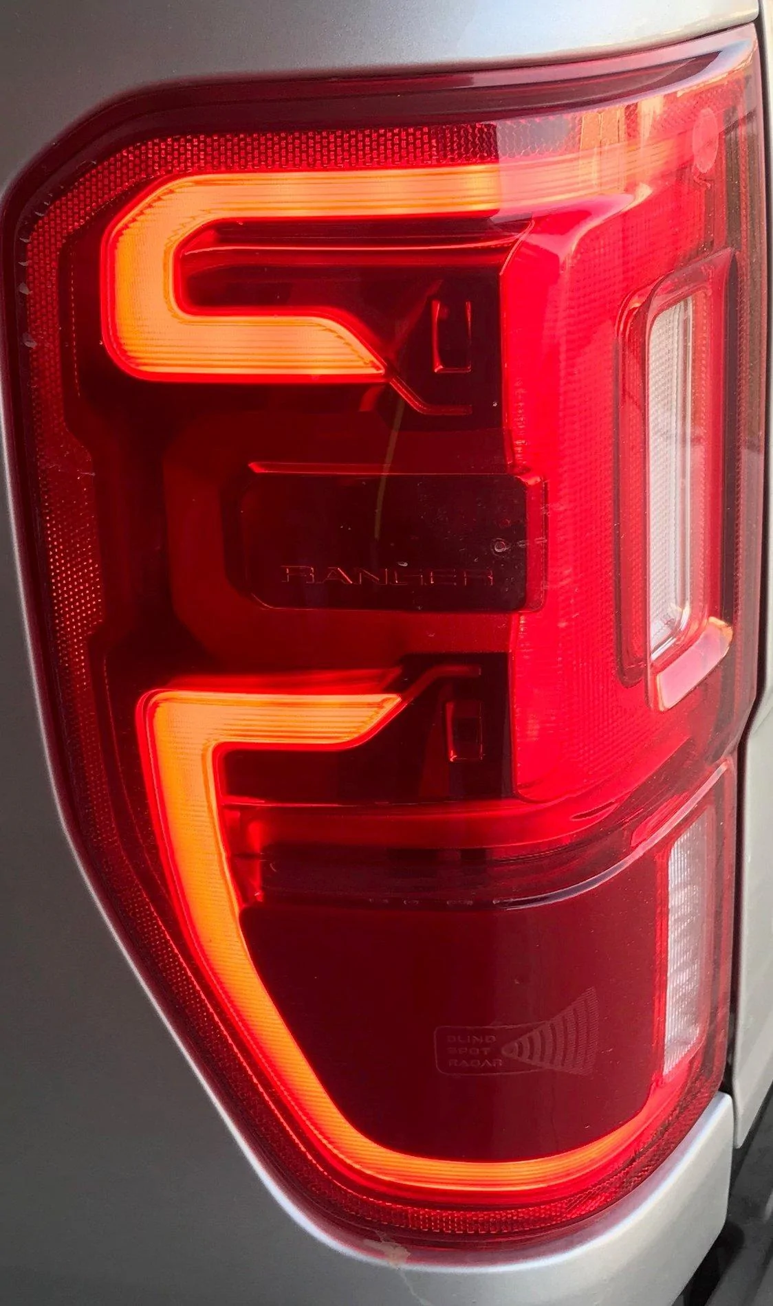

Also note that the BLIS logo on the Ranger tails is incredibly difficult to see. We have not had high res close ups of the tail light sides to know if they have a logo on them or not. Notice the very small icon in red on the red part of the tail light. The BLIS sensor is also behind that from what I have seen (could not easily find a pic to confirm at the time of this posting)
Edit: I'll also point out that a BLIS sensor will have reduced efficiency and range if placed behind a metal panel. Mounting the sensor in a tail light makes a lot of sense if that is indeed the case (I am not an engineer nor do I know what research Ford has done regarding their sensors array)
