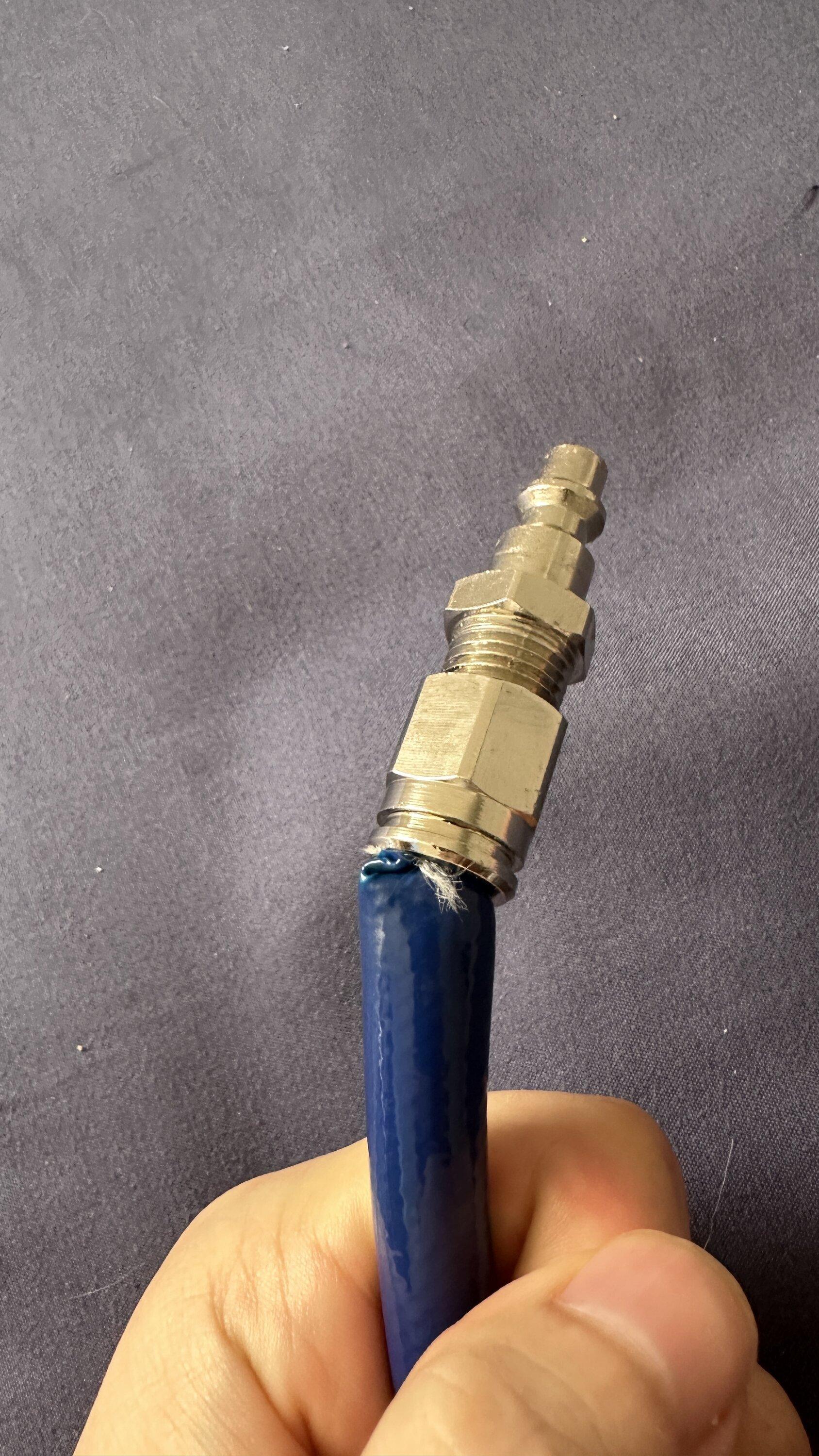

My arb air hose melted at joint. Anyone know how to take it off and repair. I unscrewed it but it just keeps spinning.
Ford Bronco Arb air hose fitting failure. IMG_4840

Aren’t those fittings usually crimped onto the hose?
Seems you could unscrew the quick connect off the fitting and crimp a new NPT fitting on the hose at a shop, or use a barbed NPT fitting with a clamp

I had the same issue, fixed it easily by watching this video:
That's crazy that this isn't an advertised feature, bush/trail fixable! Two wrenches and a knife and your back to airing up...

I did the same thing. You have to watch that the rubber protector is pushed all the way to the end of the hose to protect it from the heat. We also had one of the two fuses blow on my friends setup so he only had one of the dual pumps running so carry extra fuses as well.
