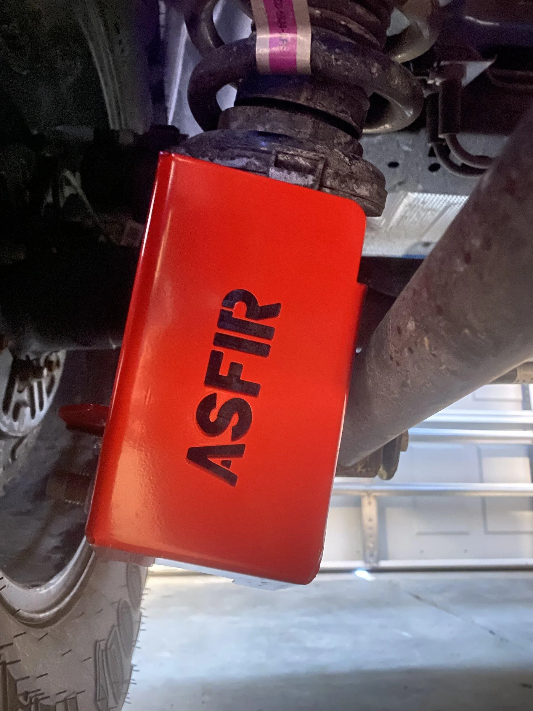

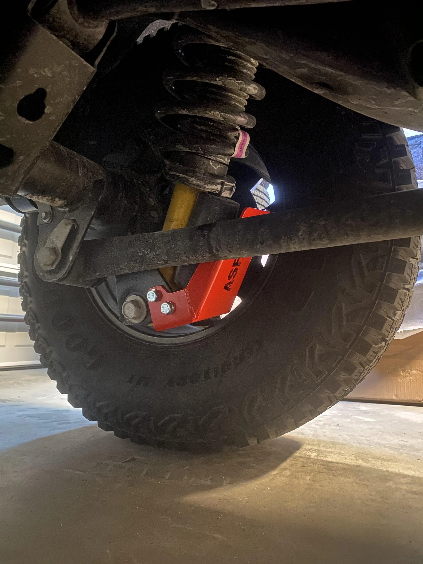

The guys at @ASFIR 4x4 are the best. I had forgotten to use my forum discount when I paid, and they noticed and refunded me the difference. Considering they are shipping from Israel, I couldn’t believe how fast they got here. As for installation, literally couldn’t be simpler. All done in about 1/2 hour.

These look pretty good....better than alot of them Ive seen.
I'll build something similar for my Bronco, but with 2” more ground clearance. The shock just hangs too low.
I want my setup to be flush with the trailing arm!

Is the passenger side skid closer to the trailing arm than the driver side ?

What did you torque the lower bolt to? Manual says 350 and that the nut/bolt are one time use...another plate manufacturer says 240. I clarified that the one time use thing is most likely more about Ford thinking the average person won't use the ideal thread sealant, versus the bolt stretching and not being reusable, and at 50 dollars each and not owning a wrench that accurately measures 350 I went with 240.
