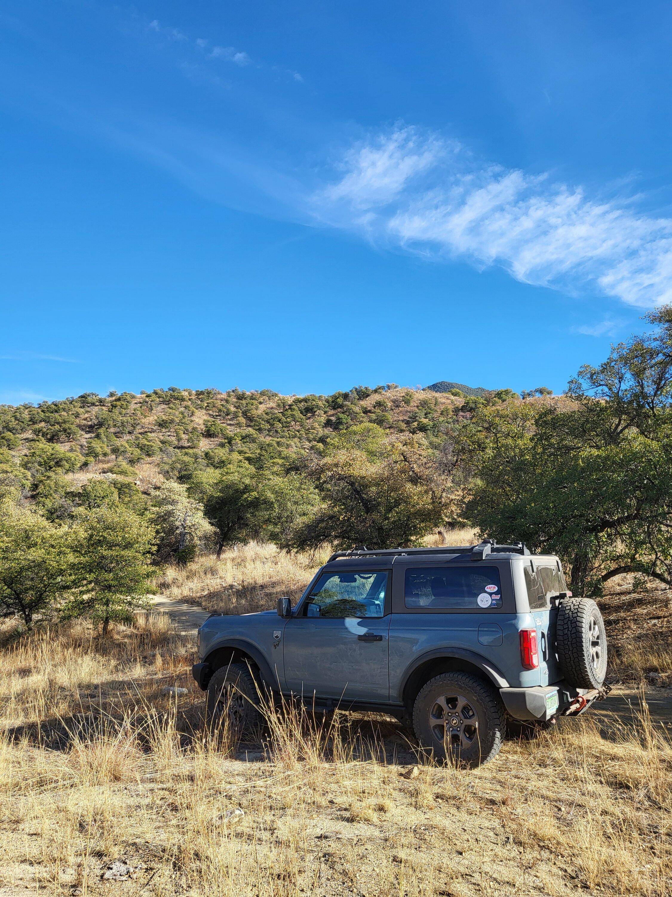

While traveling moderate to rough trails (steep, washed out , rocky) trails in Arizona this past week I experienced the parking brake sticking on after auto applying on a steep grade when shifted to park. The owners manual states the brake will apply when shifted to park on a steep grade, then will release manually or automatically when back in gear. The problem is it would not disengage on two occasions. Miles back in, rough country at night, not good.
Both times I was in low range in steep terrain, placed the Bronco in Park to scout the route, was unaware, but the Bronco also set the parking brake. The first time I really didn't know what was happening, by the second time I figured it out. I had to power through the brake, the obstacle and the steepness, it was about all the Bronco could do. The Bronco did not auto disengage as it should and , once I figured out what was going on, would not manually disengage. I powered through to a leveler spot, the first time it disengaged right away, the second it took about 10 minutes with on off cycles, every brake related warning light in the book, hood popping and owners manual reading then just magically released itself.
My question is, has anyone else experienced this and is there a work around? Do any of our Ford service friends @flip @Ducati1098 or @RagnarKon have an answer? Both times I was unaware the brake had set, I did not try to manually disengage until after I noticed the problem, I wonder if that would have worked?

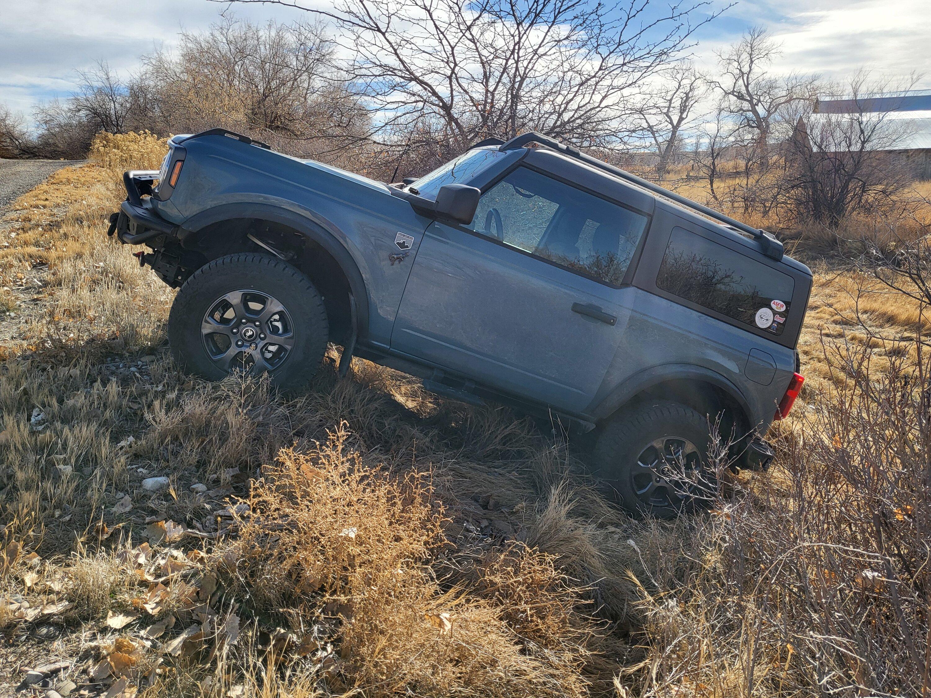

Idk if anyone's following any more, but I did a test today. Operating in 4L on a very steep embankment. The brake did not auto set when shifted to park and released fine manually and when driven forward or back if manually set. It seems my experience in AZ may have been a dream.
