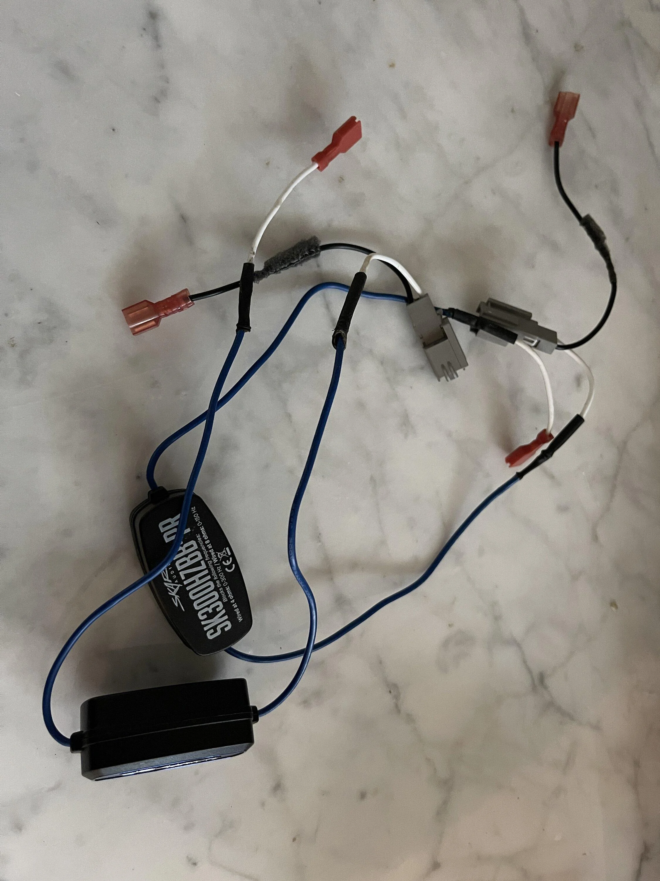

I ripped out the 4ā€ Kicker CS from the rears and replaced with the 4ā€ Hertz DCX-1003. Huge difference. So clear and louder. I also got the 150-300hz bass blockers for the front and soldered them in the wiring harness. Getting extra pair of hertz tomorrow and hopefully I’m done. šŸ¤ž

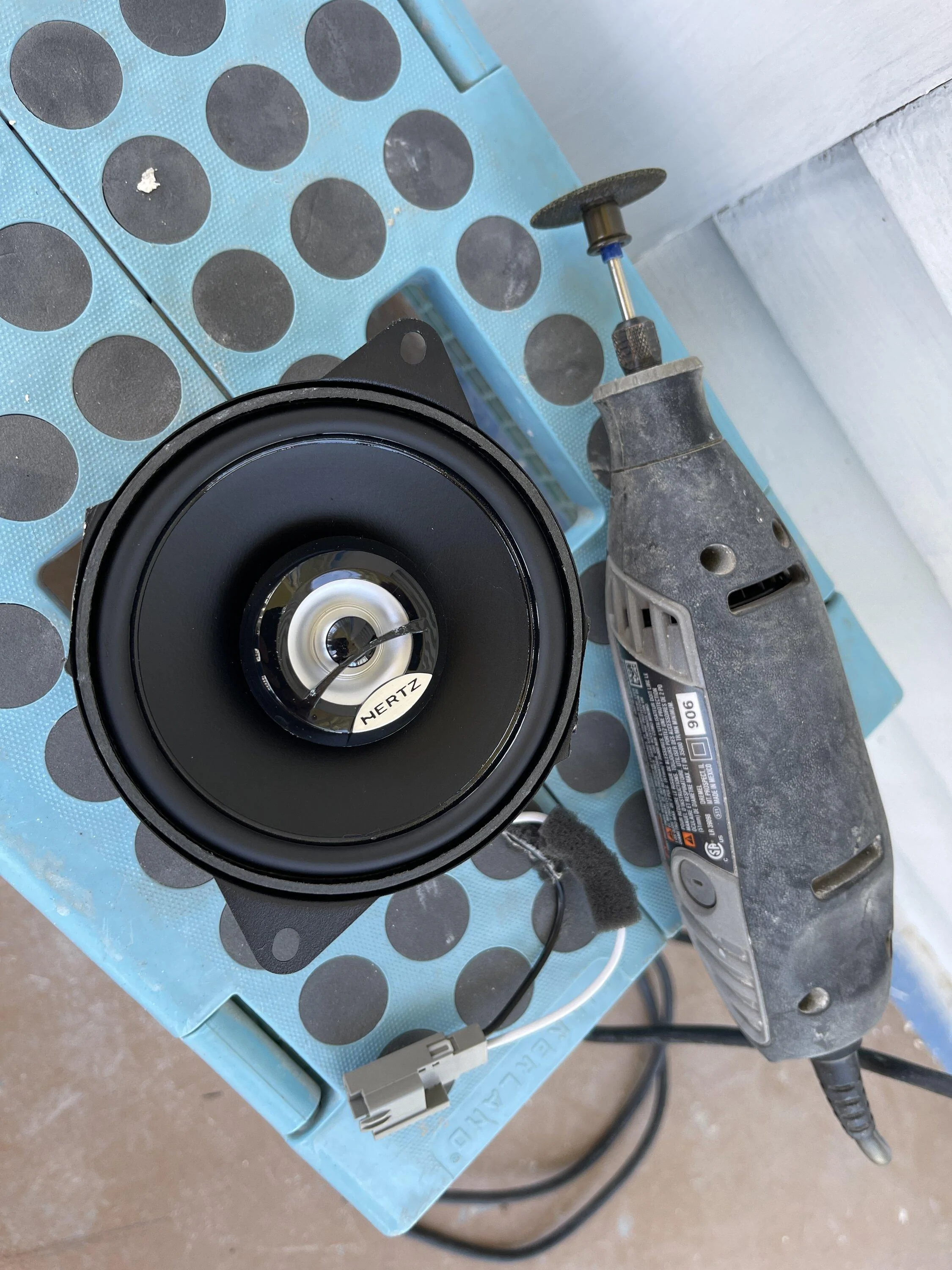

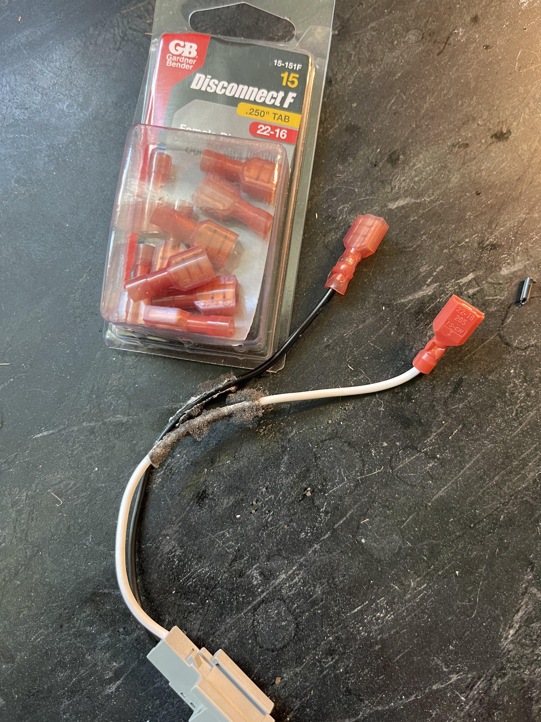

The Hertz DCX-1003 4" install is not as straightforward as other speakers.
Front, you need to pop off the plastic post. If you get a ready made wiring harness, it won’t fit the negative end on the speaker. They are both big male terminals. Snip off and replace with a bigger one.
Rear, you have to remove two tabs on the speaker to fit. I used my Dremel because it is extremely thick metal, unlike the Kickers CS has you can just snip off. I cut the tabs off with the speaker faced down.
Just need to heat the heat shrink down on the blockers and install tomorrow. There is a solder station at work, so that makes things easy for me, but my skills are super rusty.
