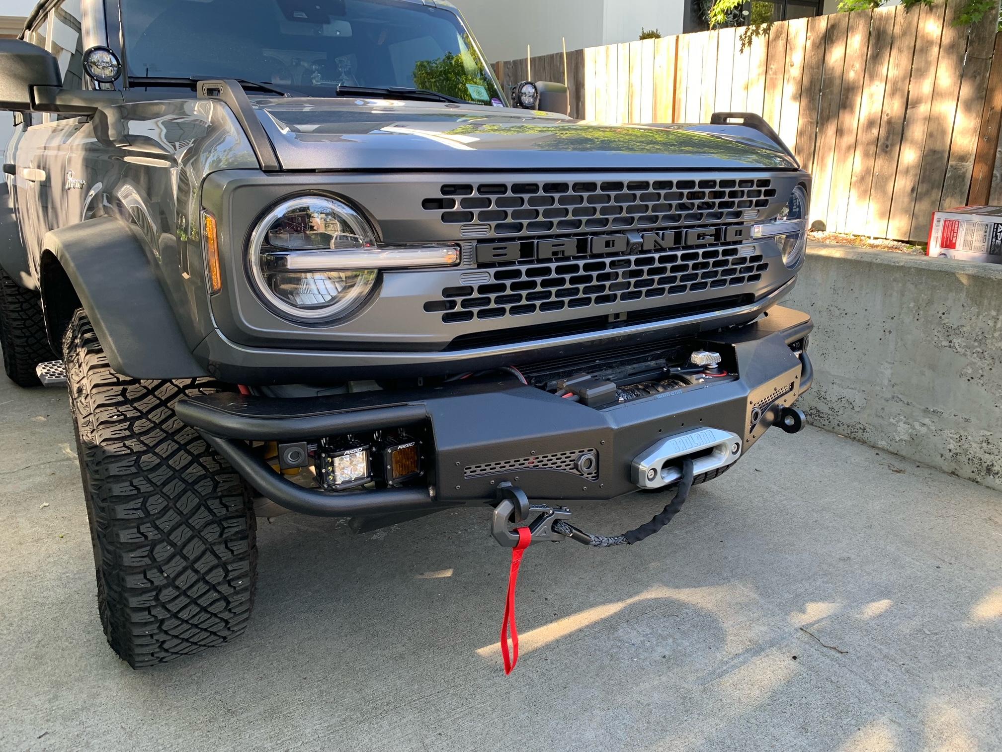

No overlander push bar just the standard BAMF bumper. Took me longer to wire up the lights than to mount and level up the bumper. I do not have all the front sensors though.

Thats right. The coating and welds on this bumper are perfection. I love the open ends for lighting and how it tucks the winch under the grill instead of up in front of it.

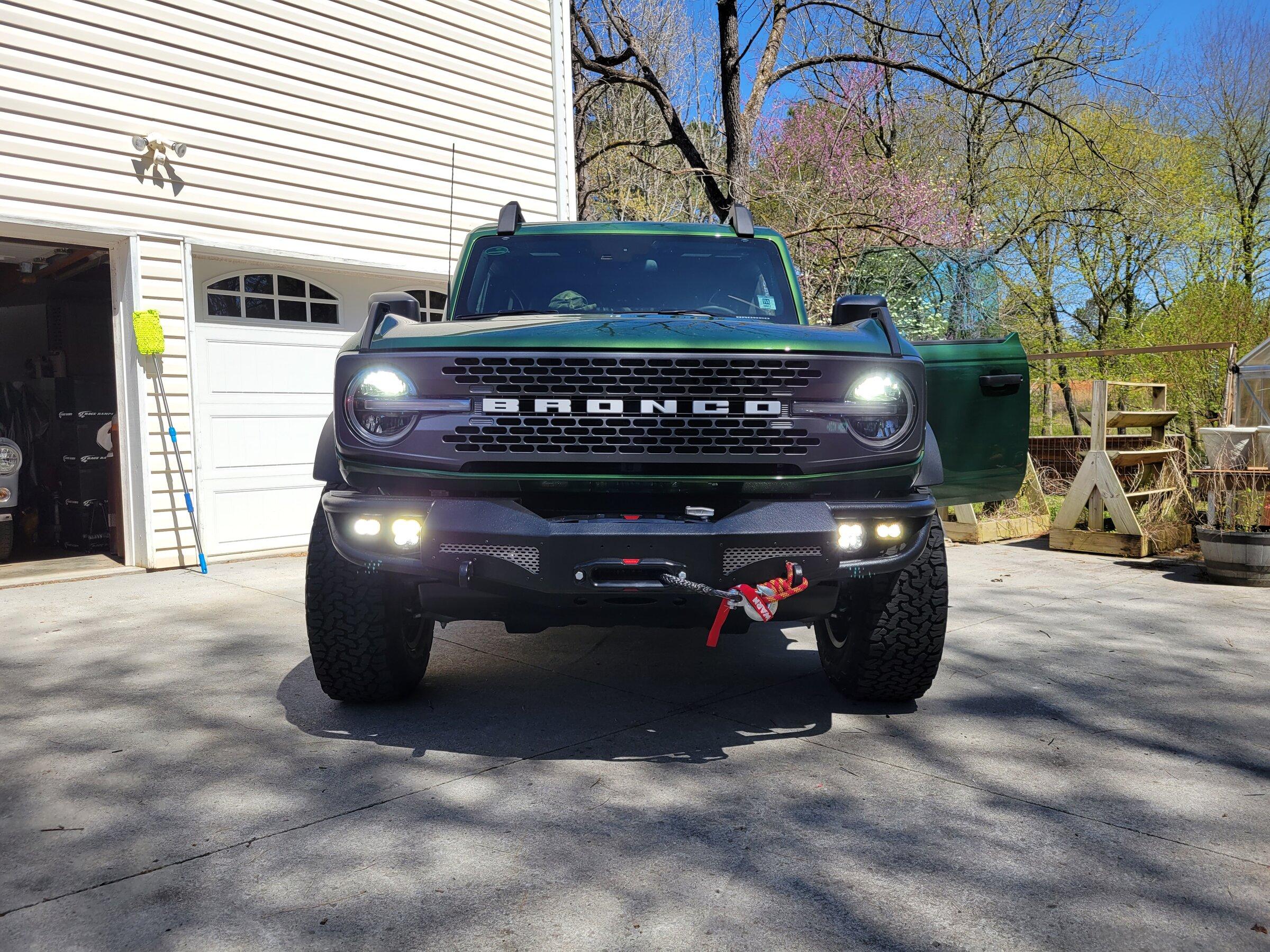

Some BAMF awesomeness!👍🏻

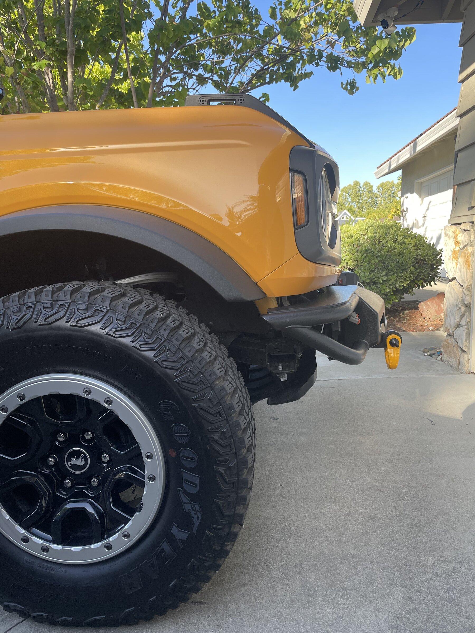

Can you put up a side profile pic?

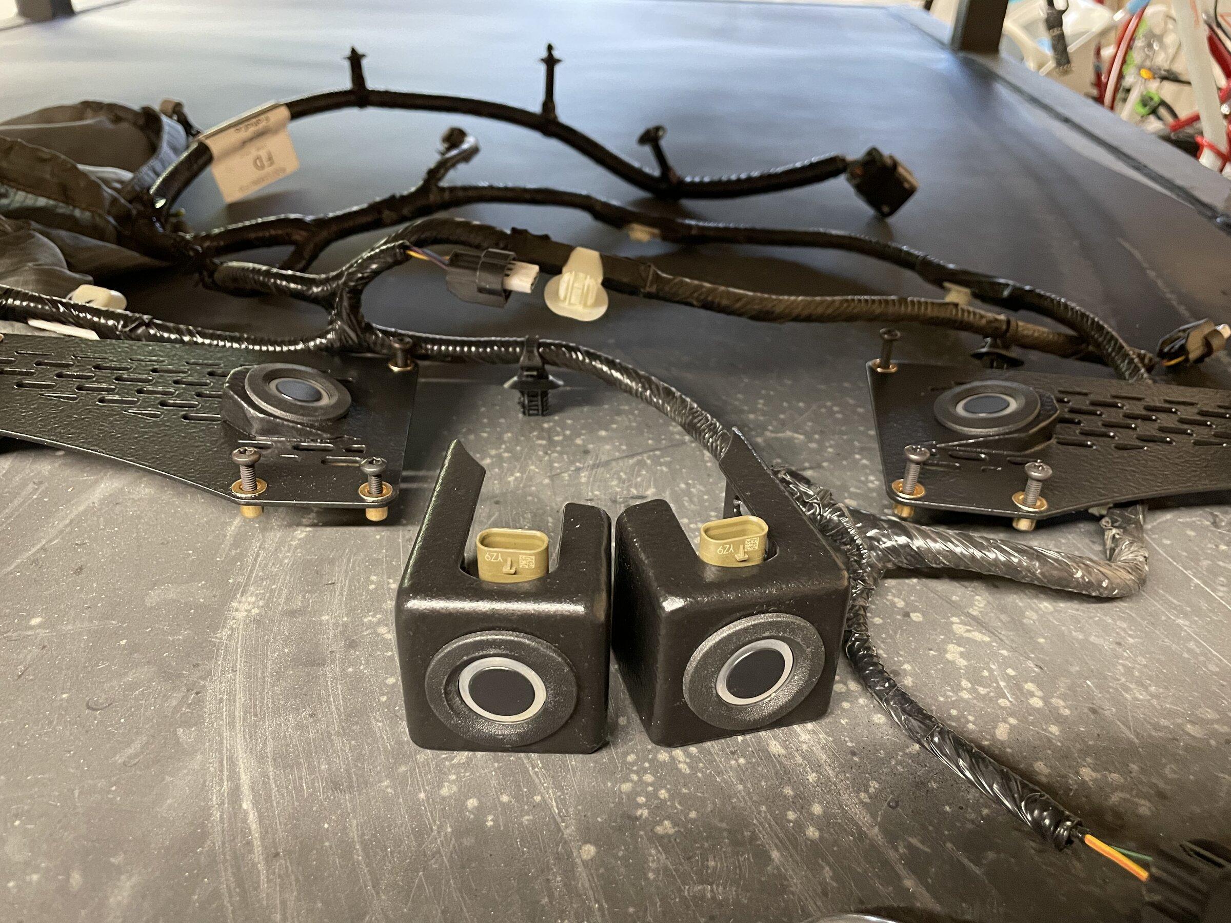

I’ll upload the install sometime next week, I’m still moving all the sensors for the LUX package. My build tracker will have details for installing all accessories.

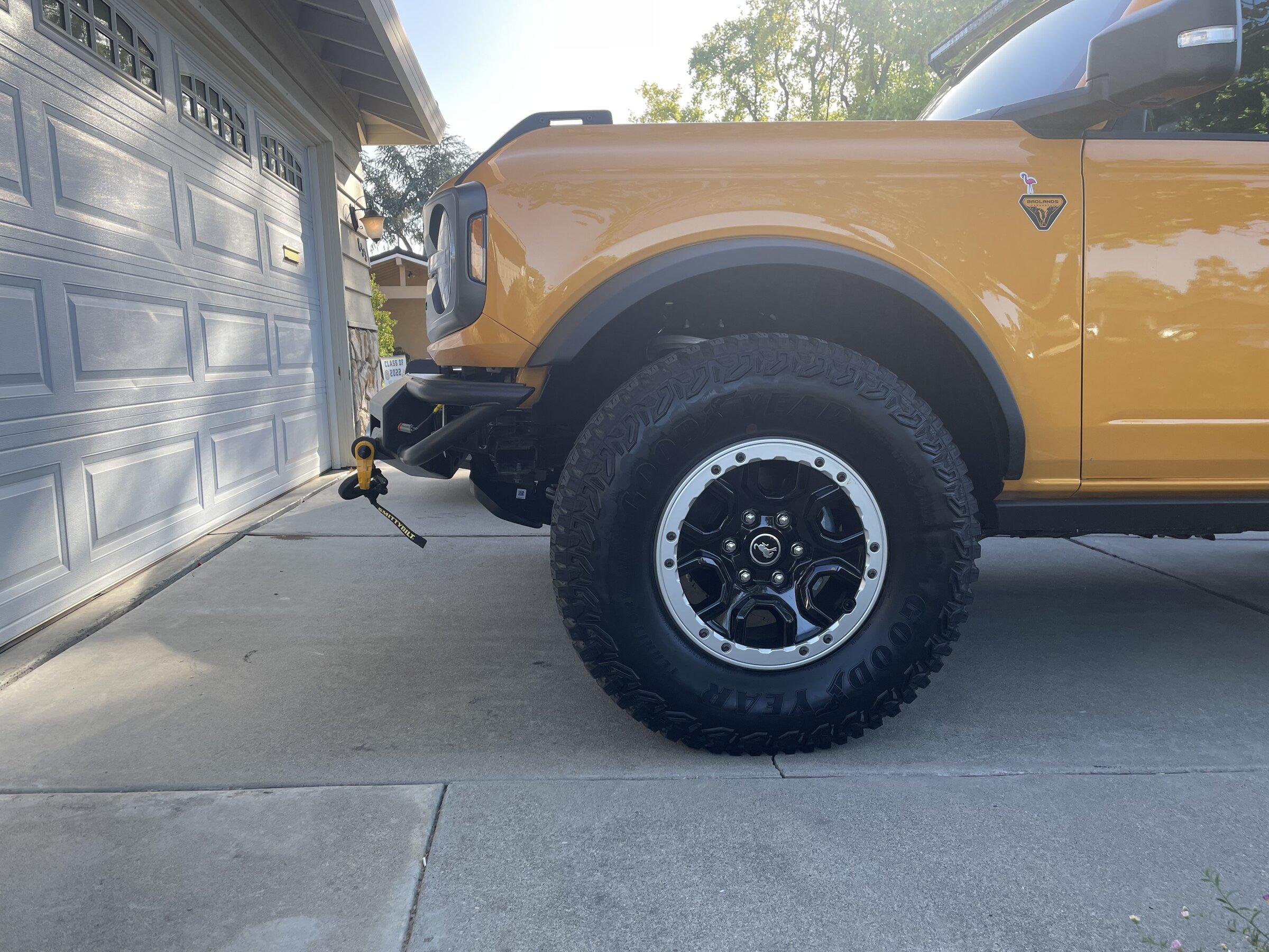

Finished yesterday - a bit like wrestling a greased pig at times - but it all came together in the end :)

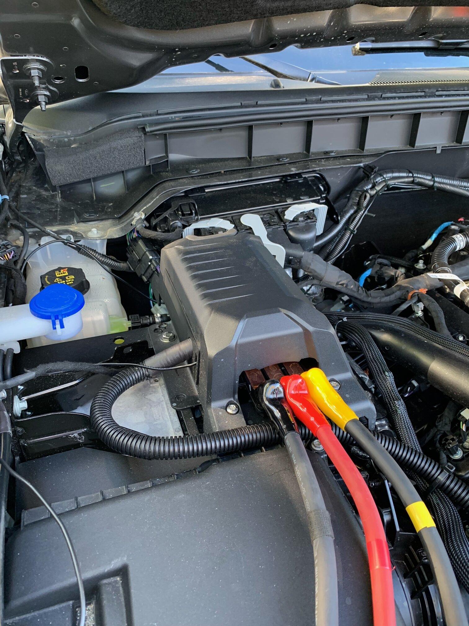

Do you have pics of where you mounted the solenoid? I have an old 9.5XP that I'm hoping to use when I get a bumper, but don't have my Bronco yet so not sure how to mount it.

Space will vary on your situation - I have the 2.7 so space was very, very limited to this as the only location that I could fit it and have it be useful.
