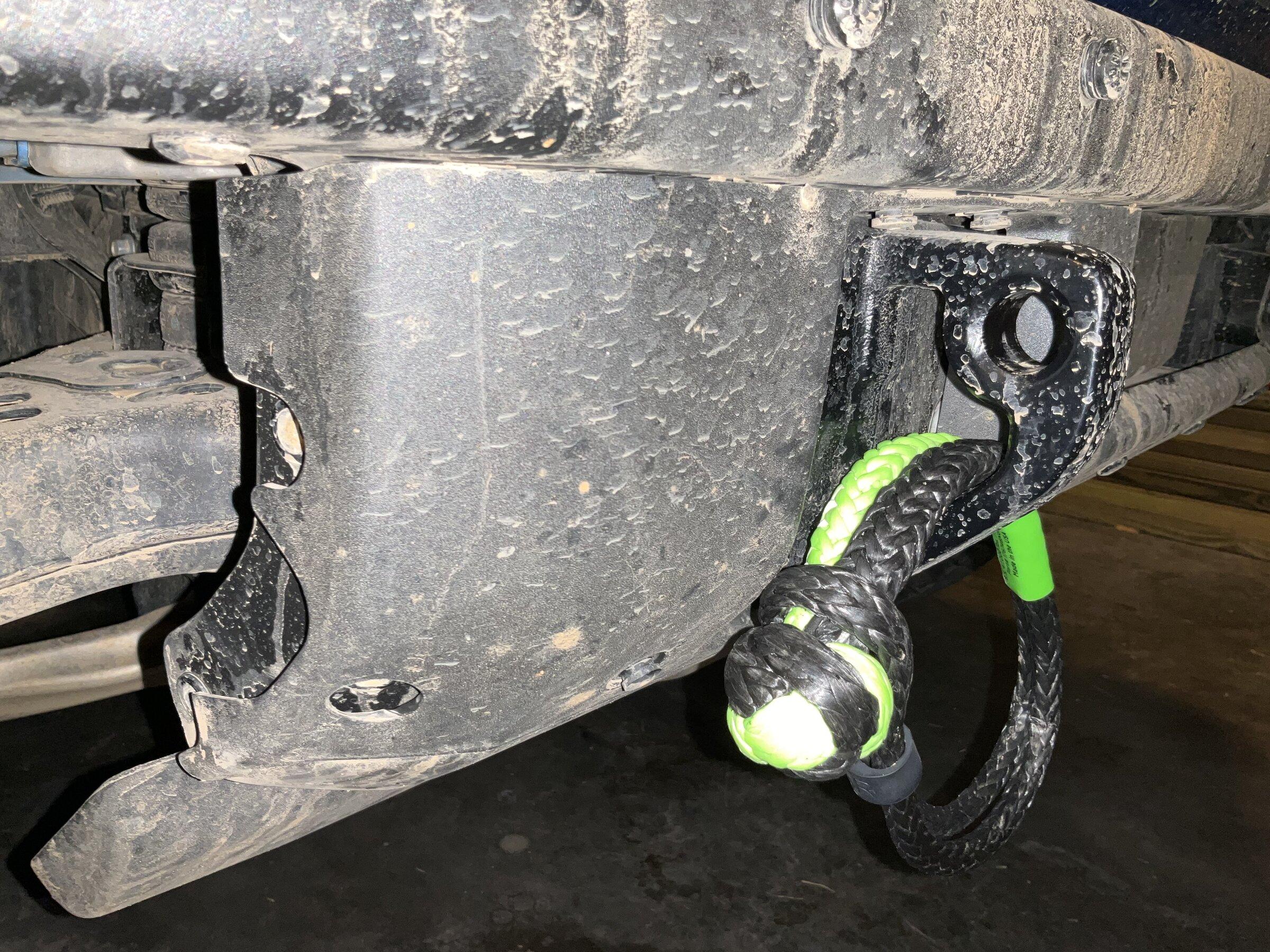

The mod bumper will be fine with soft shackles.
I keep anchor shackles on the vehicle and use soft shackles to attach rope to them. Conventional wisdom is keep the knot up on soft shackles (but I'm not sure why).
