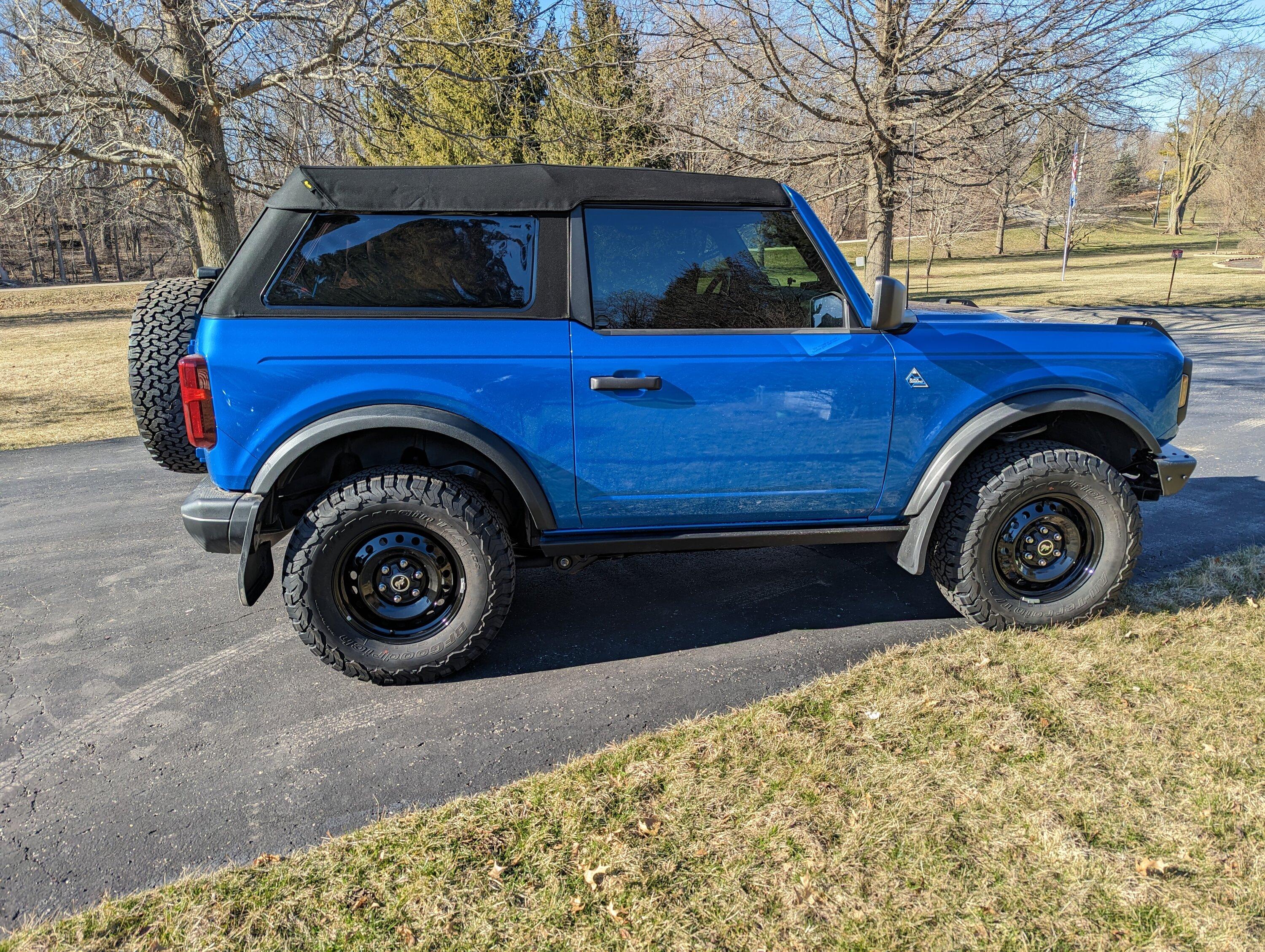

I was able to get it to work using the method in the video along with it finally being sunny outside (but 38°) so the sun warmed it up very quickly after less than an hour. Thanks everyone for the help.

Awesome!! Looks good!! Shoutout to @Stage 3 Motorsports!! I know they saved me a lot of time.
