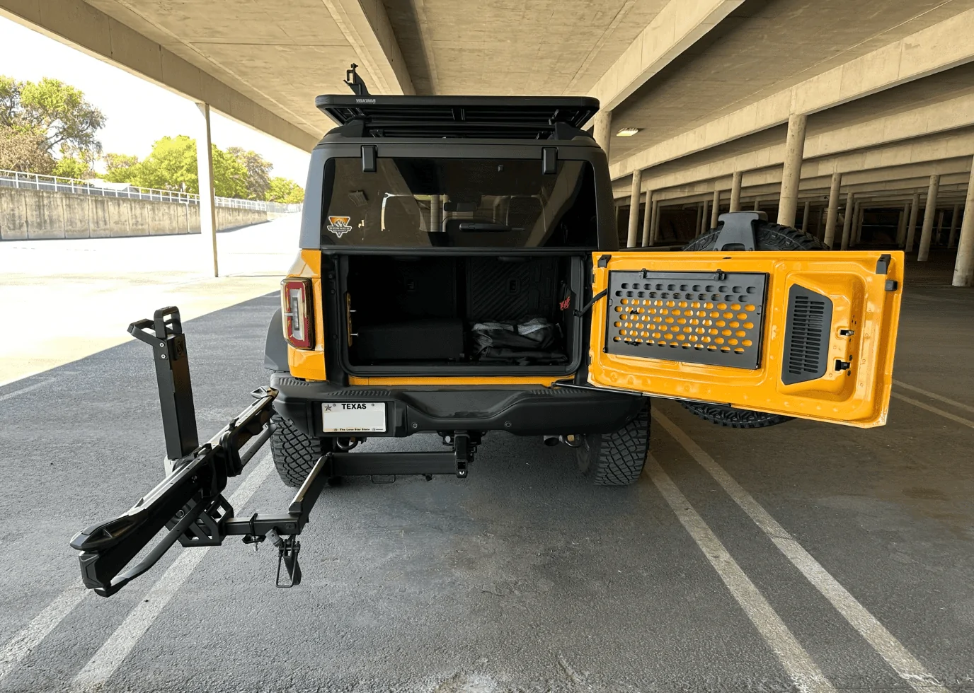

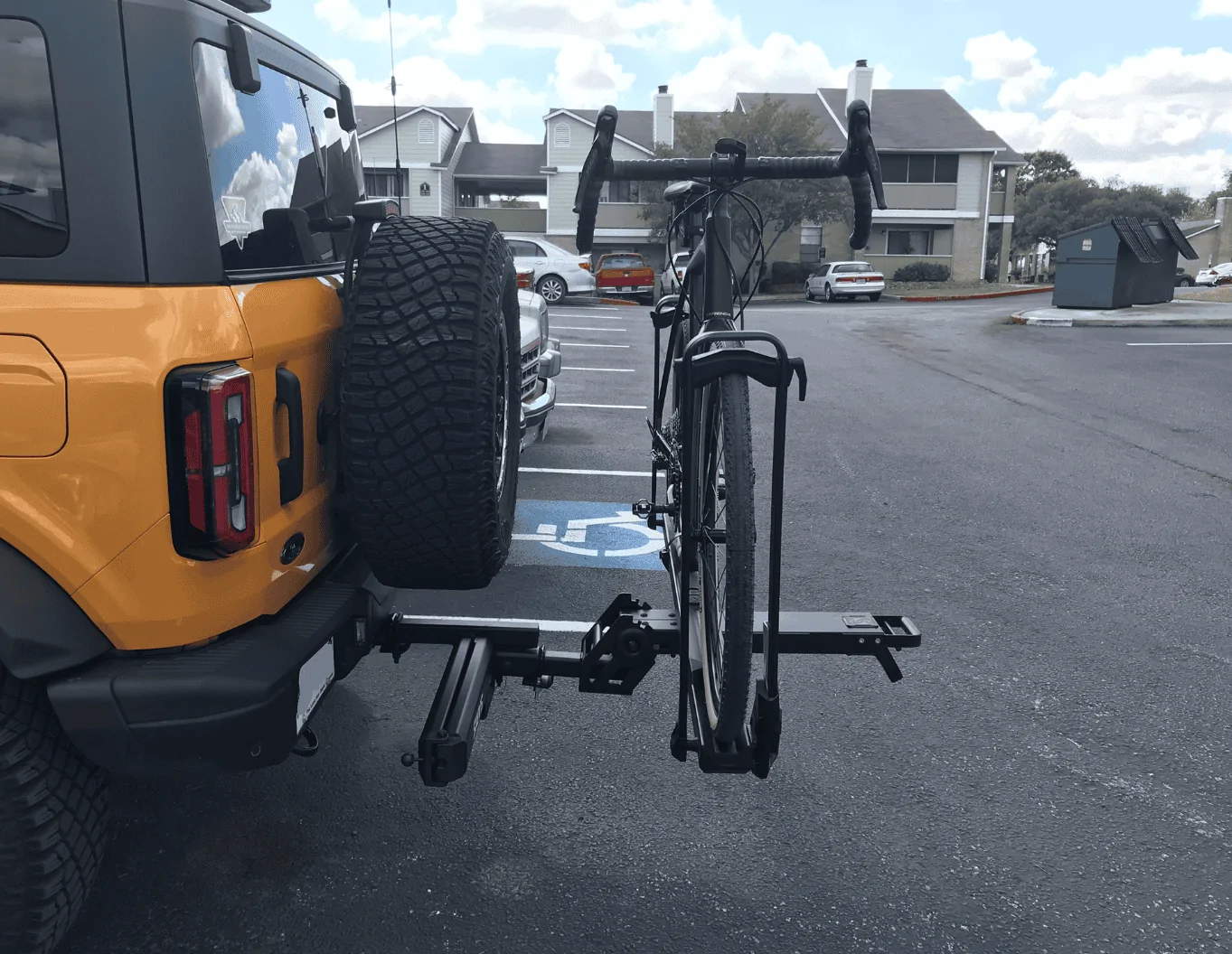

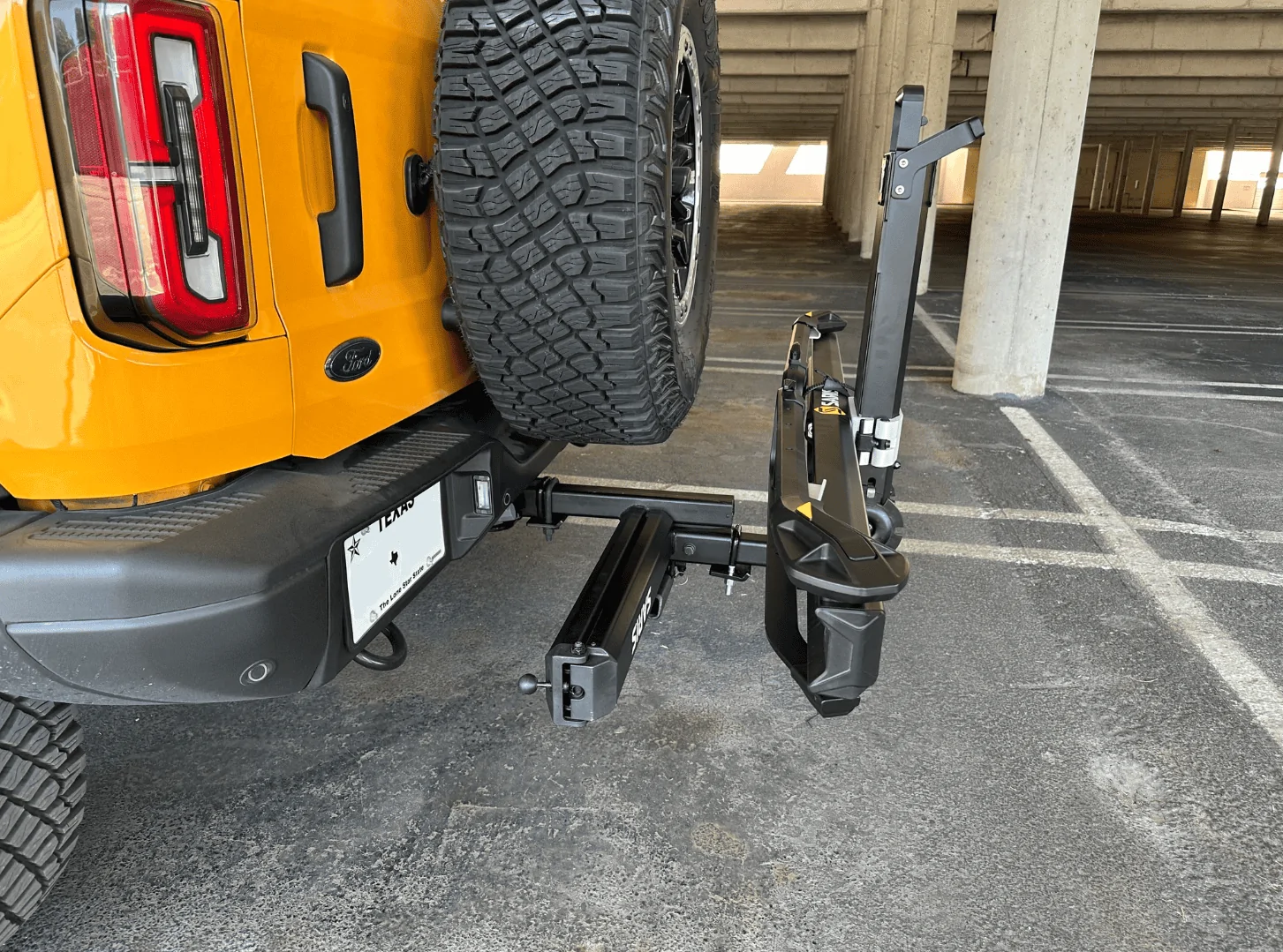

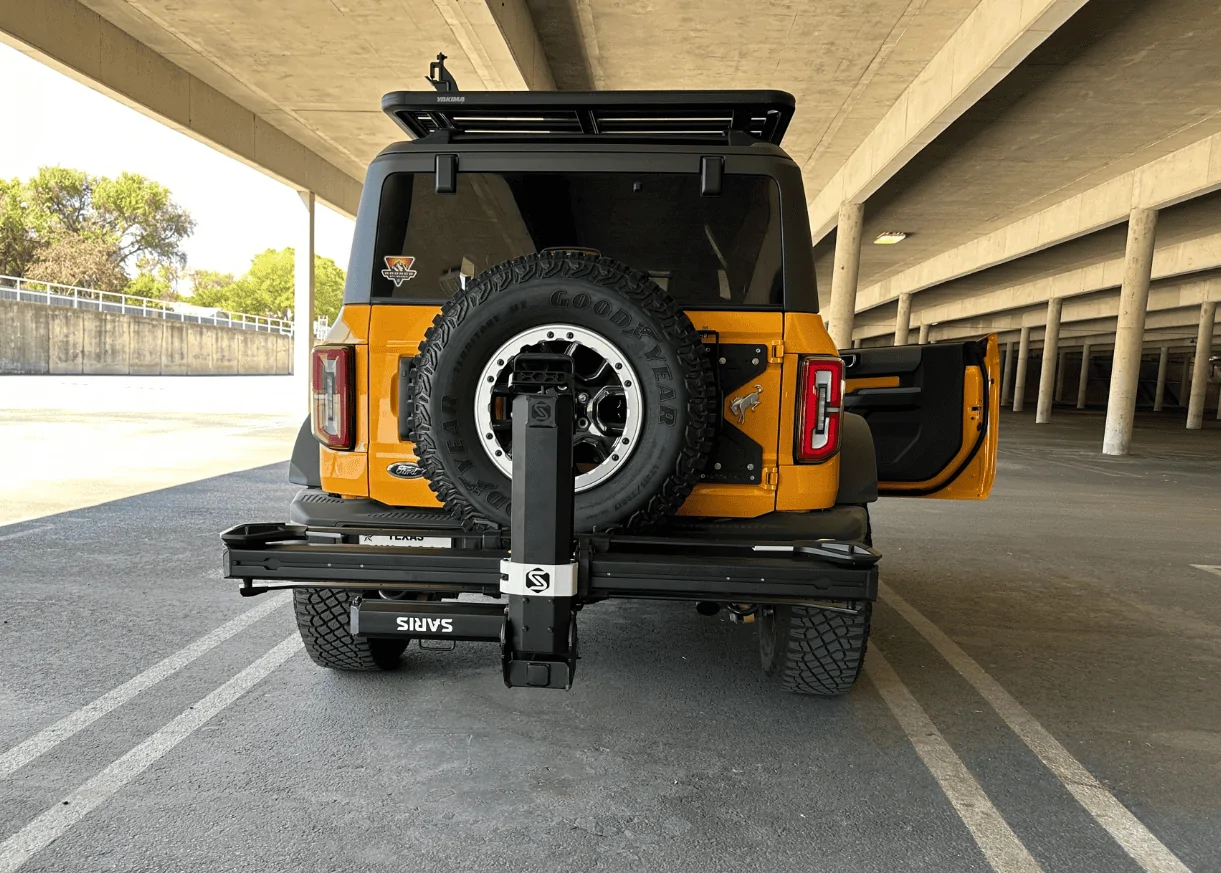

This is a Saris MHS 2 bike base with one tray and using the Saris Swing Away.
The swing away is mounted upside down. This lets it open to the driver side and not interfere with the tailgate.
Can I open the door? Yup.

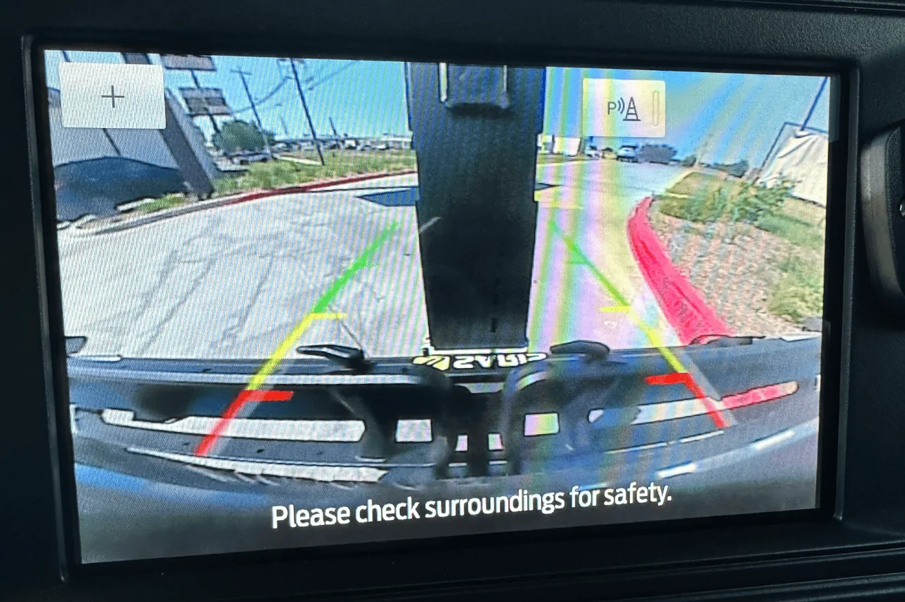

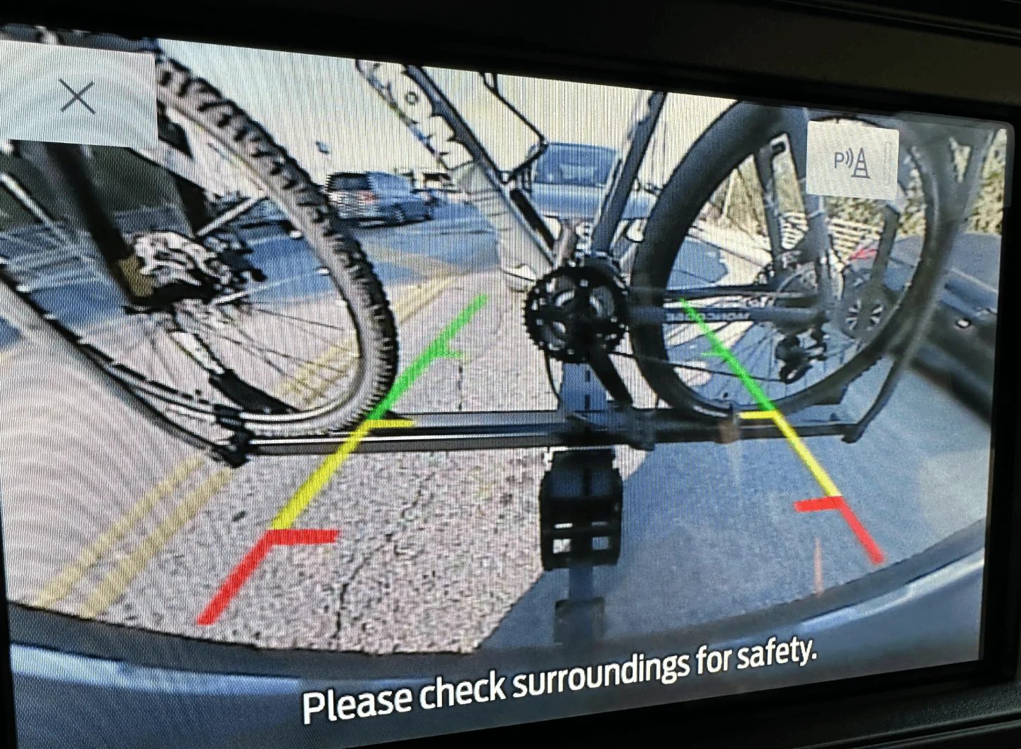

Can I see out the rear with it folded up? ... Sorta.
It does block the very center of the screen, and makes the backup sensors beep. But it's wide enough you can still see a good amount, but not directly behind you.
Also, even if you turn off the backup sensor in the settings screen on the radio, it seems to not work after you turn the vehicle off and back on. The option still shows them disabled, but they do indeed still beep at you. You have to turn it off every time you go in to reverse the first time after start up.
Ford Bronco Bike rack that doesn't block rear camera while folded 1667355612361
Ford Bronco Bike rack that doesn't block rear camera while folded 1667355627165
Ford Bronco Bike rack that doesn't block rear camera while folded 1667355679673
Ford Bronco Bike rack that doesn't block rear camera while folded 1667356016635
Ford Bronco Bike rack that doesn't block rear camera while folded 1667355867630
Ford Bronco Bike rack that doesn't block rear camera while folded 1667356036416
It's pricey, but I was able to get them all with a 50% off coupon (that's since expired).
One of the big issues is that the hitch isn't that far down from the spare, so you'll probably need a drop receiver of some type.
