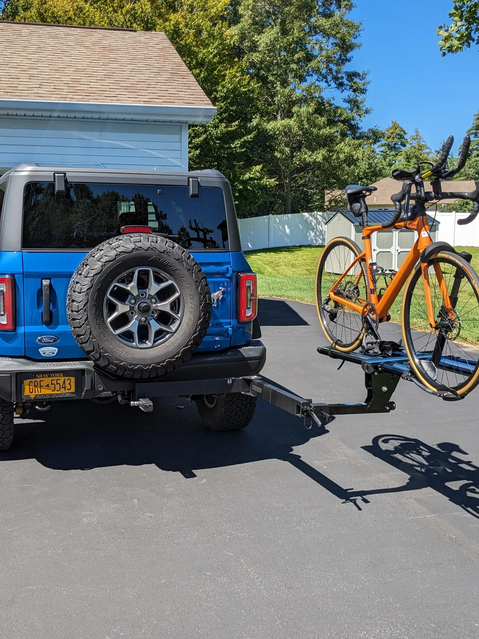

Just buy an extension for your tow hitch if you have one. If not I would invest in one. I don't load anything else on my tailgate already. I know the hitch bike racks are expensive but I feel its more secure and less weight on my rear door. This is an older pix because I got rid of that crappy bike rack and bought a Yakima bike rack.

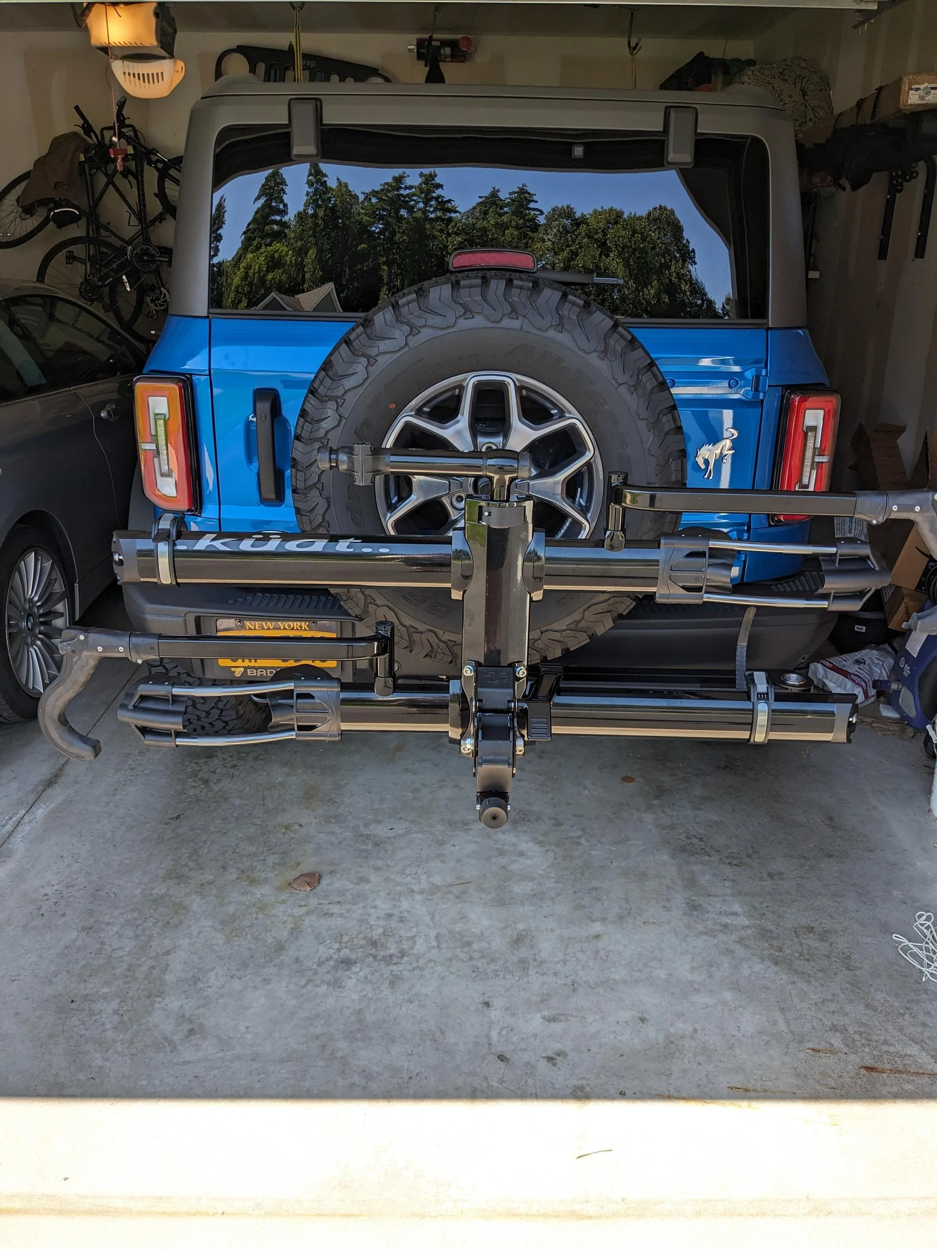

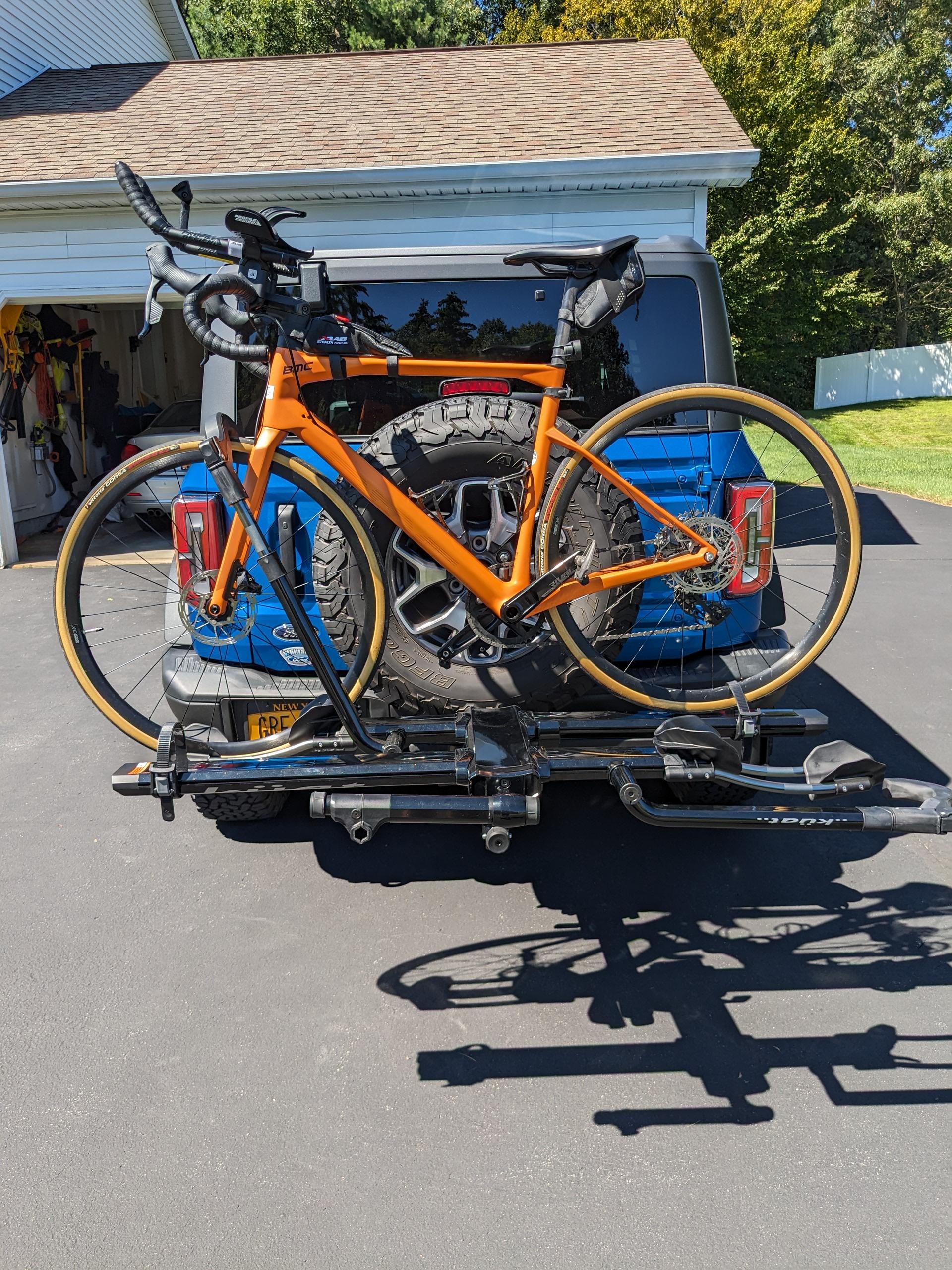

Don't understand the question. Do you have 37's or a "Base" tire? Reinforced or not? The Kuat Pivot with a Kuat or similar rack is preferred bike mount. There are many threads on this including mine. If you choose one of the tailgate reinforcement systems, you have to check their specs for weight. I use the Hammerbuilt to carry extra gas, so one tire mounted bike could be equivalent . . . Upgraded hinges add even more capavity.
Can confirm the Kuat with the pivot is expensive but amazing. Plus I had to install the receiver. Worth it.

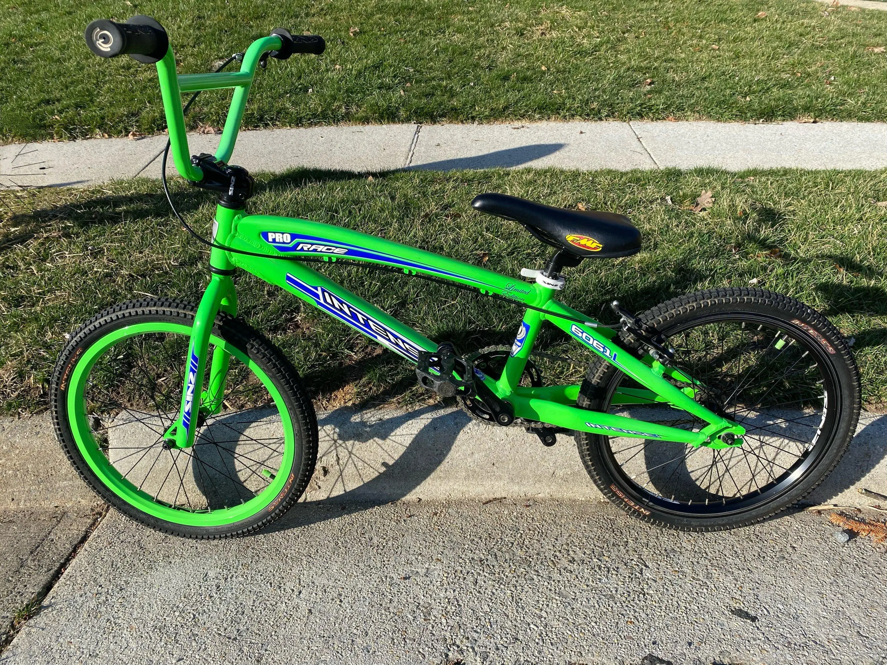

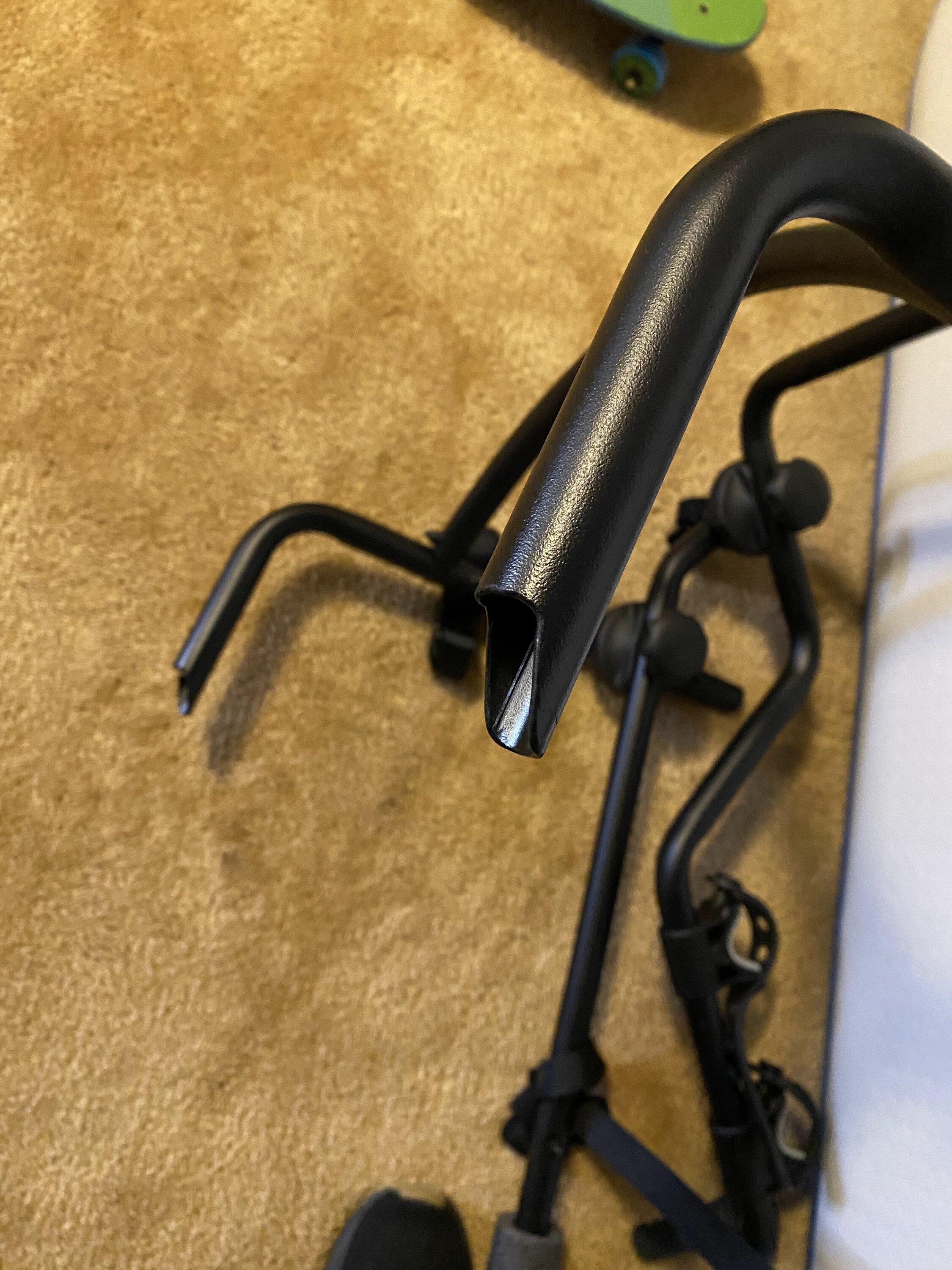

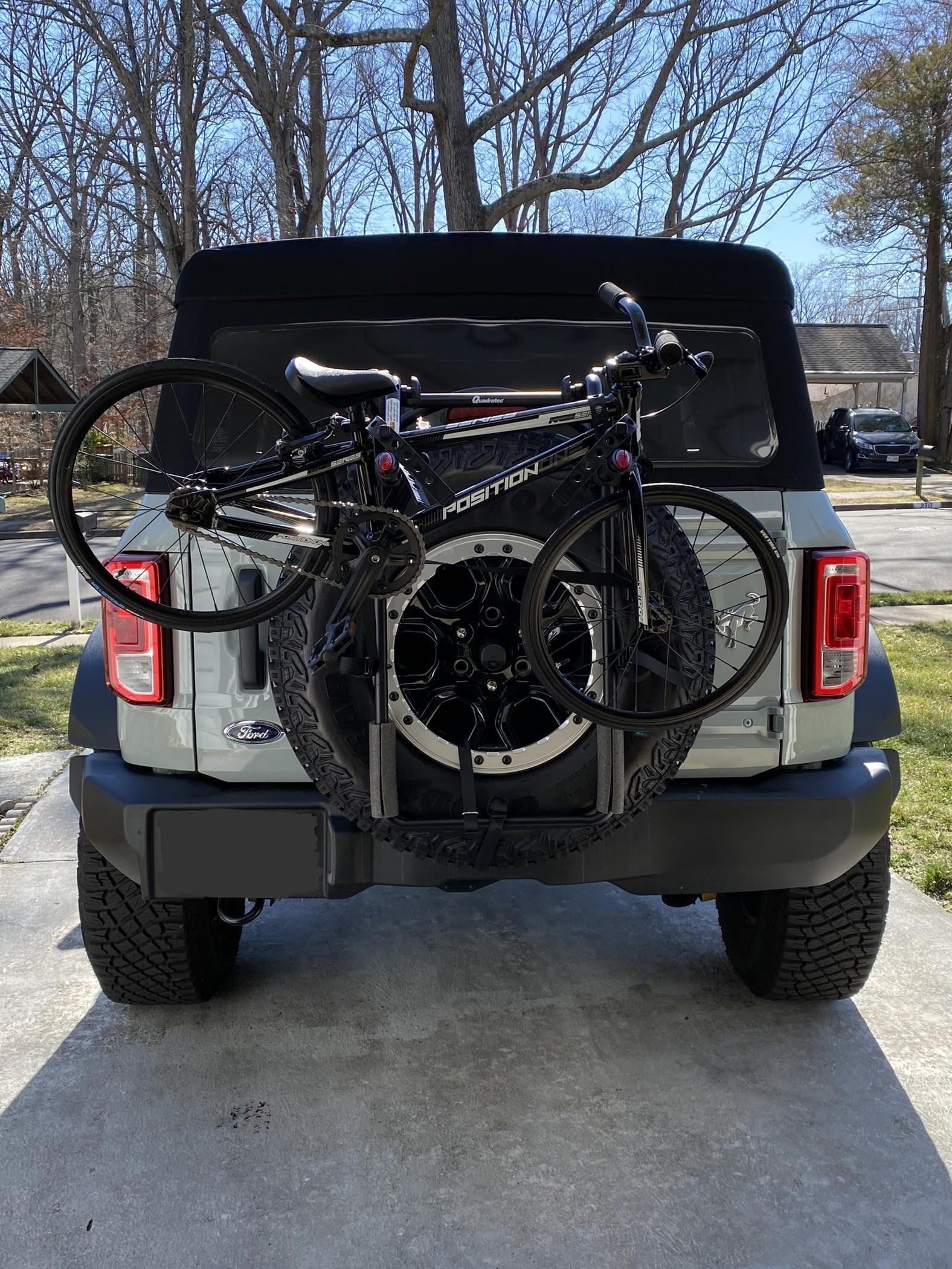

I purchased a Quadratec spare tire bike carrier. It was designed for a jeep so I had to modify the arms that hook on the back. The Bronco spare sits much closer to the tailgate compared to the jeep so I cut them down and put a slash cut for a little extra space. it hooks on the spare and one strap goes around on the tread and another through the wheel at the bottom. it's very secure and the rack is very light. My son and I both have Racing BMX bikes, so I throw both on and I have had no problems. we have been on 6 hour road trips with zero issues. like others said, I wouldn't be comfortable going off road with it but running around town its fine. sorry the only pic I have is with my kids micro mini on there, I'll try to take another pic from the side tomorrow.

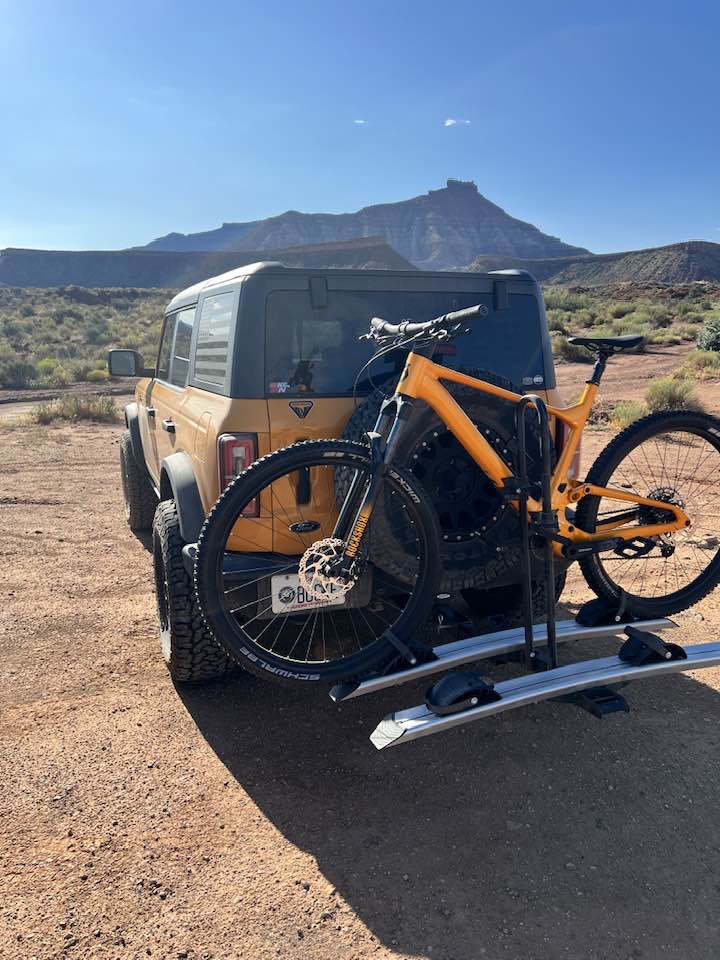

The absolute top of the line are 1up
https://1up-usa.com/product-category/bike-racks/
Obscenely expensive but built like a rock. Good to take off-road on trails. The track swings away from the tailgate with a locking mechanism.
I use mine with a Kuat HiLo hitch extension
https://a.co/d/elM78Nj
It folds up very compact and snugs up right against the spare.
Kuat makes a similar rack that is similarly priced but I don't like it's looks. I personally don't like swing-away racks. Sure, they give you fully open access to the tailgate but the one I owned a few years ago took a minute to extend due to multiple safety pins and screws, which is an incredible hassle when you leave the rack on for the entire summer and have to deal with it several times a day.
