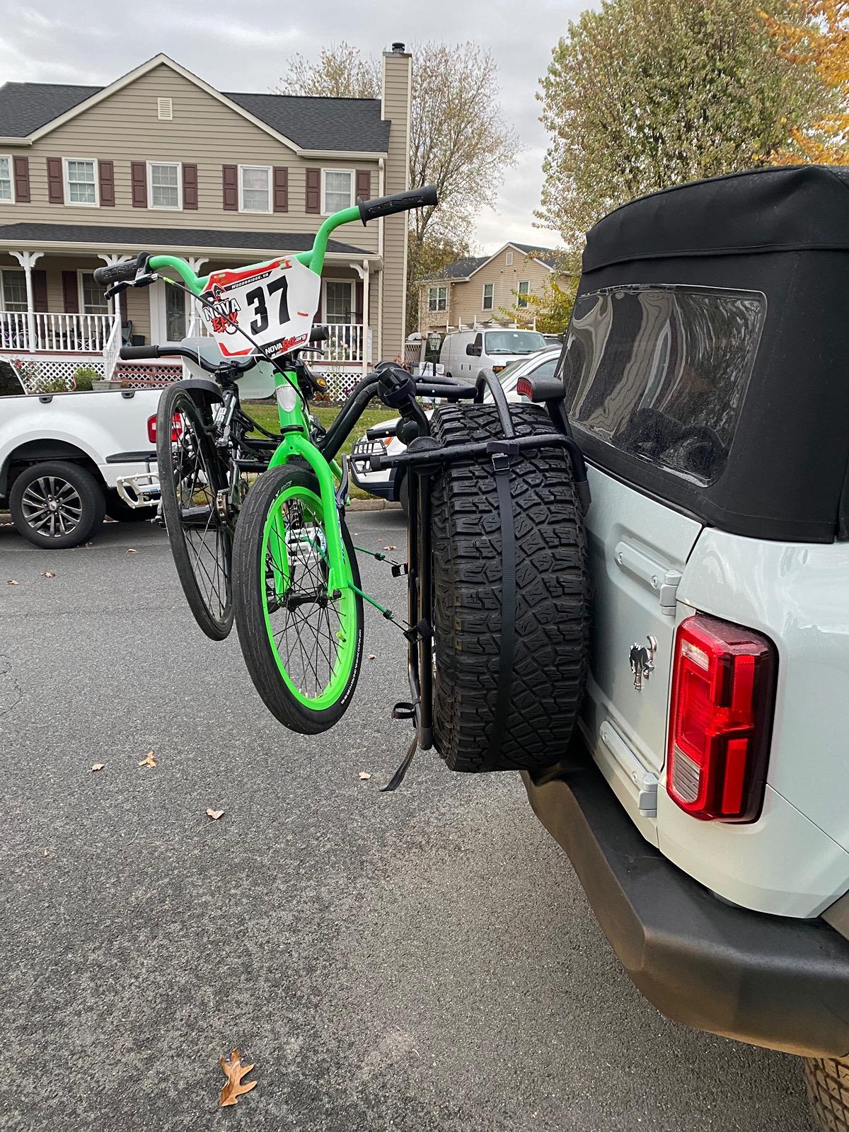

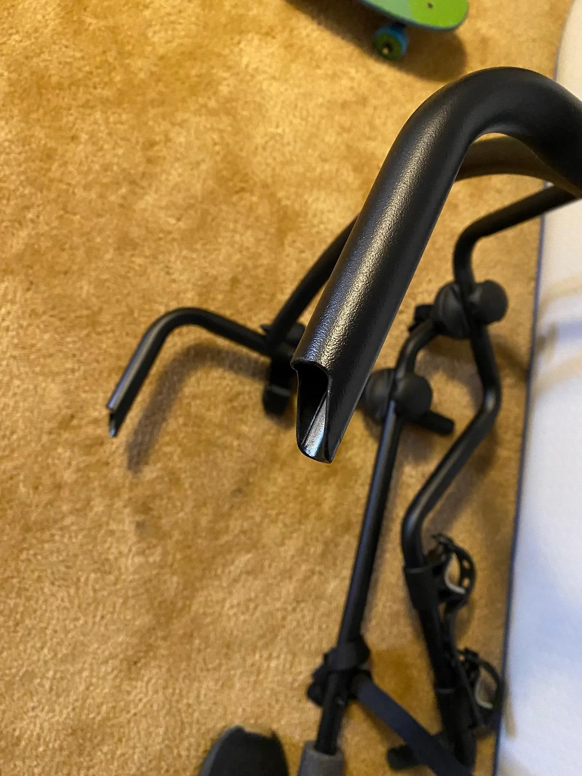

Picked this up on sale. No issues for 2 racing BMX bikes. the local track is only a mile down the road. It was listed for a jeep but I had to modify it to work. The arms that hook over the spare were to long and would hit the tailgate. The spare on the bronco sits much closer to the tailgate compared to a jeep.

Picked this up on sale. No issues for 2 racing BMX bikes. the local track is only a mile down the road. It was listed for a jeep but I had to modify it to work. The arms that hook over the spare were to long and would hit the tailgate. The spare on the bronco sits much closer to the tailgate compared to a jeep. Only pic I have but I’ll take a better one the next time I load the bikes
Ford Bronco Bike Rack that clears without an extension? IMG_5212_Original
What model and what mods did you have to do to get it to work ?

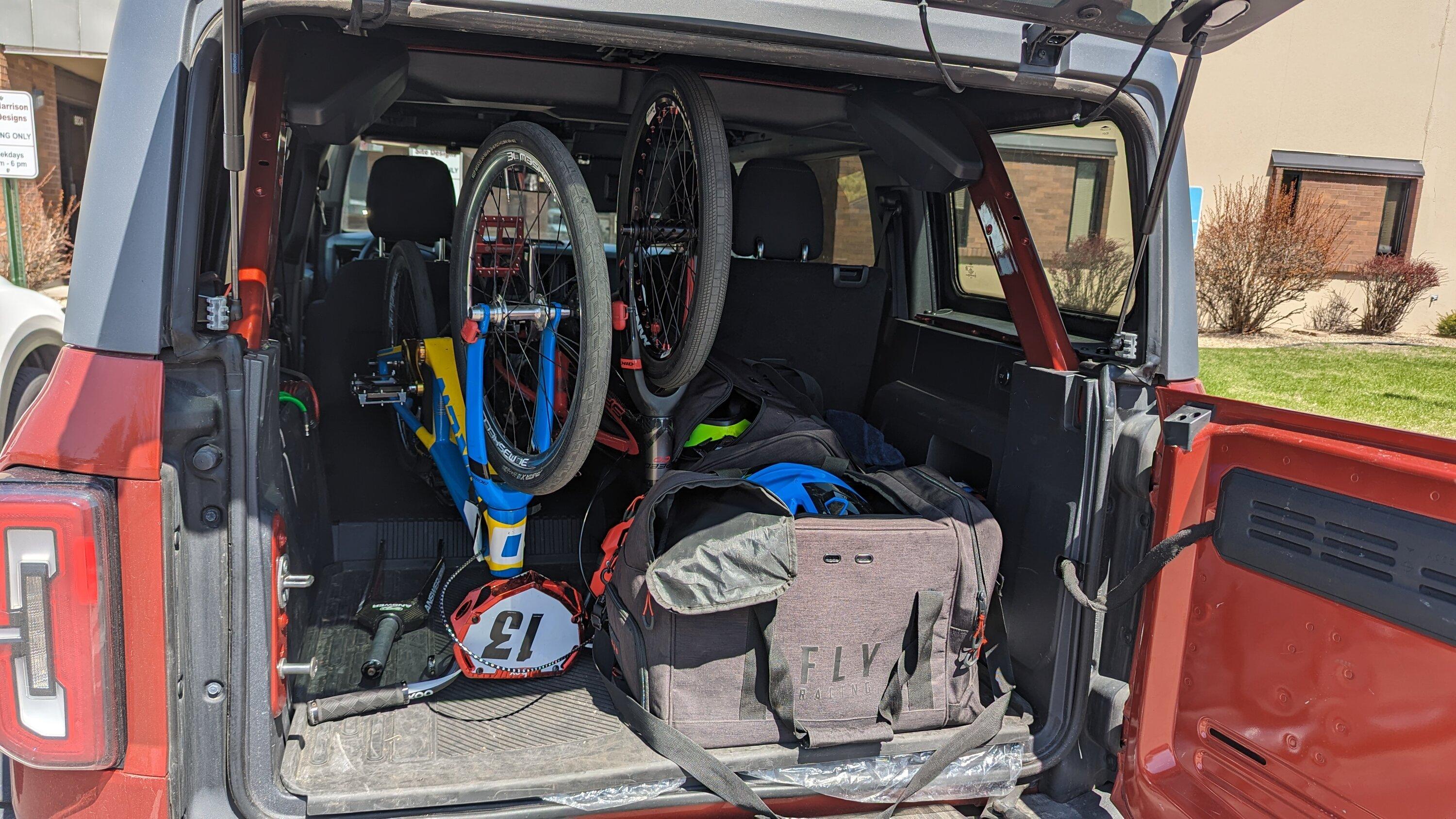

Looks great, for BMX bikes I found that I can fit 3 in the back of my 4 door with the 60 portion of the seat down. No need to take off the tires unless you have a pro size cruiser. When we went to Tulsa for Grands last year I was able to fit the wife's cruiser, my Pro XXL and my kids junior bike plus all the gear and luggage for the trip in the back. It was kind of like playing Tetris but we made it work.
