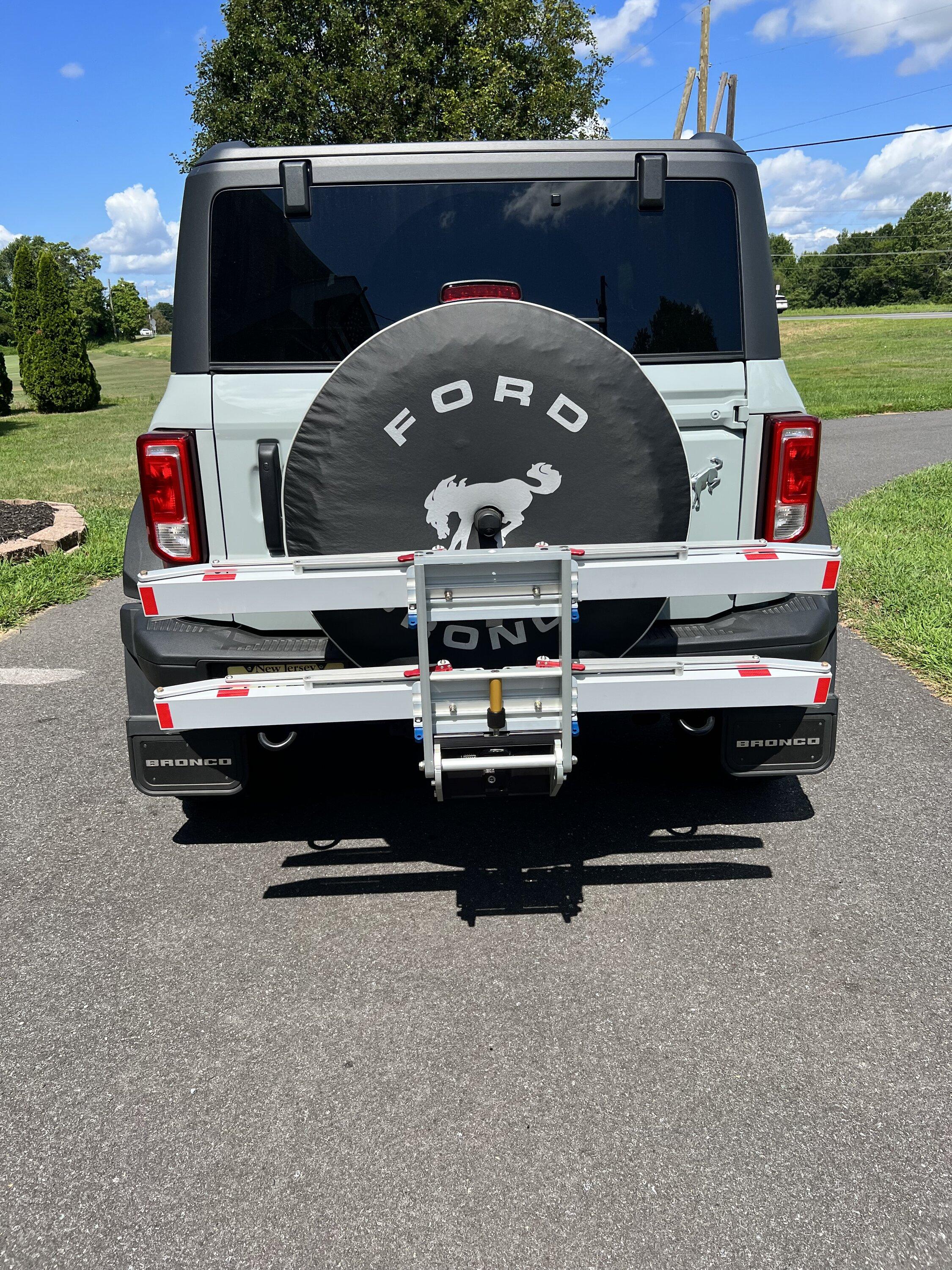

I got the 1 up superduty bike rack that holds 2 bikes with the extension to clear and there’s been no issues
Ford Bronco Bike Rack that clears without an extension? 9F7AC337-A605-4035-923D-4B535AE86AD9
So you do or do not need an extension?
I did bye the extension to clear the Sasquatch spare tire works perfect and it’s not bending or putting any stress on the hitch
