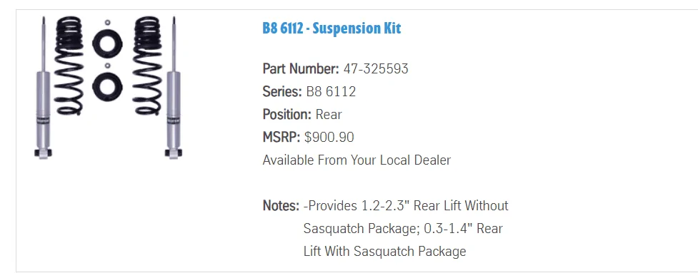

Why do you say Bilstein doesnt make a spring for the rear?
Ford Bronco BILSTEIN 6112's on a Non SAS 2 Door, Very Confused 1699030605735
GroovyGeek
Boyan
Apr 18, 2023
88
1,430
1,697
'23 Bronco BD
Yeah, it does not seem that Bilstein makes 2D specific 6112. That is a crazy amount of lift if you are not doing 37" tires and then you would need UCAs, trac bar relo, rack and pinion reinforcement.
