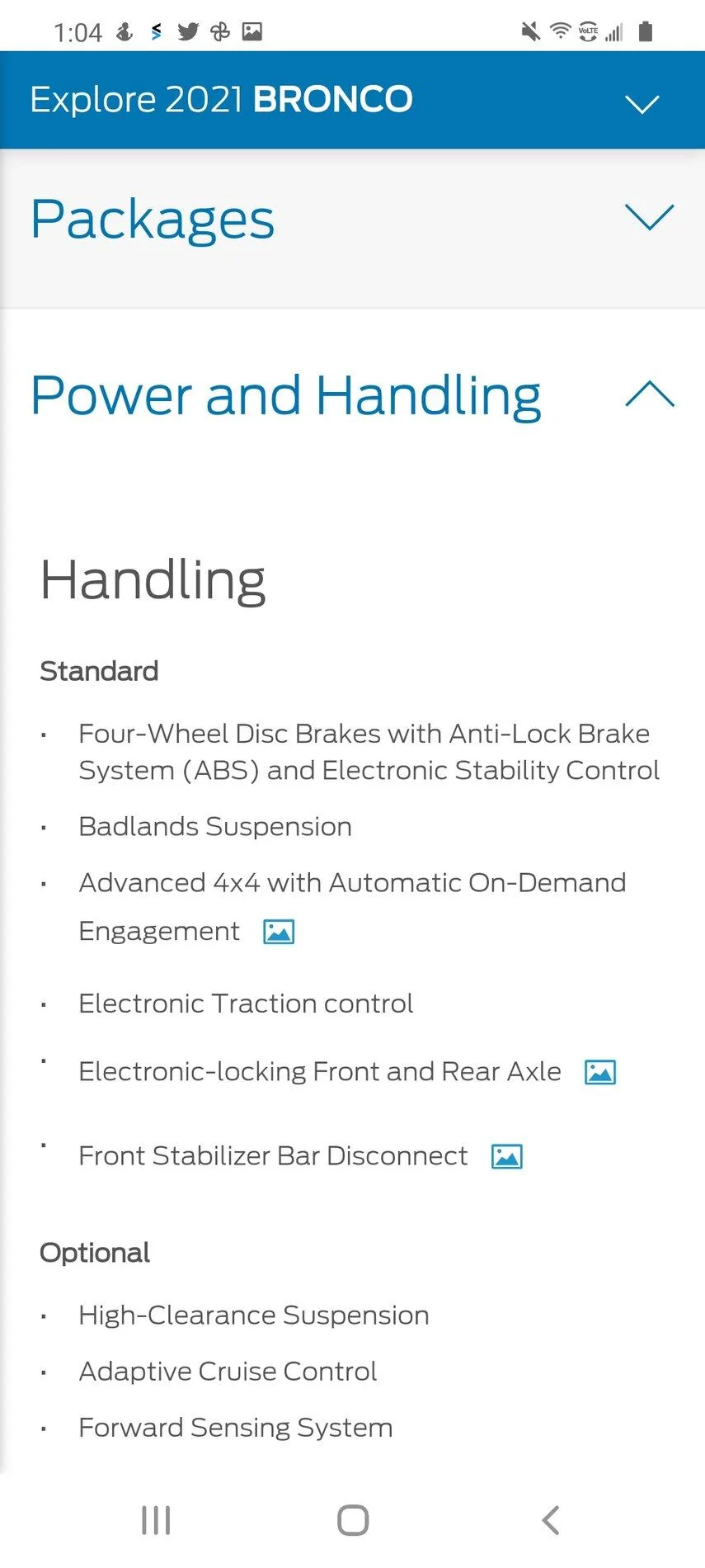

But it's listed as a separate item to the disconnect...that always made me think it was different shocks and/or springs to the others
Yep its the swaybar disconnect and the Bilstein dampers. The Bilstein are standard on the Badlands, and you get them without having to get the Sas package. Thats the only trim like that. I wouldn't think they would have 3 different springs right? Just Sasquatch and non Sasquatch.
This is why Im thinking the Black D springs must be the same as the Badlands springs, and if 285/70/17s can fit on the BL, Id think they can fit on the BD.

Yeah but Im thinking/hoping the "Badlands suspension" really just means the swaybar disconnect. The "High Clearance" is still listed as option on the Badlands.
Nope they list the disconnect as a separate option at the bottom of the list.

I see what you're saying, but they are both listed as standard, so "Badlands Suspension" includes the sway bar disconnect. The suspension on the Badlands also includes as standard the Bilstein dampers, which no other trim level does, without the Sasquatch package. My question is, is there anything else different about the Badlands suspension, besides swaybar disconnect and Bilstein dampers, that would give it more room to fit tires?
Don't really know for sure but being that there's multiple differences it may be different enough that they can fit 33s. The Bilsteins may even make a difference by themselves.
I definitely wish there was a way to find out for sure. Because that makes differences in deciding factors of what packages to get and what not to get.
I just have that feeling there is a difference.
