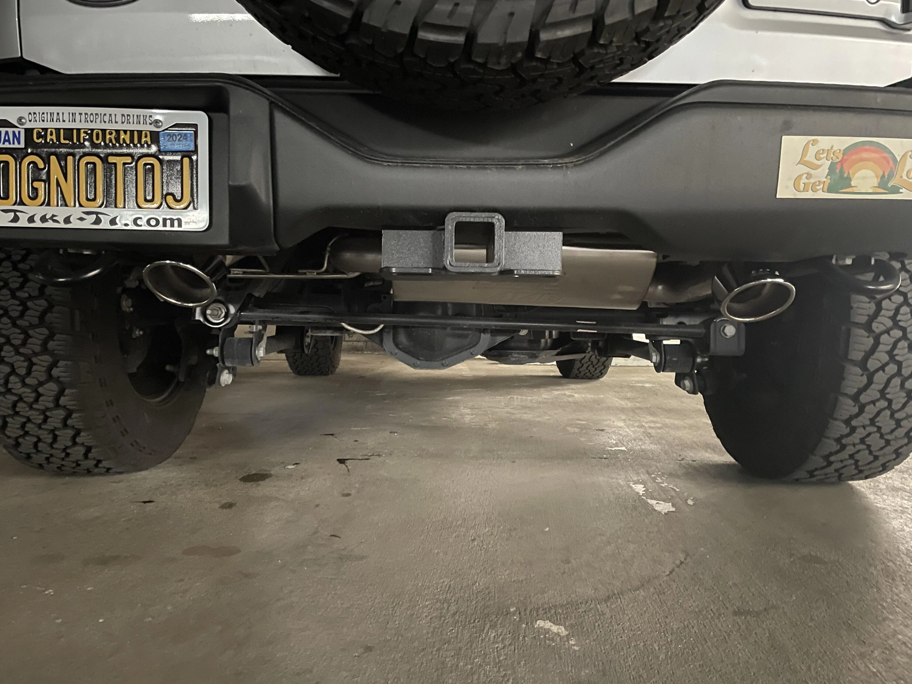

Just installed the borla exhaust replacing the outlaw straight pipe.
really really happy with the sound and look.
any suggestions on aligning the outputs since the are off a little bit.

Love the Borla exhaust, I went with the S-Type on my 2.7 and it sounds amazing. I had the same problem as you where the driver side sat up higher, tried multiple different things to align and finally ending by this, https://a.co/d/9oRqYnr, and it worked perfectly. Installed it on driver side.

That’s very helpful ty.

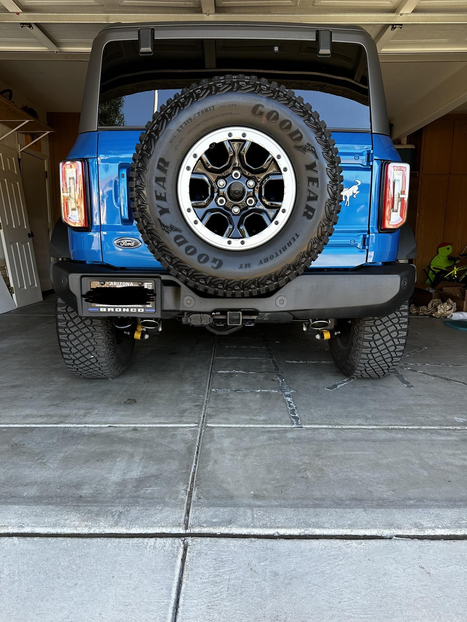

2022 Ford Bronco

I have the S-Type for my 2.7L and love it. I also had the same problem with the tips not being even and ultimately was able to finagle it enough to get mine level. Try loosening the bolt where the Borla system meets the factory pipe, grab the whole Borla system and twist it to get them even. Then tighten the bolt back down. This worked for me, but both of my rubber hangers are at an angle, but not causing any issue and zero wobble.
