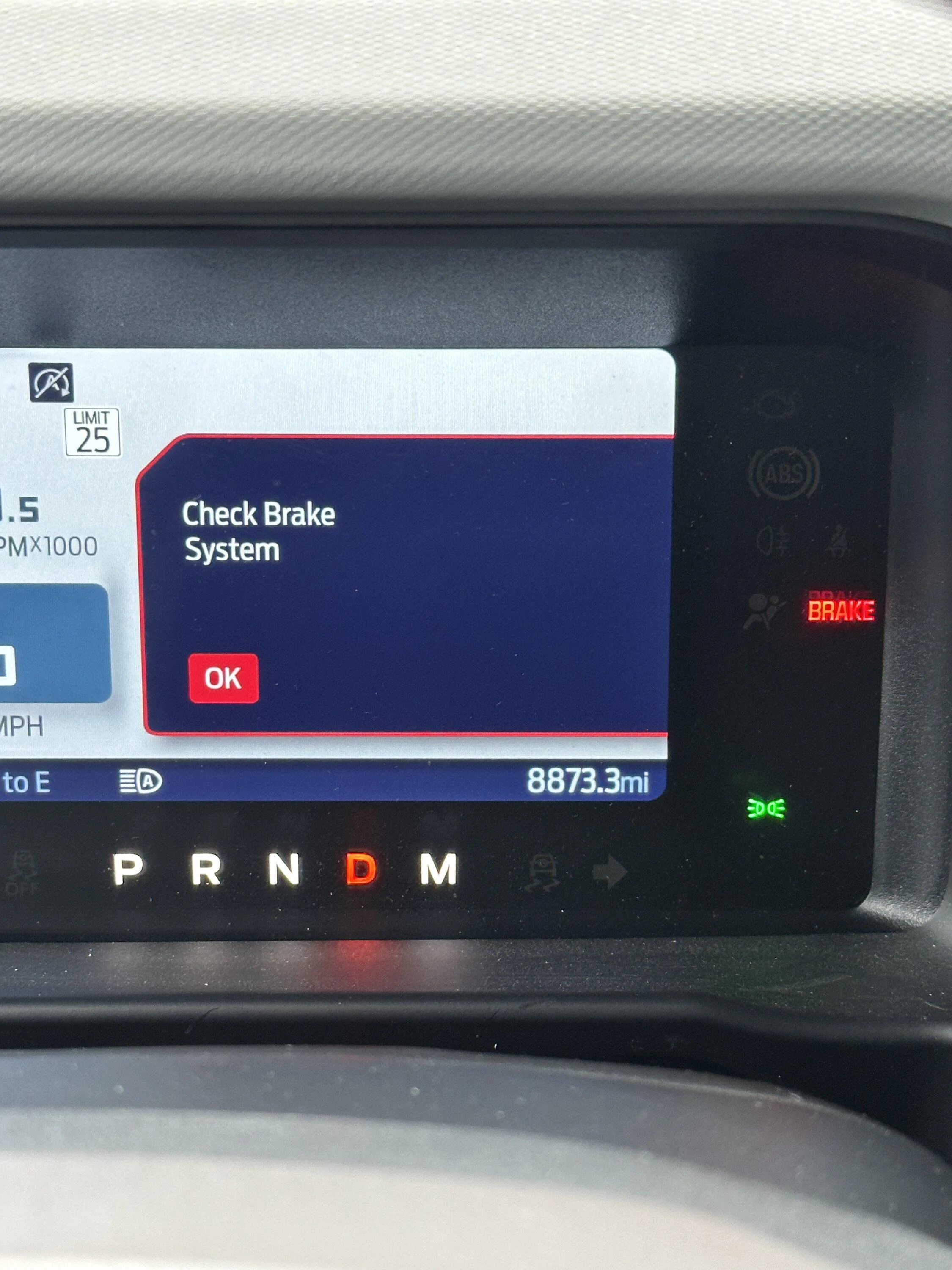

Hi there! Would you send us a private message with your VIN and dealership name and location? I’d like to look into this concern on my end.
Just had my check brake system warning pop back up today while the Bronco was idling. I had this happen last December. Weird it took so long to reoccur.

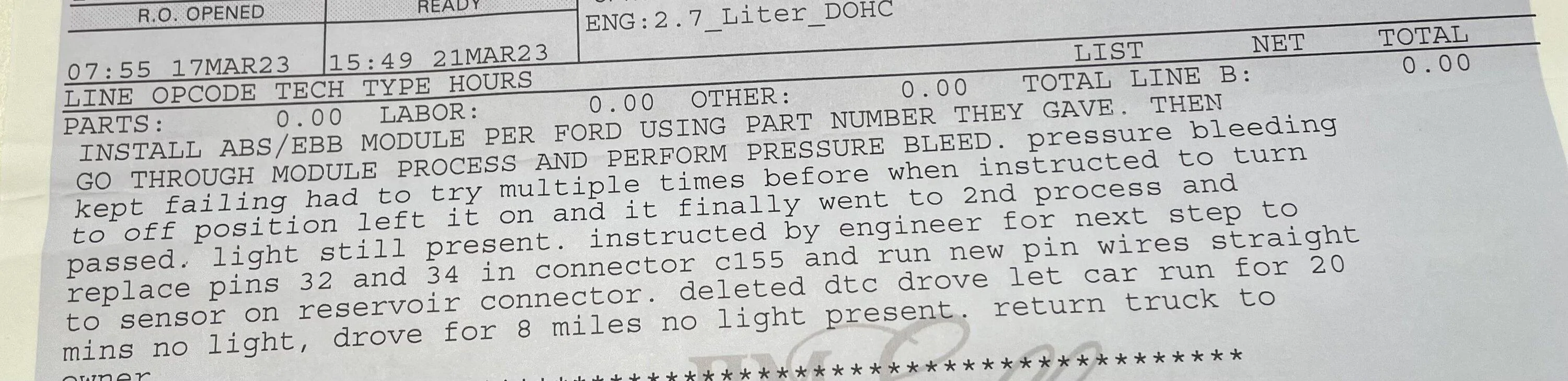

JLEE8008
Jeremy
Mar 29, 2022
Sandy Springs
Here is the notes from the repair I had done in March with Ford and the local dealership, so far the Check Brake System light has not come back on. Hopefully this is the fix for the rest of y'all as well!

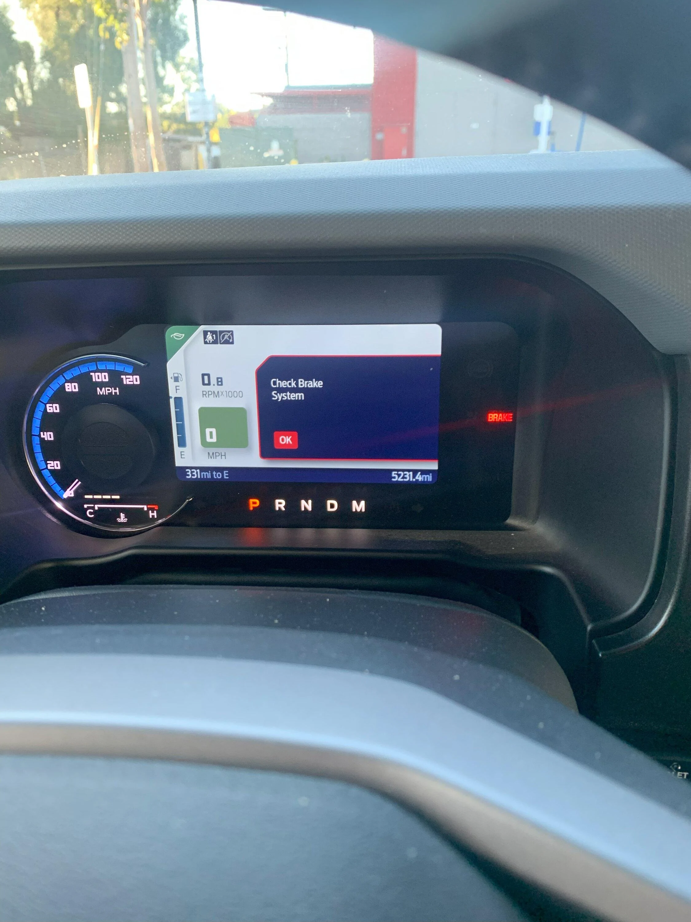

dphan
David Phan
Apr 21, 2023
Ontario California
Bronco Big Bend
Hey guys. I'm having the same issue. The light came on and I couldn't start my car the first time since I couldn't depress the brakes, but then it went away. The second time I was driving down a mountain and the dam light came on. Scary as fudge, since I had my whole family in the car. I took my car to Sunrise Ford and they swapped a sensor and reset the code. Drove it to school and light came on again on the freeway. I pulled over again. I drove it back to the dealer only an hour after leaving. @Ford Motor Company this is scary. My wife and my kids were in the car with me. Also, the dealers did a stupid sensor swap, that didn't fix the issue. My car has been at the dealer for about 2 weeks now. What's going on?
