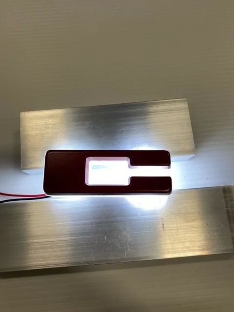

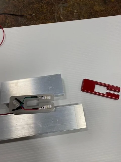

Being Sunday, the day of rest, I thought I should give you a teaser of my Grille lights while your resting on the lazy boy watching Football......... :D
So, I have it done, just not mounted. here is a snip it for now.........

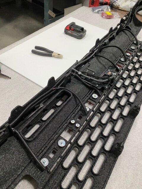

Grille done, just have to mount it..... it will work with the DRL's.
First couple of the back.... all wiring sealed from moisture, soldered, heat shrunk, and waterproof tape. No mold or mildew is getting inside these !! (and still room for air to circulate inside)

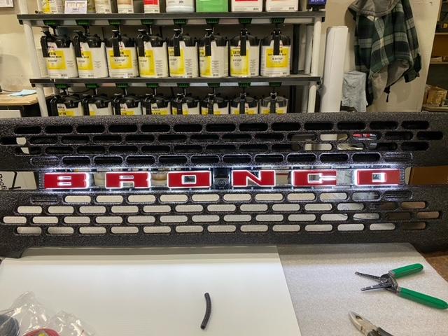

grille from the front.....
and with all the lights off in the building.... matches the DRL light almost perfectly !!

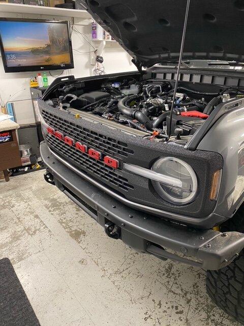

On the truck..... will finish wiring next day or so, but it is mounted, and the test shows, it works !!!!
Lights off...
Ford Bronco Bronco Grille lighting Teaser !!!!! image0 (9)
Lights on.....
Ford Bronco Bronco Grille lighting Teaser !!!!! image1 (6)

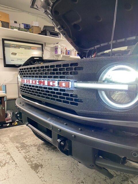

Some more pics at headlight level......
Ford Bronco Bronco Grille lighting Teaser !!!!! image0 (10)
Ford Bronco Bronco Grille lighting Teaser !!!!! image3 (3)
Ford Bronco Bronco Grille lighting Teaser !!!!! image2 (6)
Ford Bronco Bronco Grille lighting Teaser !!!!! image1 (7)

Nice!!! How did you mount them? Looks like you have screw caps on the pins. Did you make the letters with pins?
Rivet nuts.... a little waterproof adhesive while attaching them to the letters.
