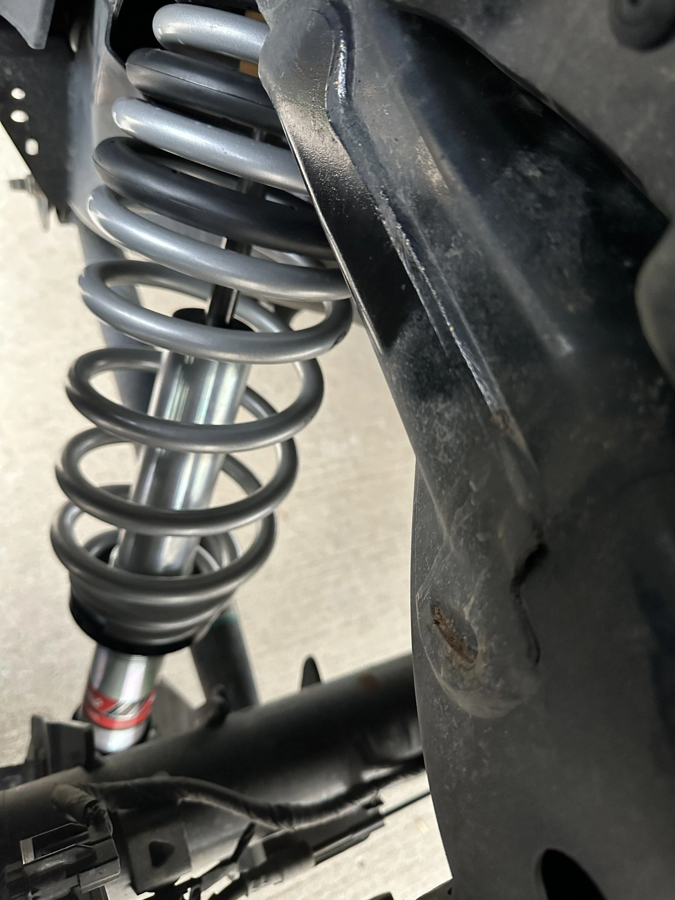

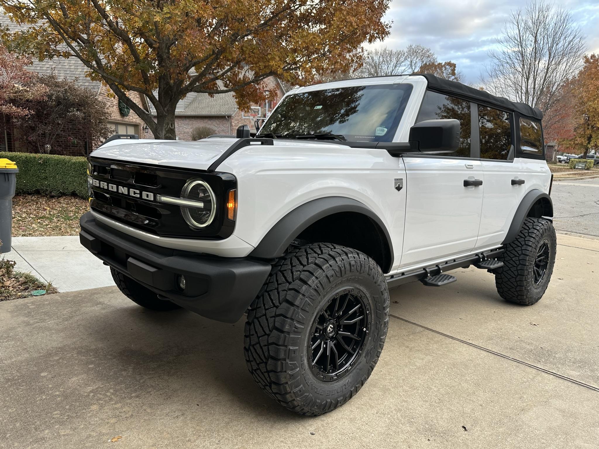

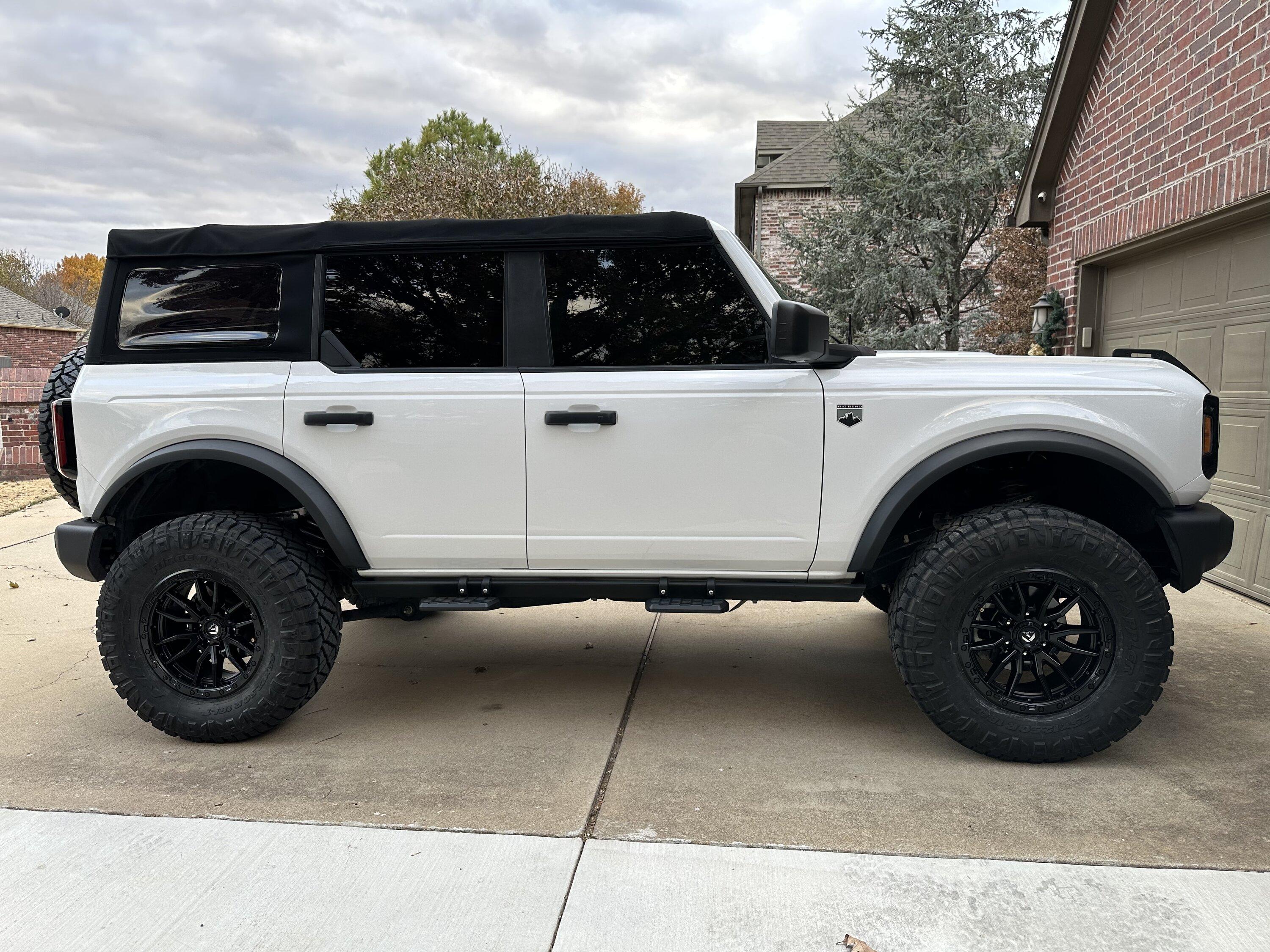

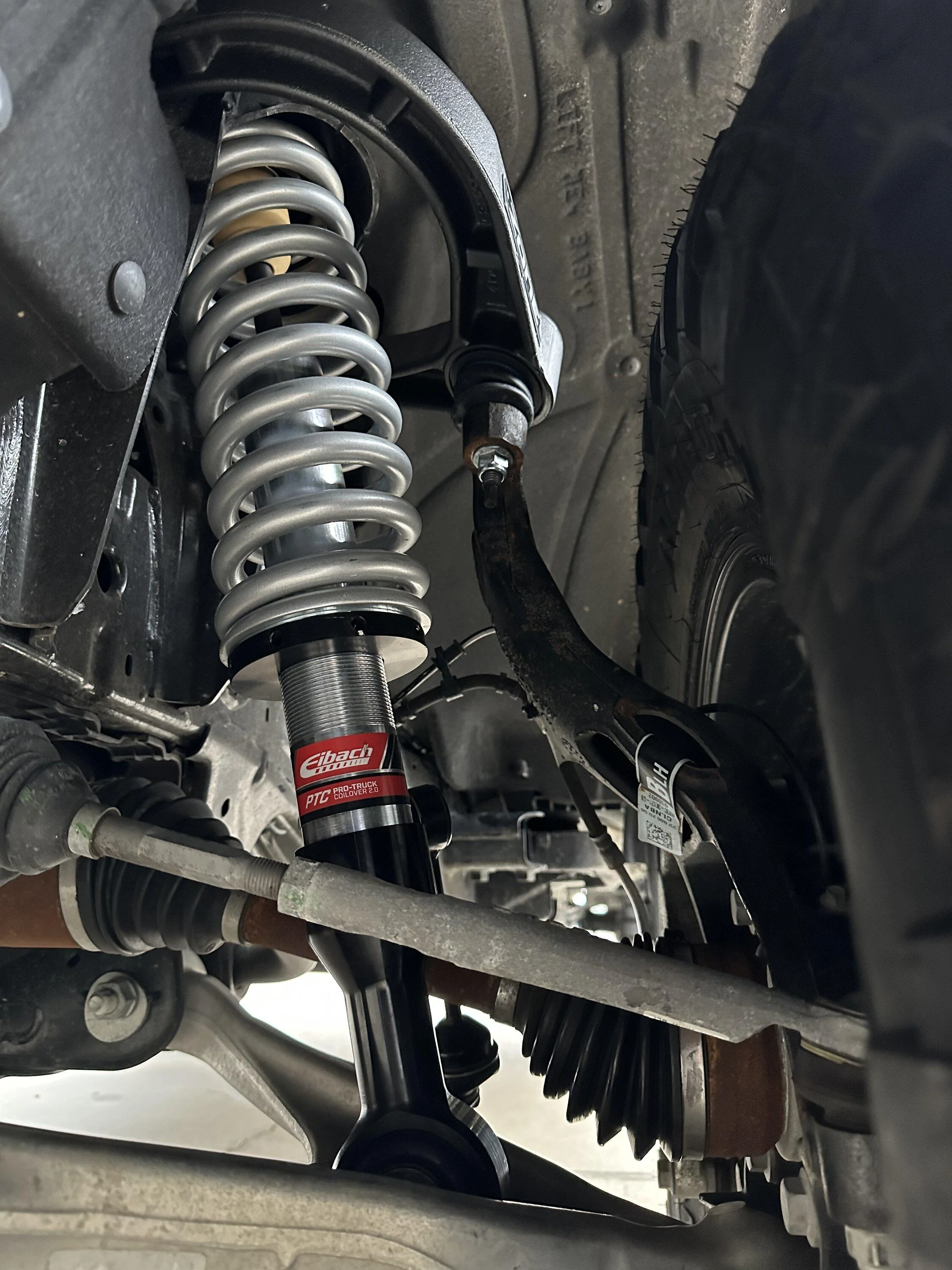

Eibach coil overs installed on my daughters Bronco. Rides better than my FE.

Trust me, I'd have loved to get your billet UCA's but got the Eibach coilover setup on a black Friday deal that I simply couldn't pass up. That said, now that hers is sitting 1.5'" higher than mine, I'm definitely going to be looking for an upgrade to my suspension setup with new coilovers, and quite possibly, your UCA's ;)
