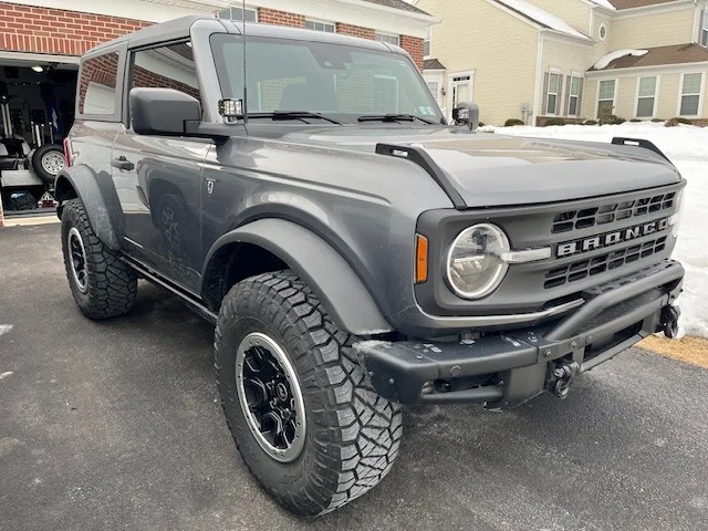

Got the the call today that the bronco was finished. While picking it up and paying the service manager grabbed me. She wanted to talk through the bill and answer any questions I might have. This went well as she explained the process with Ford more in depth.
On the way home the bronco felt good driving and was smooth through the gears. Some light smell after getting in the driveway at home (12 miles) but that's expected.
My understanding Ford paid $4500 for the transmission and labor. Not sure if that would be my price or it's their rate. As mentioned I had the the clutch replaced at $274, flywheel $478, bearing $8 and bolts $31. Add in labor and my bill with tax was $1047. Not excited about the extra spend but I'm good knowing everything is new.
Now I need to get with Ford and see about extending the powertrain since it's been an all around bad experience to date.
