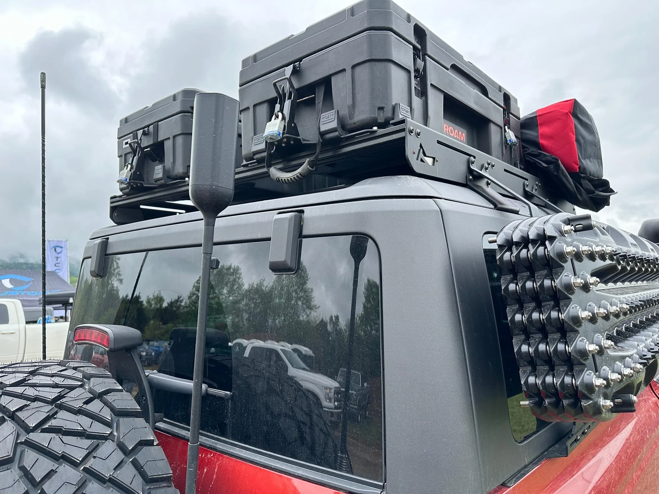

Trailrax half-rack with Roam 66 boxes

Nice setup!
Are you able to easily remove the rear roof section with the half rack installed?
Would you be able to add on and upgrade to the full rack from the half rack?

Nice setup!
Yes to both.

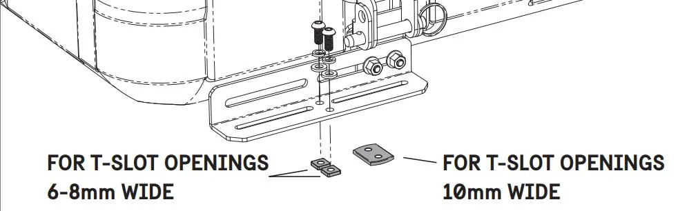

@TrailRax Do you have any issue with the mounting hardware (specifically the T-Slot nuts) that Pelican sells? The smaller size doesn't seem like it would have enough bite within the T-Slot rail. The large one is too big to fit in the slot. Was looking at mounting the BX140R in the next couple weeks for a trip.
The small ones work. If they are the same pieces that we have used from 1-2 year old mounting kits that they sell, which looks to be the case, it should work. We have some of these mounted on display racks in our show room.

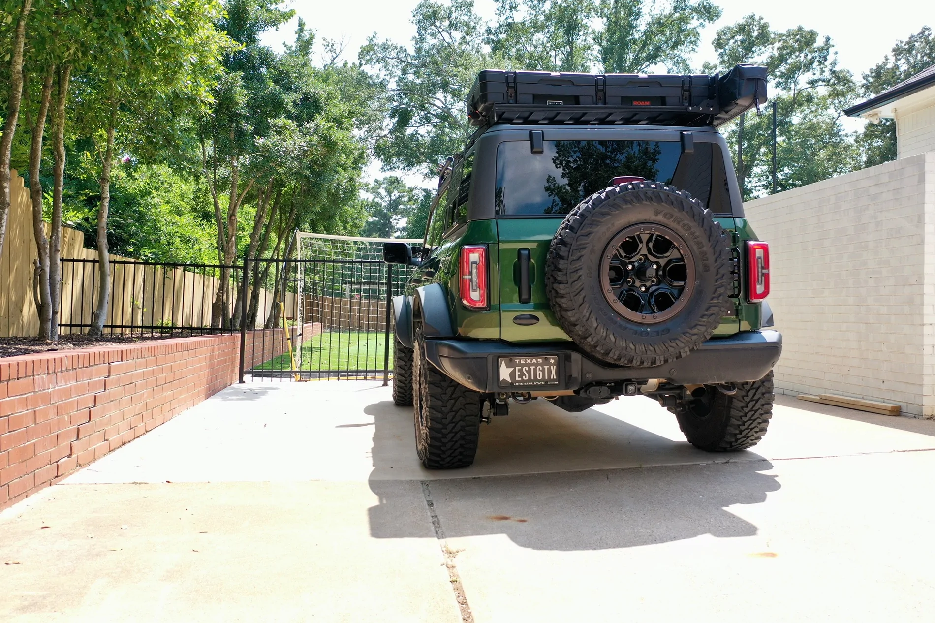

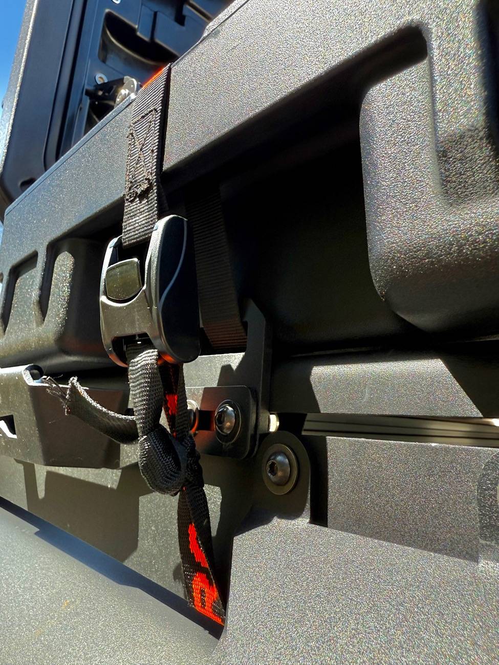

Roam 83 L with tie downs works as well.
the 83L is actually wider than 95L, why did you choose it instead?
Also how does it works out with the straps? Is it really secured without moving around while offroading?

it was really secure. Texas to Montana no issue.
Ford Bronco Cargo box for Trailrax half-rack? DJI_0009

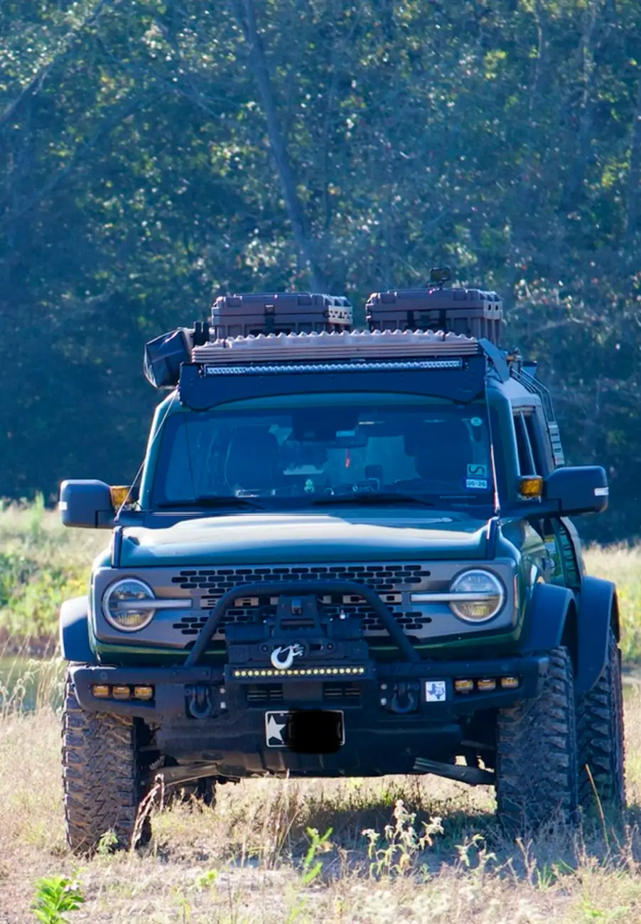

I’ve updated my setup to Roam brackets and 95l cases. Long ways work better on top.
