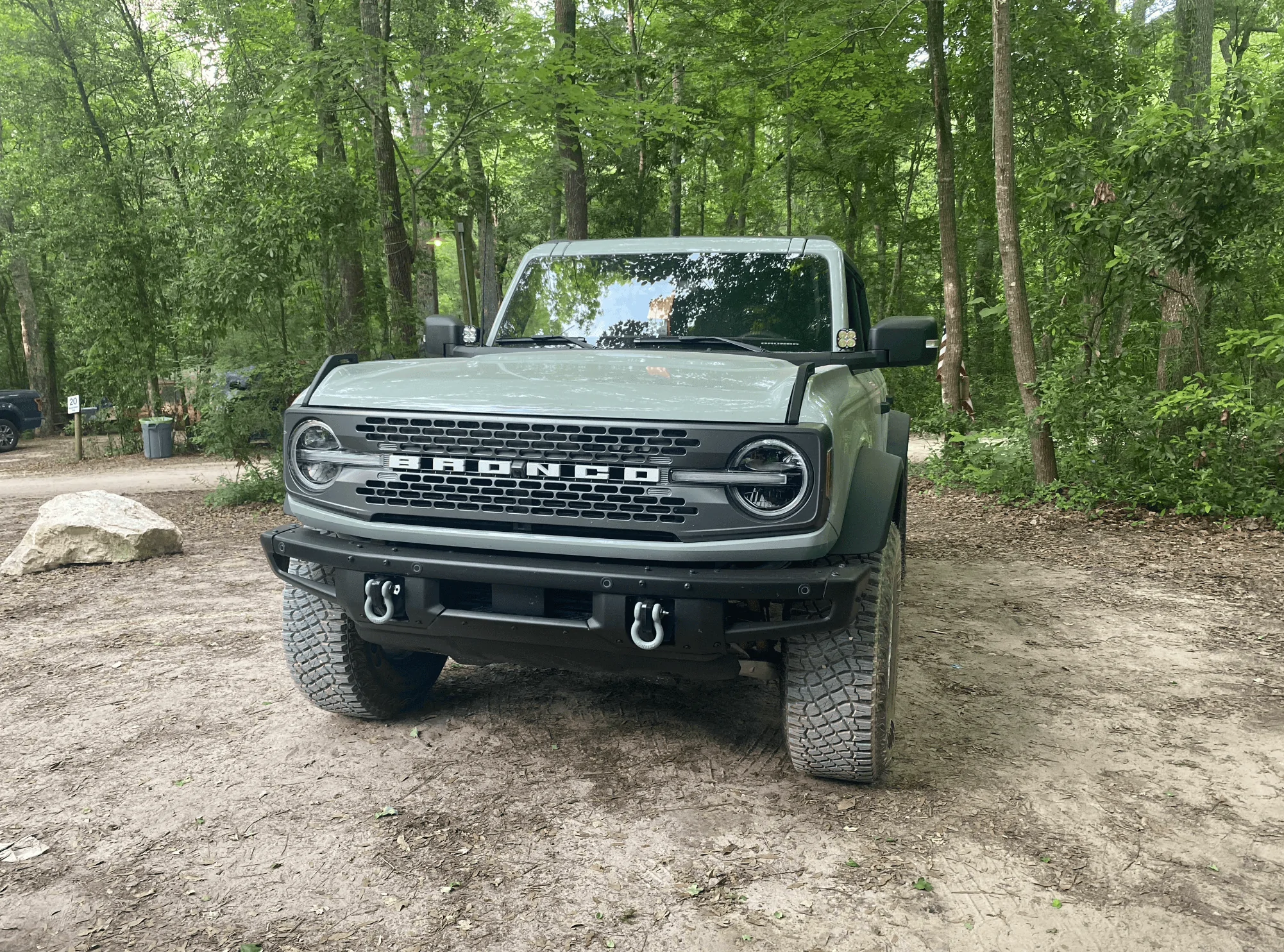

Just swapped to Bronco Modular bumper and need D Rings. Too many choices whats recommended ? Thx

Check out Yellow Autobots on Amazon that's what I have on my Cyber Orange.

So I see some shackles that say something like 3/4in shackle and 7/8in pin. Then some just say 7/8in. Any idea why the different dimensions?
The pin size is generally 1/8" larger than the bow (nominal size), on the shackles you'd be looking at. If it just says 7/8" it will take a 1" pin.

If you plan to use them off-road for recovery purposes and are set on metal then I would personally only use Crosby shackles.
I'd highly recommend synthetic soft shackles. We carry two Bubba Rope 3/8" NexGen PRO Gator-Jaw synthetic soft shackles and two Crosby 3/4" (7/8" pin) steel shackles in our recovery kit.
