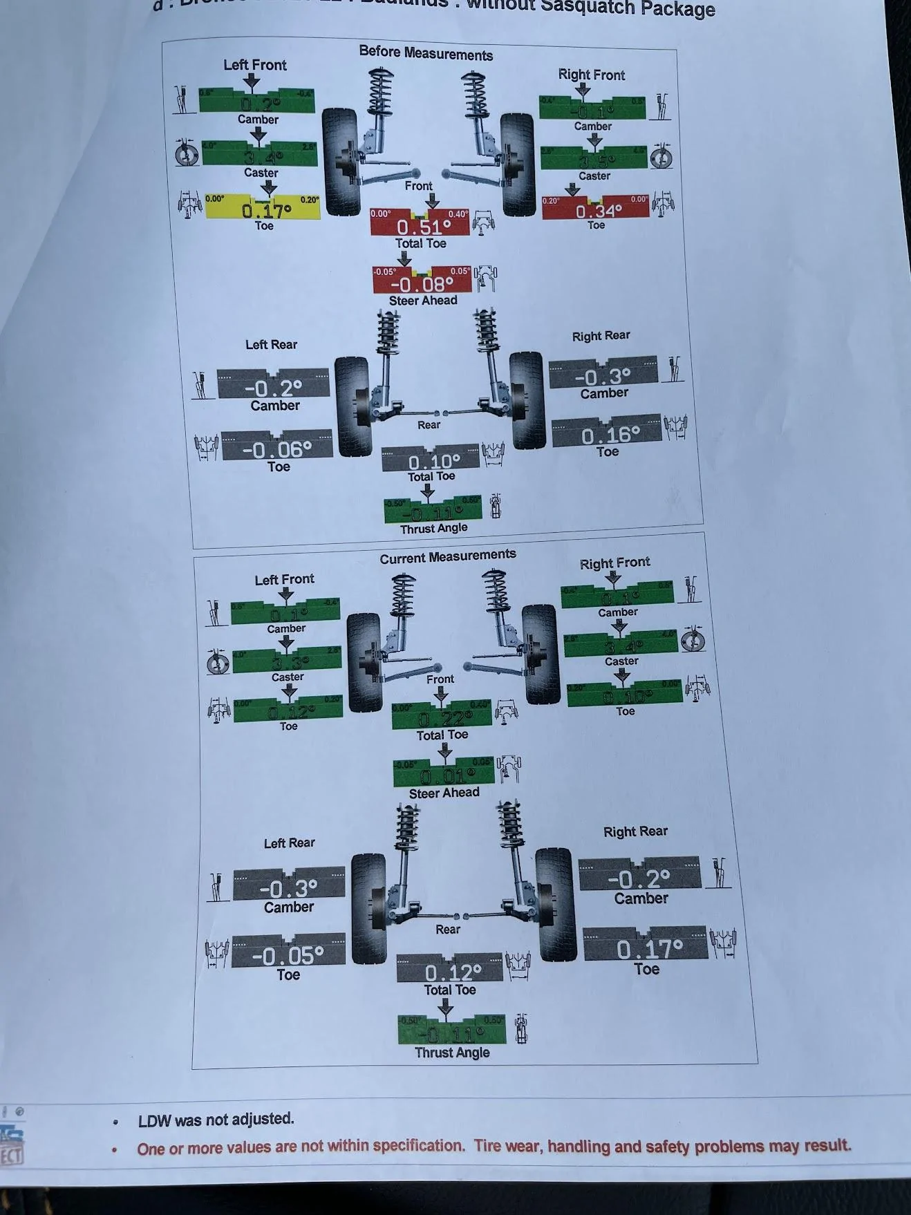

The car originally had a misaligned alignment when it left the factory, which led me to take it to the dealership. However, despite bringing it back to them twice, the steering wheel is now pulling in the opposite direction from before, and the issue remains unresolved.
Even though the alignment sheet they provided shows everything is within acceptable limits ("green"), the problem persists as the steering wheel continues to pull to the left. Considering this situation, I am considering taking the car to a private alignment shop for a second opinion and potential resolution.

Your pic still shows misalignment. I trust it’s the “before” pic? What does the after alignment show?
If you have pull while in correct alignment, I would suspect another issue. Tire, brakes, driveline, steering box. Another shop won’t help much. Rotate tires to see if there is an issue with one on the front.
I’d raise hell with the current dealer and or Ford, or try another dealer who can find the real issue.

Bottom pic is the current spec apparently but the steering wheel is still not centered. When it's going straight, the steering wheel is tilted to the left, and when I center it, the car moves to the right. The dealership balanced all 5 wheels and rotated them too.

Tech doesn't know how to align a vehicle apparently. Go elsewhere or keep going back.

When doing alignments, it's important for the tech to have the steering wheel locked in at 0 degrees before making any adjustments underneath. This is what happens when you don't do that.

Is the Bronco pulling to the left if you let go of the steering wheel or is it just that the steering wheel is off center when driving straight? Those are two very different issues.
If the Bronco drives straight with hands off the wheel but the steering wheel is just off center, then its simply a matter of them making sure the steering wheel is straight up when setting the alignment.
When I let go of the steering wheel, it goes straight, but the steering wheel is tilted to the left.
When I center the steering wheel, the car goes to the right.

Looks like you are in Denver. If you don't get a specific recommendation, just Google "tire alignment shop" for your area and go to one with high reviews. Agree with @swmetal , if the Bronco drives true when you are not touching the steering wheel, you are technically in alignment...it is just a cosmetic adjustment for the steering wheel.

Unfortunately no. Old days before electronic steering yes. Since it is driving straight, but the steering wheel is off, I would just take back and let them know they forgot to re-center the steering wheel as part of the alignment process. If they want to charge to fix what they should have done in the first place, I would take elsewhere.
Centering the steering wheel as part of the process is unfortunately becoming a lost art for some reason.
