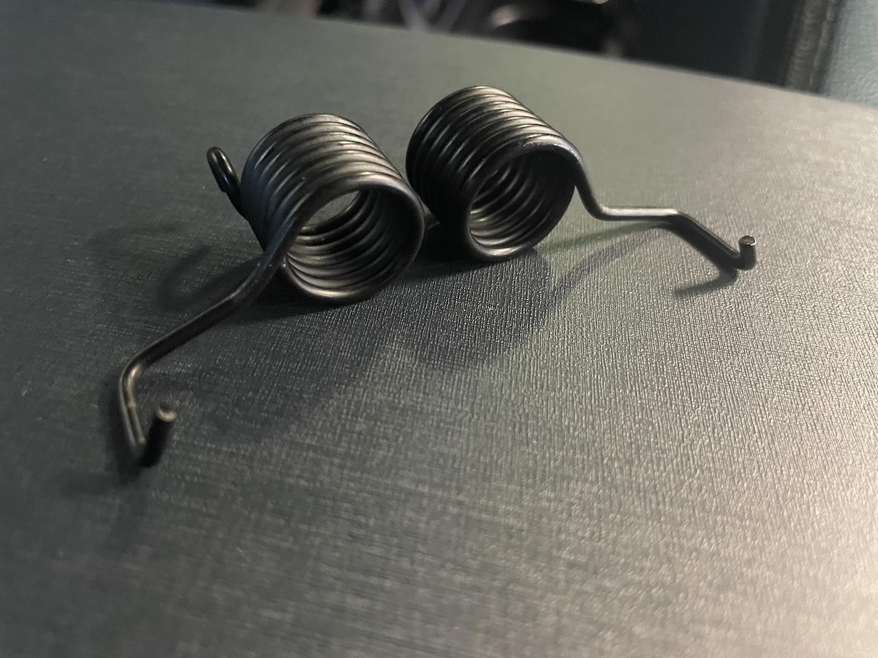

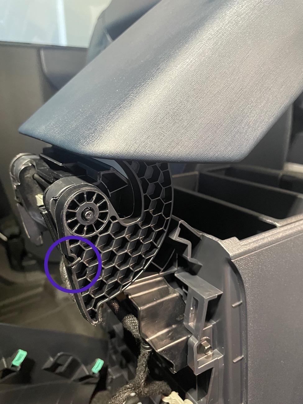

I also hated how the console lid comes crashing down. I read through several post and decided to come up with my own DIY to fix the cursed console lid. My solution is to simply bend each spring (picts attached) approx 45deg using just pliers to hold the spring securely and an adjustable (crescent) wrench or pliers to twist the spring. It takes a little effort to make the bend but everyone can perform. The amount of bend shown in the pictures allows the lid to be positioned in any open position without dropping. If you want the lid to spring open when the lever is released, try bending the spring a little bit more. It does not take a lot of bend to get the desired effect. When bending, just start the bend as close to the coil section as possible. Doing so will allow the spring to drop right back in the mating console detent during assembly. This DIY took me all of 15 minutes from start to finish and looks OEM. Good luck and enjoy the lid not crashing down.
Ford Bronco DIY - Cheap Easy Modification of Central Console Lid (keeps lid open / upright) Console Springs
The springs shown here are already bent to the desired position.
Ford Bronco DIY - Cheap Easy Modification of Central Console Lid (keeps lid open / upright) Center Console Assembly
Picture shows the bent springs back into the stock console detents and lid holding in open position.
This shows the amount of bend. Red shows original spring angle (straight) before bend.
I like your idea! It's definitely easier than my solution. 👍

Got mine done this afternoon.
My two biggest challenges were needing to remove the rear, center console mounted cup holder, and the second was getting the hinge pin back in place properly. I solved that (eventually), by pointing the console lid straight up instead of at an angle (partially opened lid), which aligned to hinge holes just right.
I already love this mod.
