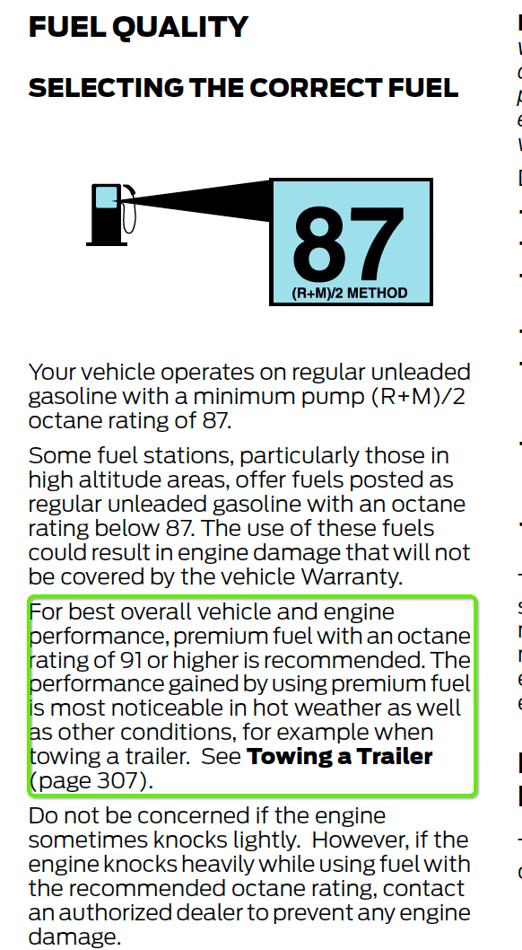

Ford recommends 87, however performance can be gained using 91 or higher, according to my 2022 owners manual.

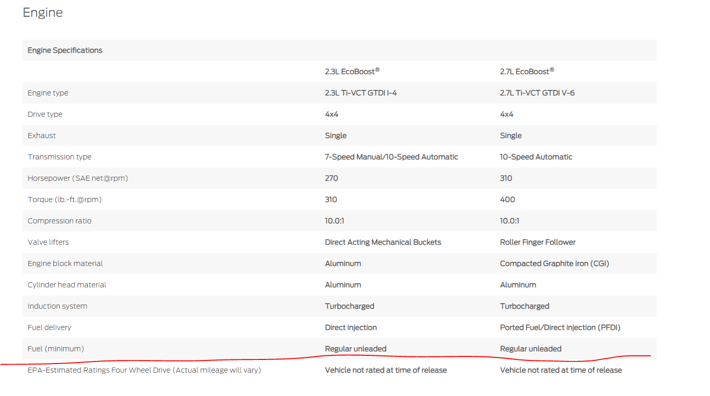

Required? No. It takes regular just fine.
If you want slightly boost on HP and Torque, use Premium then.

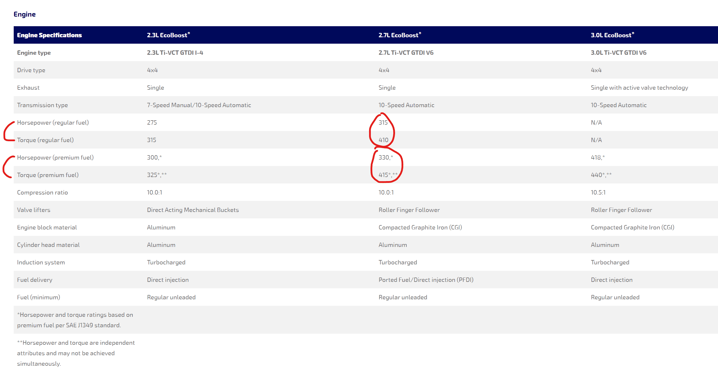

Edit, Here is a more detailed comparison between power figures and fuel types.
Ford Bronco Does the 2.7L Ecoboost require premium gas? 1703698955426
