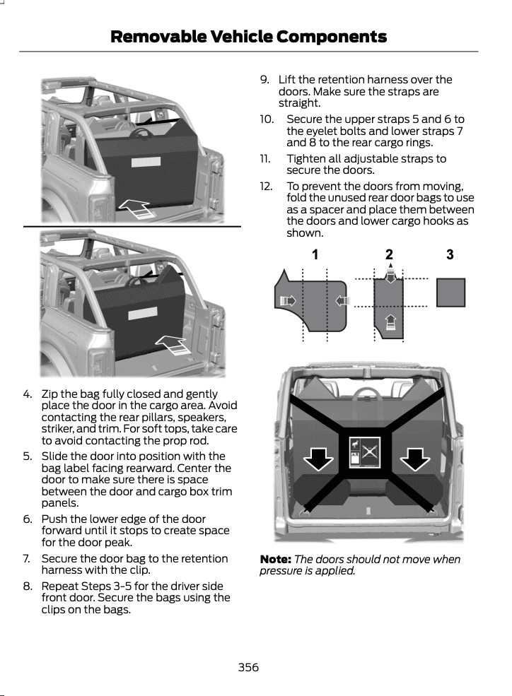

The owner's manual makes it sound like there is not an issue with storing the doors on board with a soft top.
See point #4:
Ford Bronco Door storage in cargo area with soft top? Screen Shot 2021-07-13 at 15.04.30
This confirms it. Straight from the manual! I also ordered on board storage bags while on the phone with the dealer.
