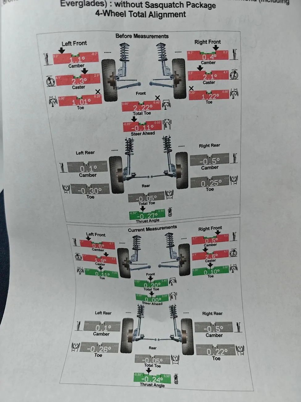

Bumping with a follow up question. I got an alignment after installing my 2.0s. I have the rears 3 threads up from the bottom and the fronts about 10 to get it fairly level with about 1/2" of rake. I didn't want to lift the front too much to get it totally leveled, and am happy with the stance.
My alignment is close but not perfect. Apparently this is as close as he could get it. It also took him an hour and a half. Everything is OEM other than the Eibachs.
A friend explained why this happened, but Im confused why I keep reading that the OEM CAs should be able to maintain a good alignment within the amount of lift that I have. The nitty gritty of the alignment specs is sort of over my head, although I understand what each one "means". Would ya'll be happy with this alignment?

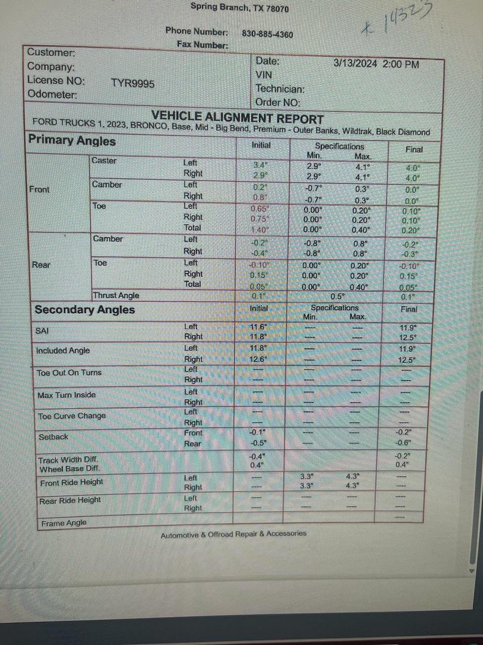

I would want camber at zero and a little more caster. My alignment guy had no trouble getting my Alignment dead on and even added extra camber at my request. It’s at 4°. now. My height settings are almost identical to yours. Actually my front is a little higher.
you can look at the adjusters on your lower control arm and see if they are maxed out.

Just got back from the alignment shop, I was pretty close going in, which surprised me since I needed to disconnect and rotate the steering wheel during the process of installing the UCAs.
Overall, I have less caster than Fordified1 has, but everything was able to get in spec with the Zone UCAs. The only reading out of spec was toe when I brought it in.
