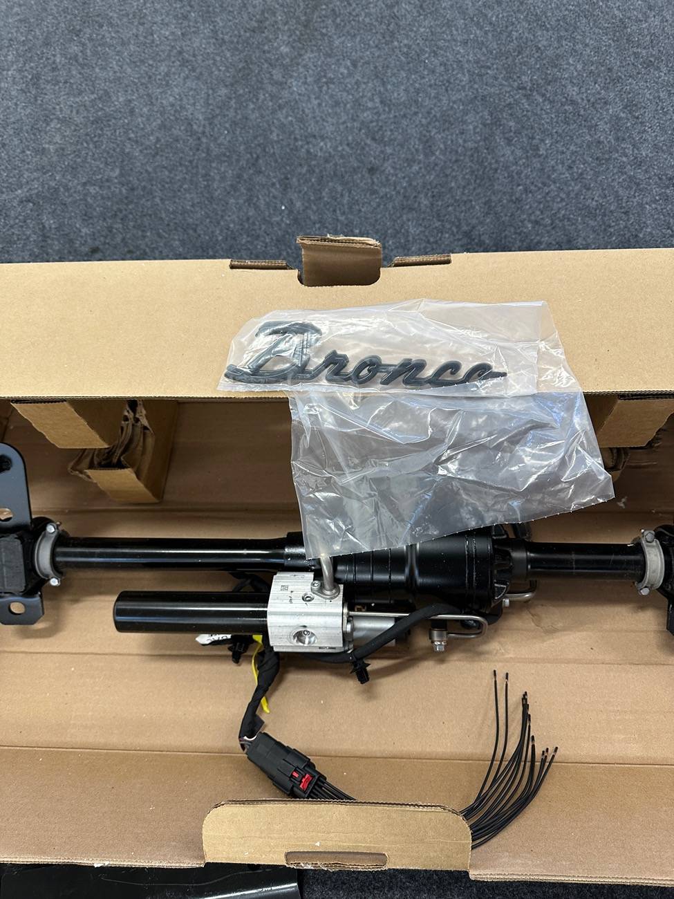

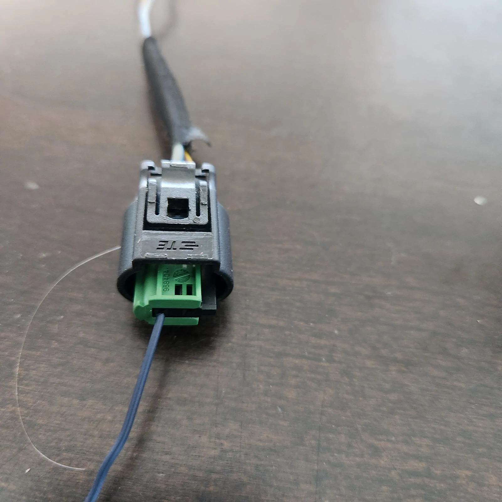

I'll add that the positive side is noted on the plug in picture...and the #1 outfitter switch is yellow wire.
plugs can be found on eBay also.
Super easy swap on our Wildtrak...love that you can activate at any speed any mode.
