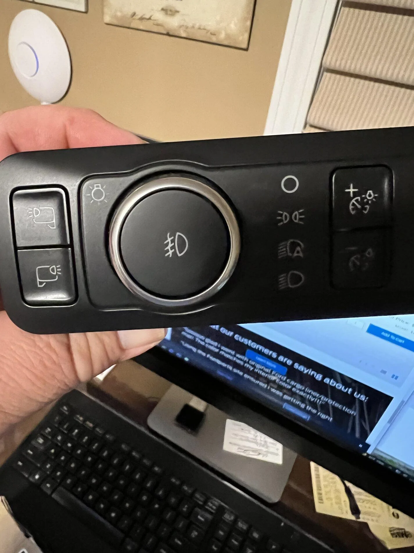

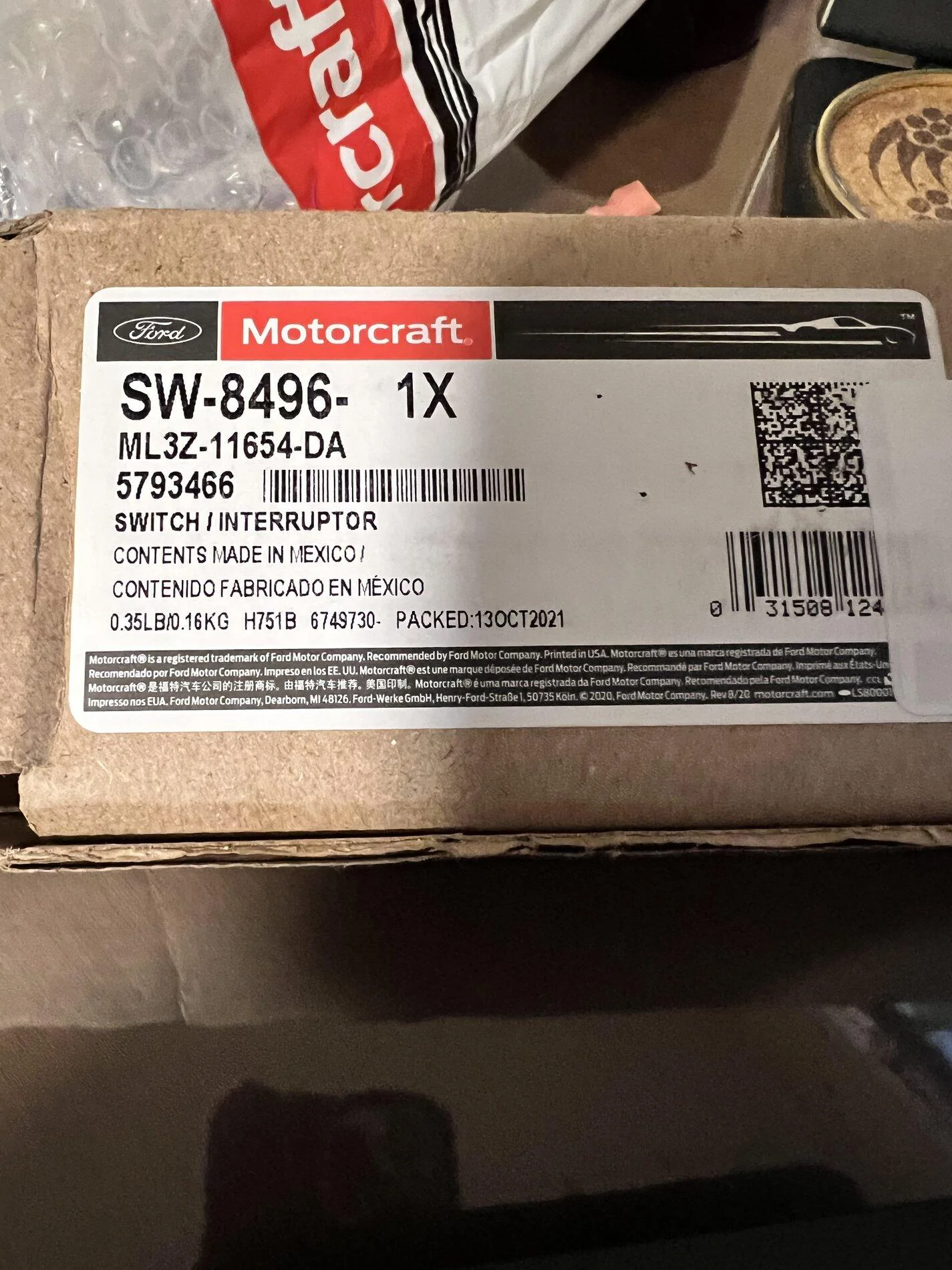

The switch issue is solved. I ordered the Switch ML3Z-11654-DA
Ford Bronco Factory Fog Light Switch IMG_0852

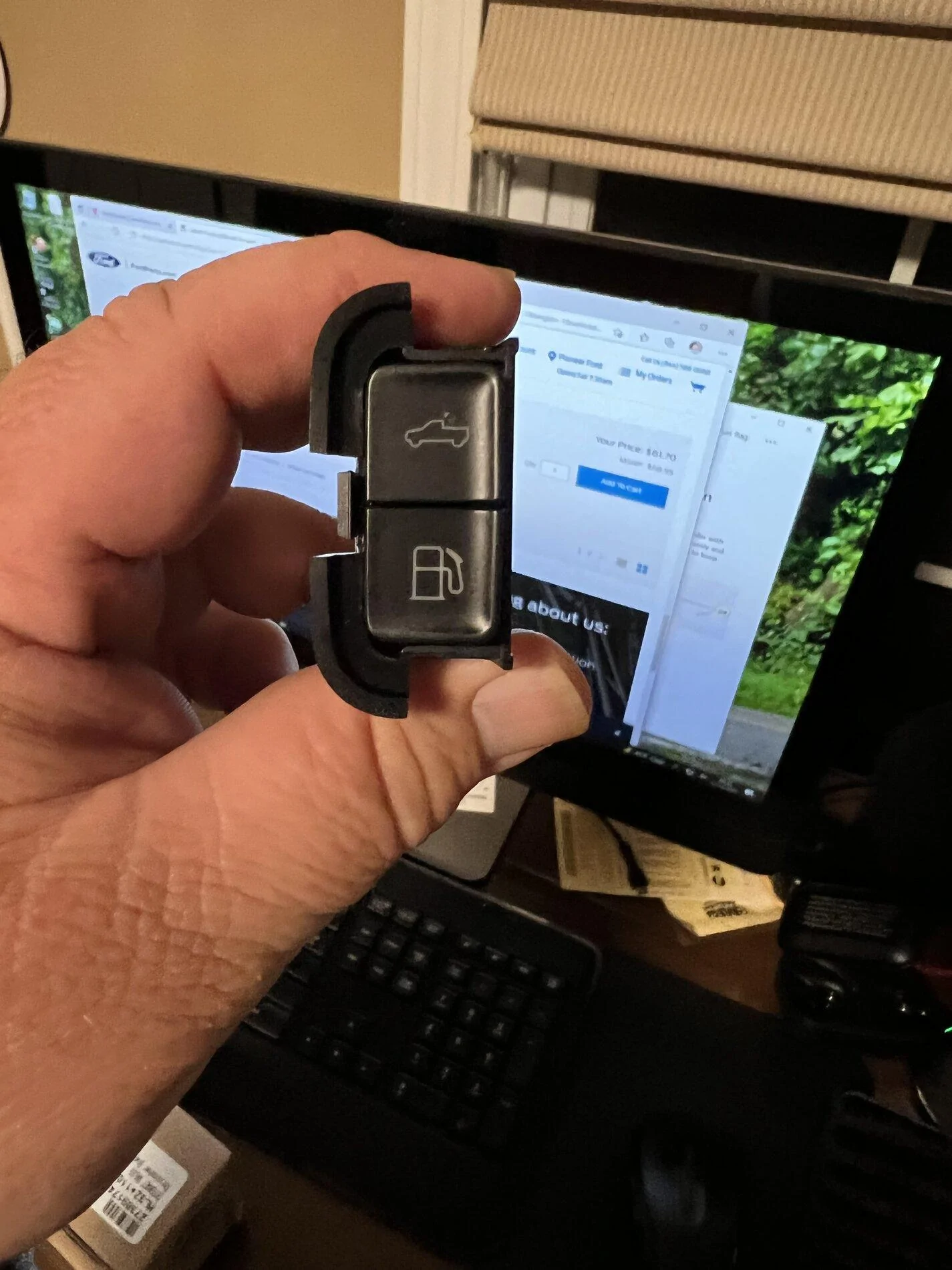

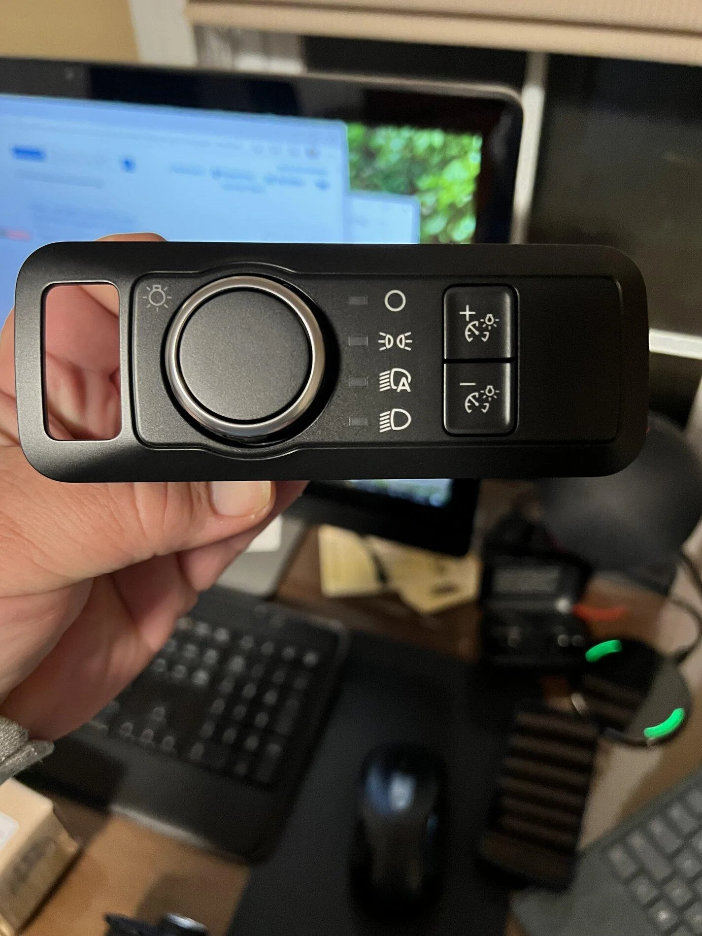

everything was correct except for the mirror light buttons were not there, I had these buttons instead.
Ford Bronco Factory Fog Light Switch IMG_0849

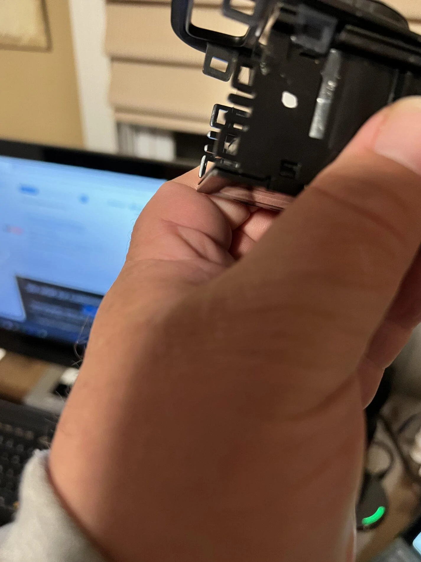

I was reading in this Thread about how they are on back order now and was stating to get P.O.ed that I had the wrong switch, but then I got to looking at the switch to see if there was anyway I could some how make it work. That Is when I noticed that the left buttons were a separate module that pluged in to the main switch. So I started taking the face plate off and was able to remove the buttons. i then replaced them with the buttons from my old switch.
Ford Bronco Factory Fog Light Switch IMG_0851
Ford Bronco Factory Fog Light Switch IMG_0850
Volia I now have a functioning switch with the foglight button and the correct lamp buttons.
Ford Bronco Factory Fog Light Switch IMG_0848
I tested the functions and everything is working properly. All that is left to do is activate the foglight button once my BD light kit comes in.

I’m curious about you ordering ML3Z-11654-DA …I had taken down the switch part number as M2DZ-11654-DA. Glad you made it work!
