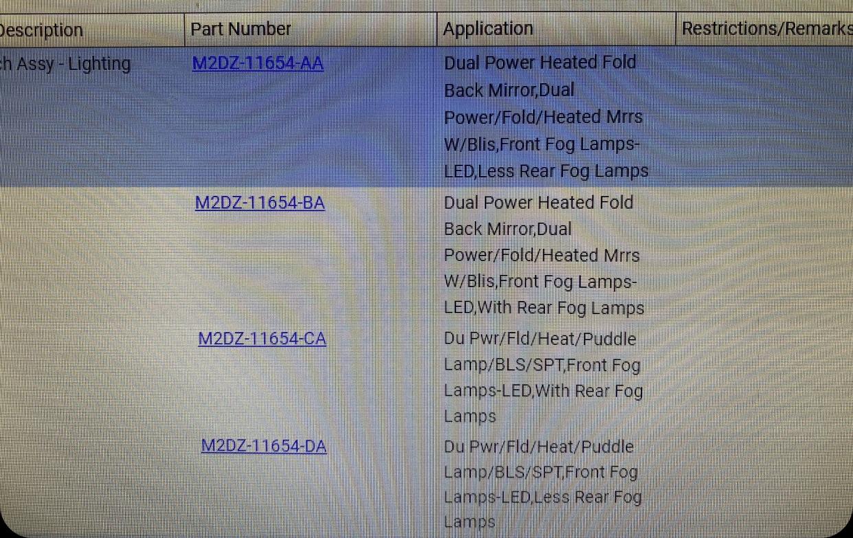

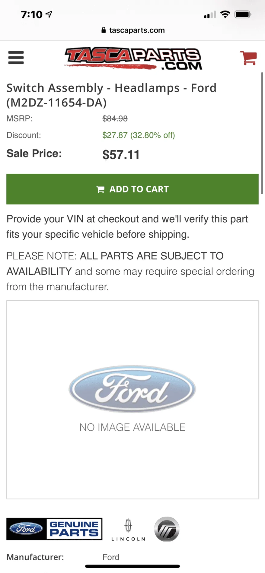

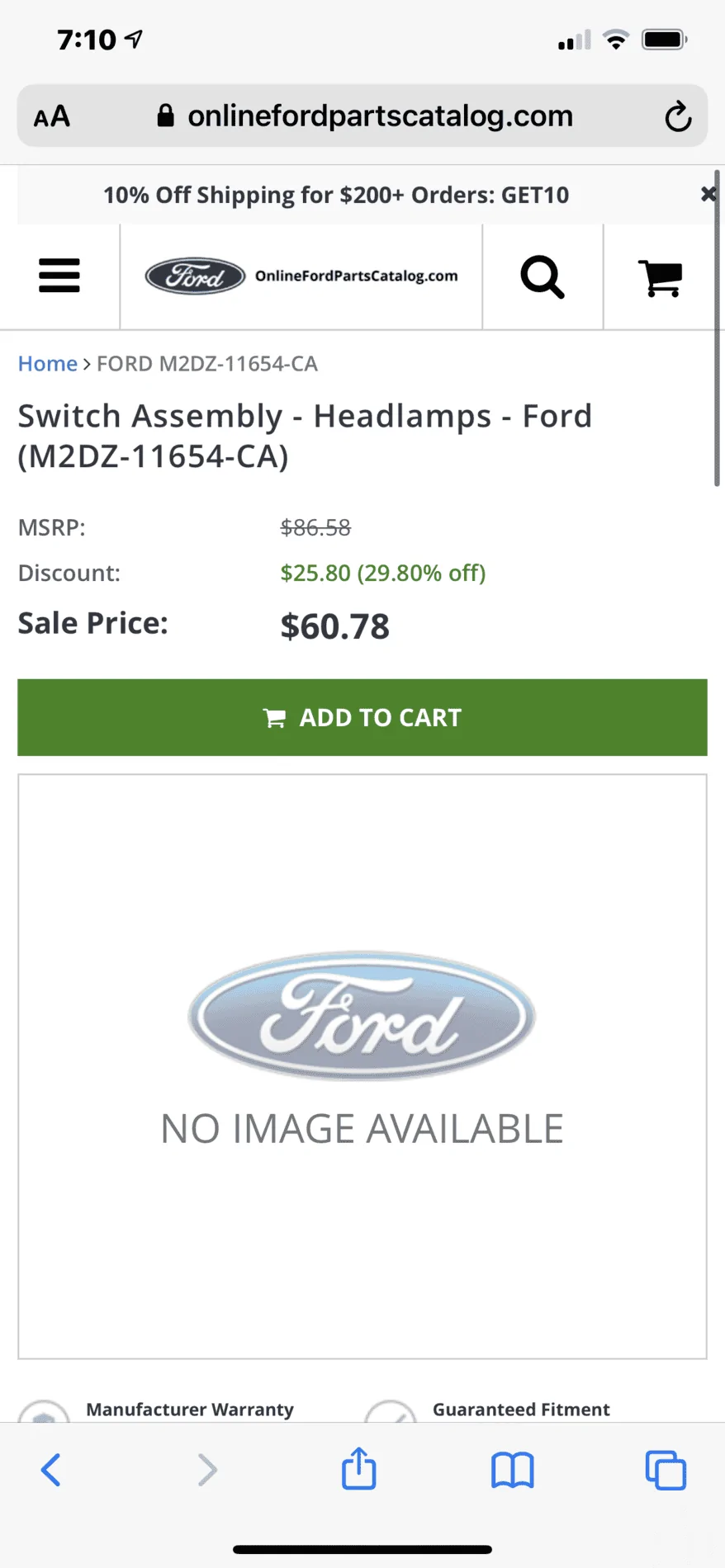

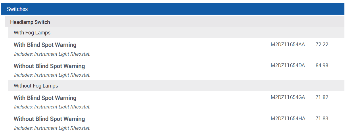

Here is some of what I found related to part numbers and descriptions for the switches.
Ford Bronco Factory Fog Light Switch 1631114548877
