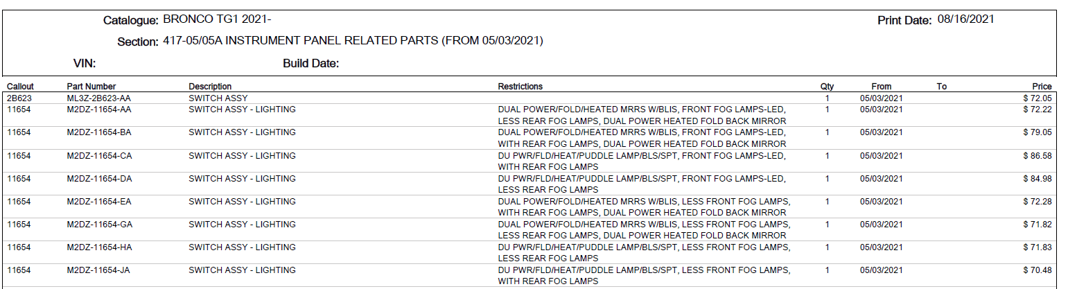

So, presumably M2D-Z11654-BA is what I’m looking for…Base headlight/fog with rear fog capabilities?? Assuming that's the one because I don't have "Puddle Lamps" but, I also don't have BLIS. So...

Dug into it a bit with someone at Sam Galloway Ford and it seems like that’s the part to go with for adding front/rear fogs to Black Diamond with Mod Bumper. They also had the best price at $56.92.
Tip - if you leave it in your cart and abandon it - they send you a code for 5% off.
So it ended up being $67.29 shipped.

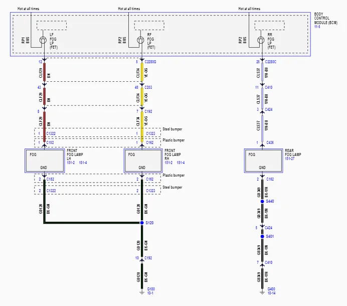

I just ordered M2DZ-11654-CA for mine, and I know front fog lights won't be hard, but will see how back works out. I subscribe to Alldata but the wiring diagrams are not available yet, but should be soon. Once I have those I can see if the wires happen to be there for the rear, but I doubt it.

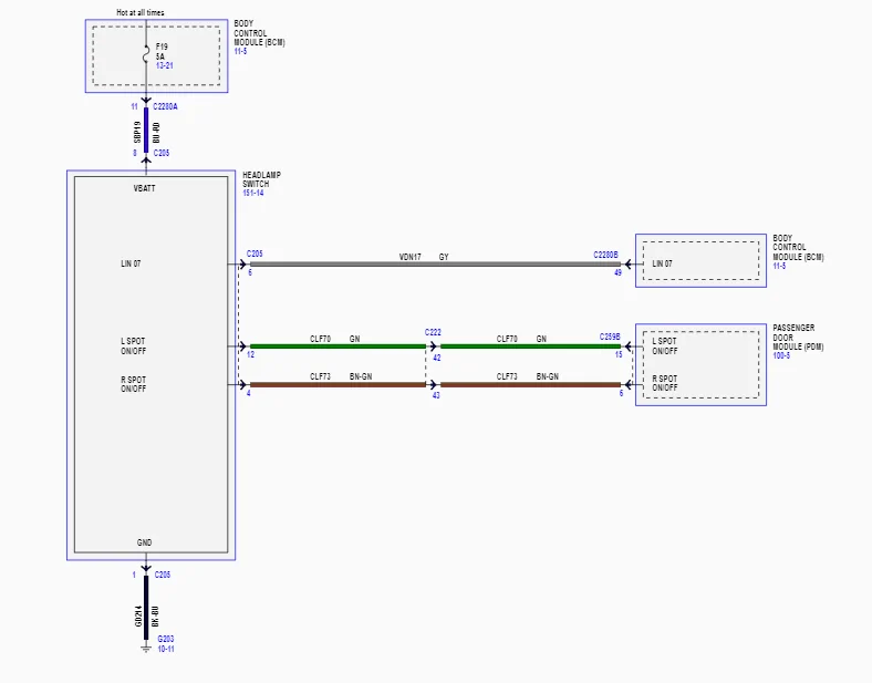

Do any of the stock options include puddle lights? Are those just the ones on the side view mirrors?
Here you go:
Ford Bronco Factory Fog Light Switch 13B96EEC-0EF0-482E-92B4-C51A48039D1B
Ford Bronco Factory Fog Light Switch 9D85871A-6FA3-4D44-933B-5F9C7E5E9081

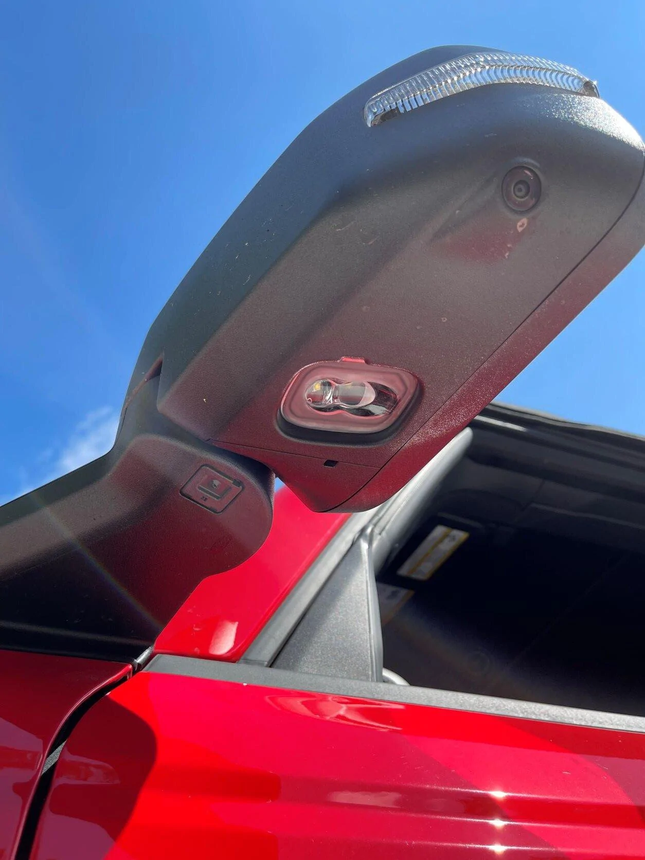

Yes they are the lights in the mirrors that shine down on the gro
Here you go:
Yes the stock puddle lights are the ones in the mirror that shine down on the ground.

puddle light
Ford Bronco Factory Fog Light Switch Puddle Light

I was doing some digging to try and find the factory fog wiring which is supposedly running along the front of the bumper. If all goes as planned I will be able to splice that and (hopefully) just pop in the new switch. I have to dig into Forscan a bit too to see what parameters are available.
