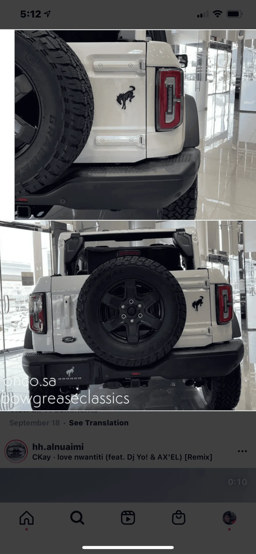

Trying to find a picture but there’s a picture I’ve seen floating around of a bronco in the Middle East sporting a rear foglight above the trailer hitch in the bumper.

Cool! Small and inconspicuous...
But very bright I bet!
Yup! My logic is that the plug for it should be in that general area. Then I could hang a small pod to the right of my hitch and wallah! Back up lights
