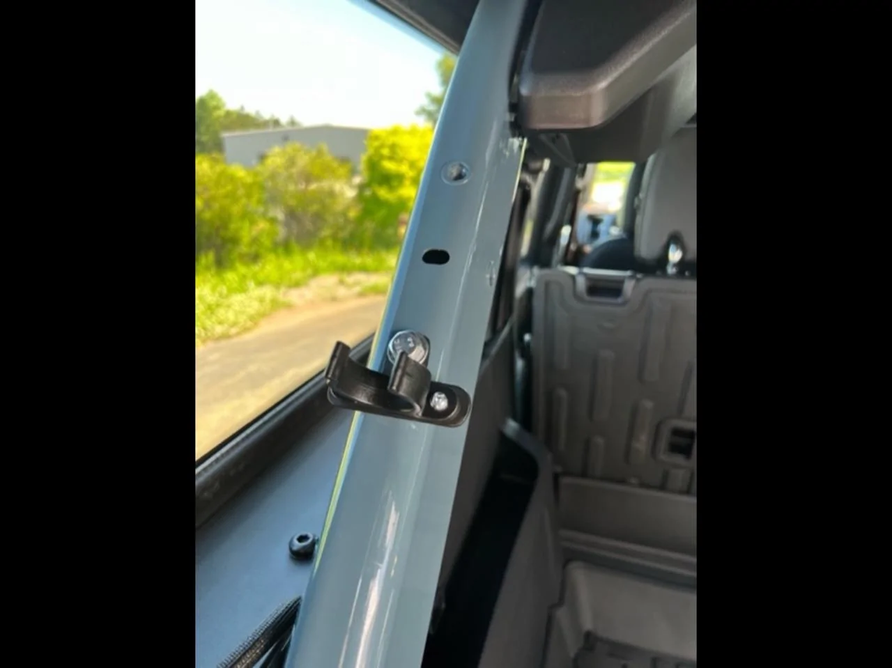

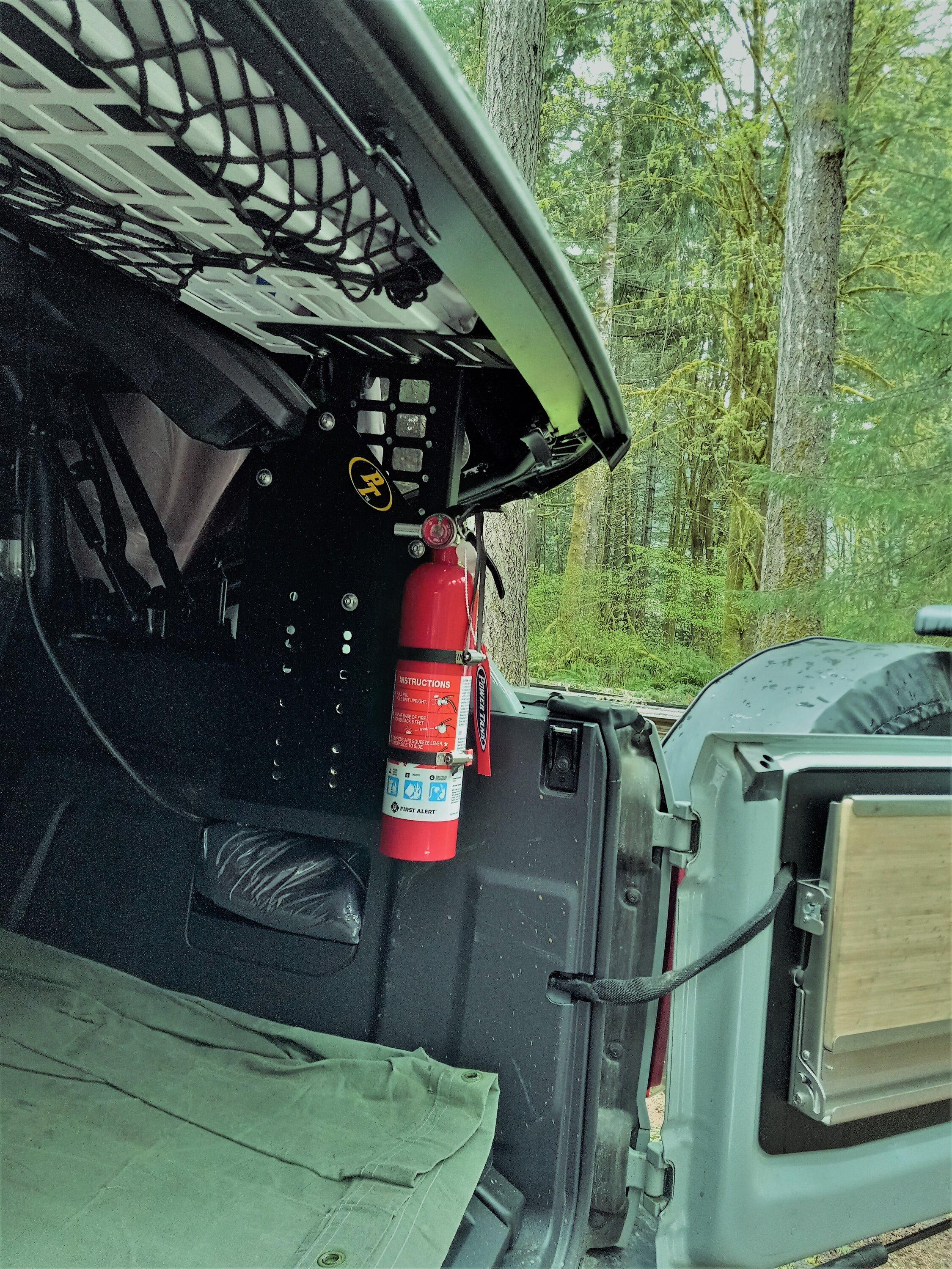

I have this:
Adjustable Strap Bracket Mount https://a.co/d/asrhdOk
I strap a 2.5 lb extinguisher to it. I also keep a small one under the front seat.

Do the holes actually line up with the pre drilled holes in the roll bar?

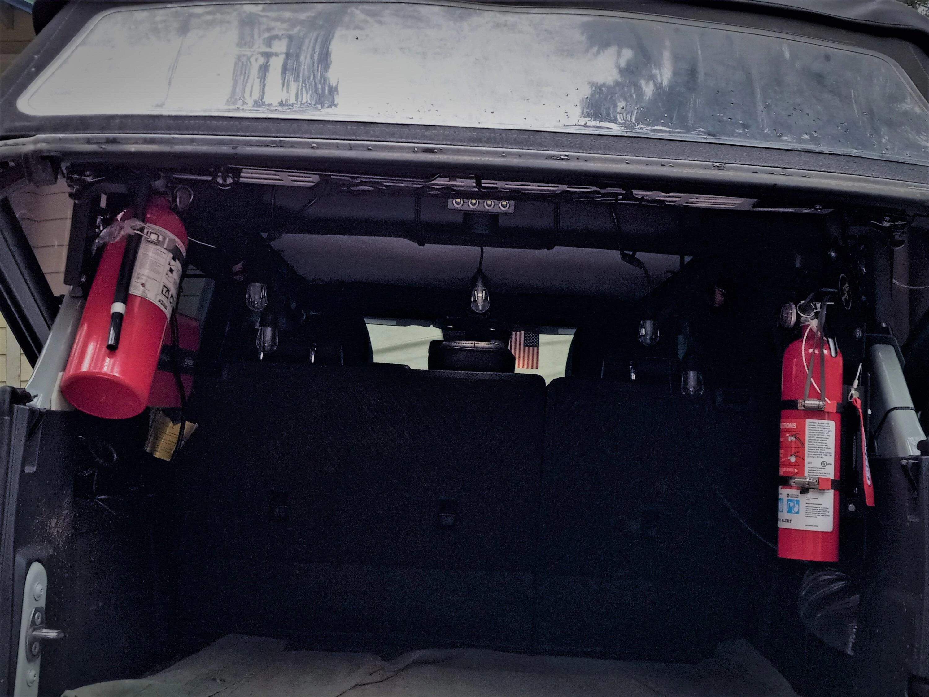

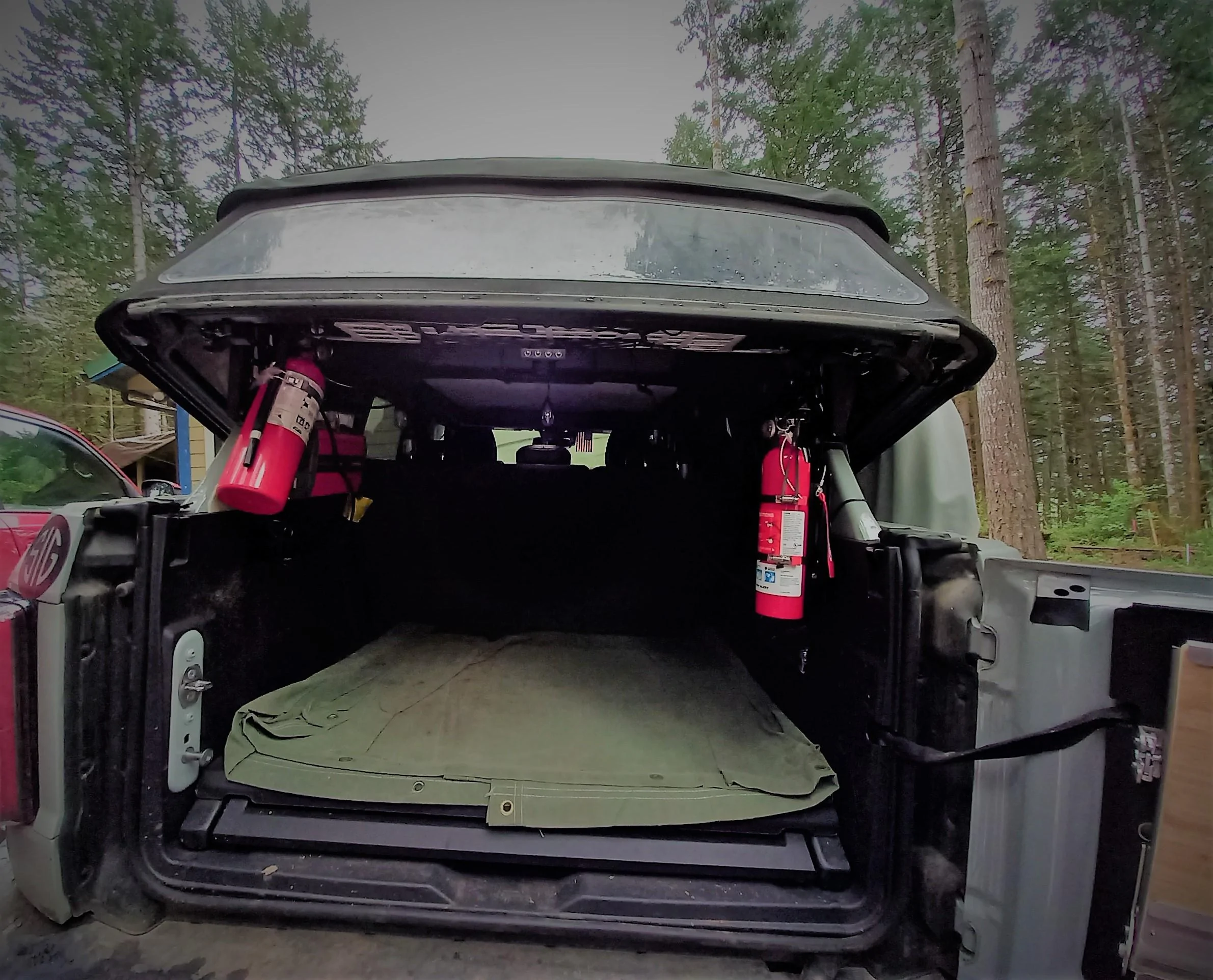

Short answer no....But very easy to mount on any number of panels. Will post an image when I have light for the image and have the time. Takes no skill just time to secure it well, so no rattling on the trails.
Sorry OP...But perhaps small modifications are ok? :cautious:
as promised> cargo area dual mounted extinguisher images:

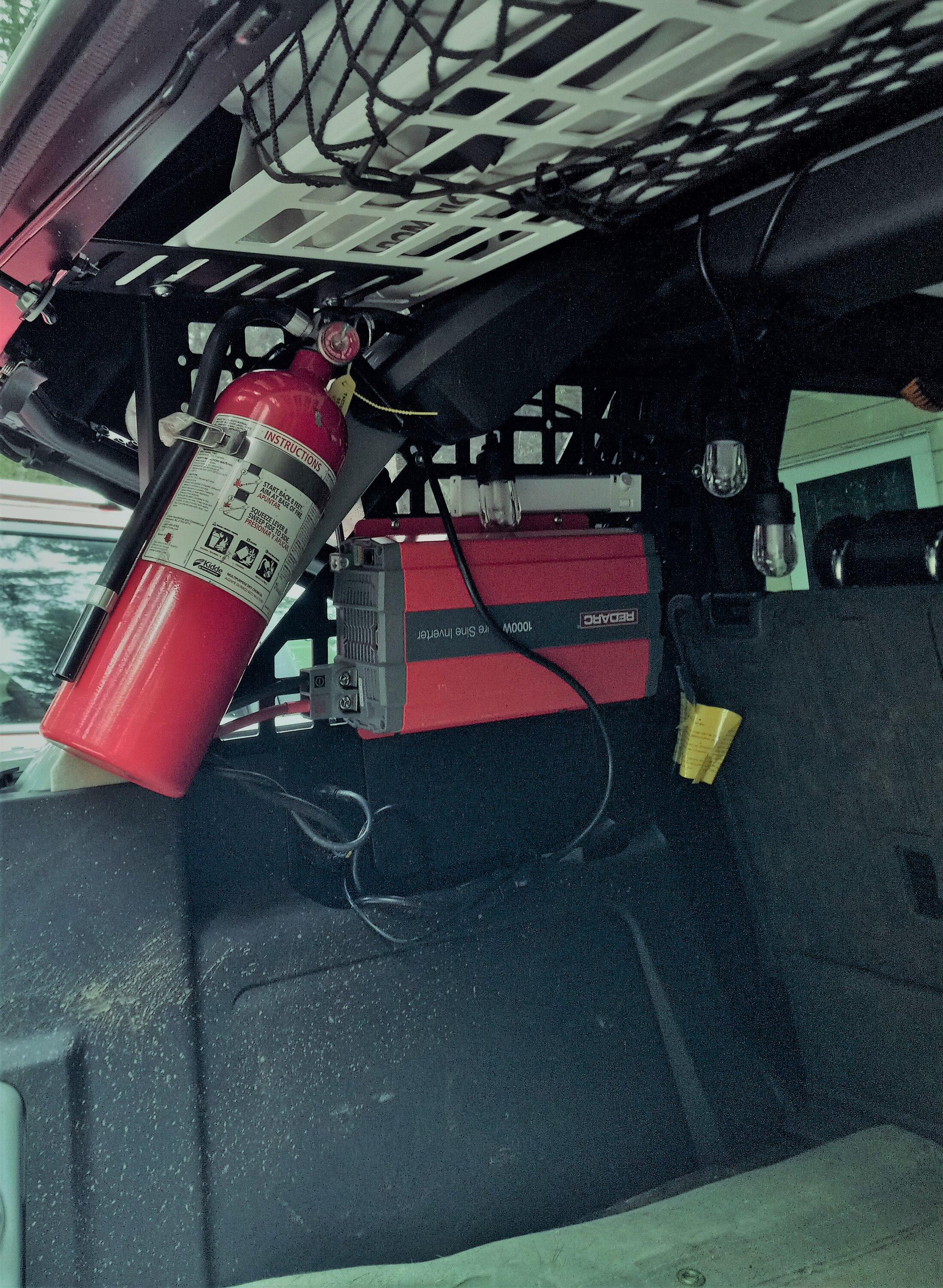

Not sure what you mean by no mods. No drilling, just replace tailgate panel with Molle panel. Added benefit is that it is out of sight. Not cheap though.
https://coursemotorsports.com/collections/quick-release-fire-extinguisher-mount
Black/black quick release, black Halotron, and Molle panel for my tailgate. Easy install, almost completely vibration free (the top pins/zip ties of the extinguisher need to be kept from slightly moving with a rubber band or hair scrunchy).

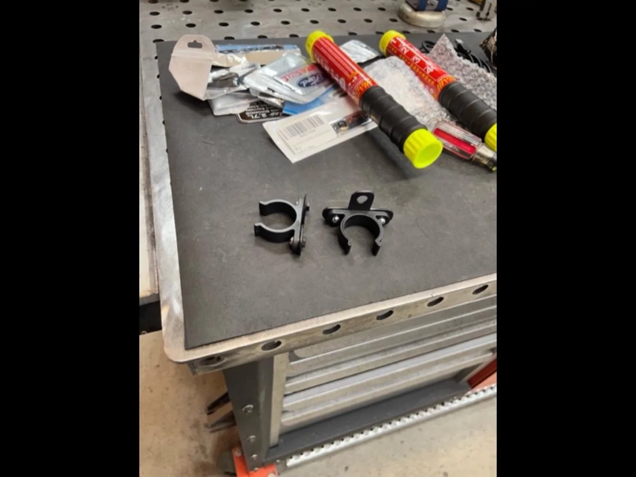

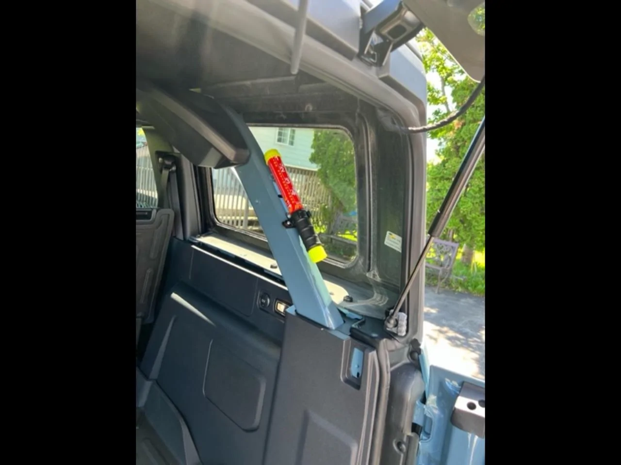

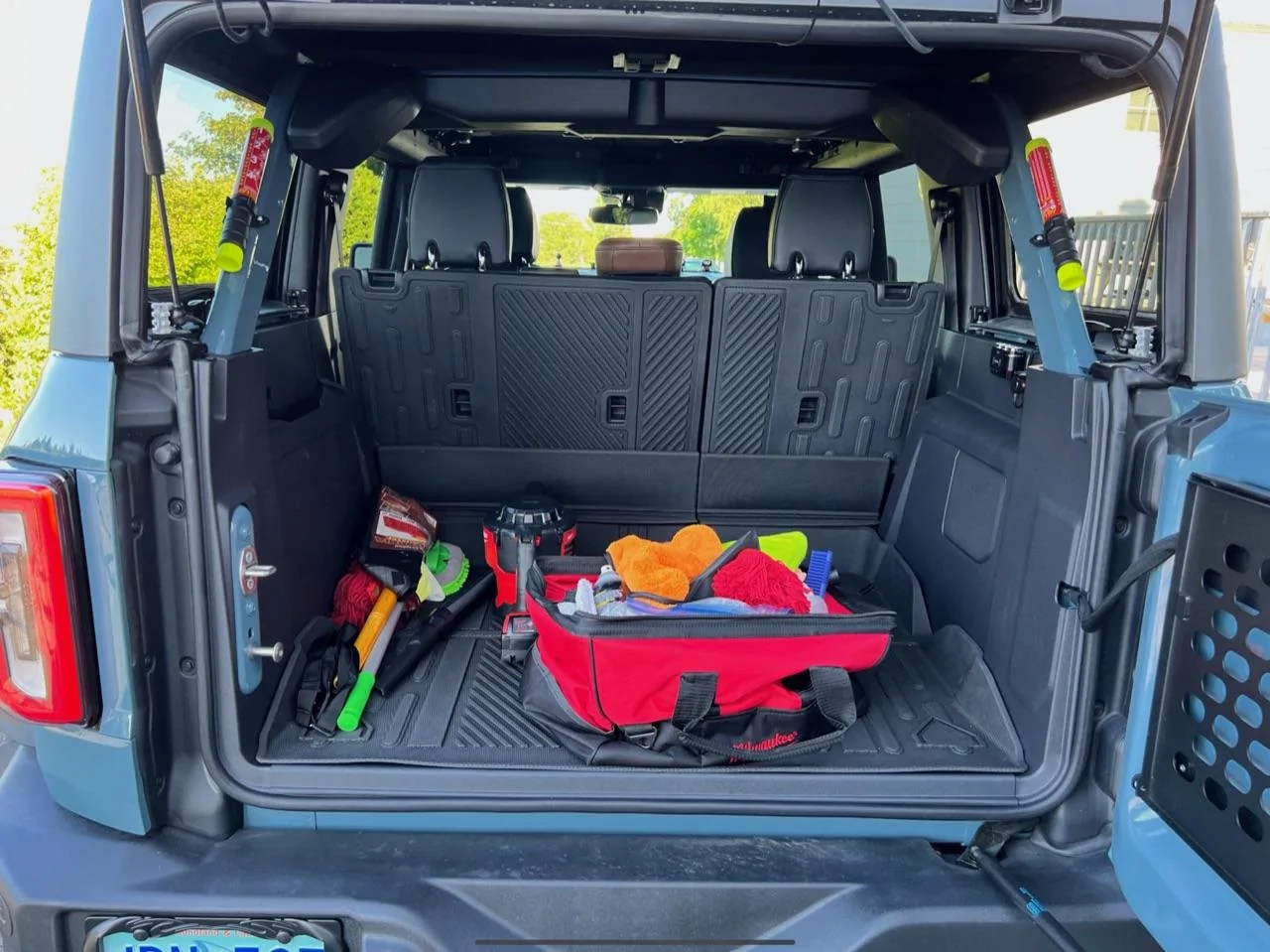

I mounted a fire extinguisher on each side of the rear bar. I cut a couple of brackets on the CNC that fit the existing threaded holes in the bars and simply bolted them on.

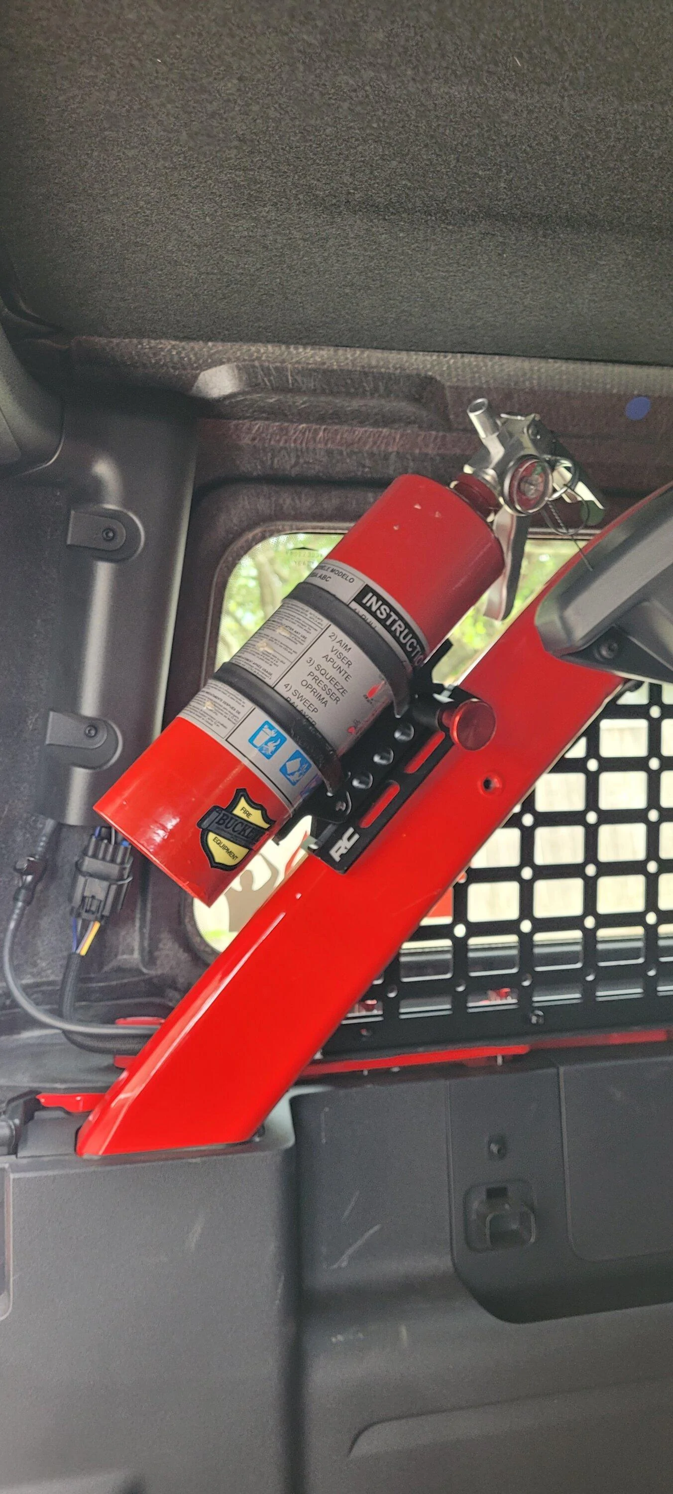

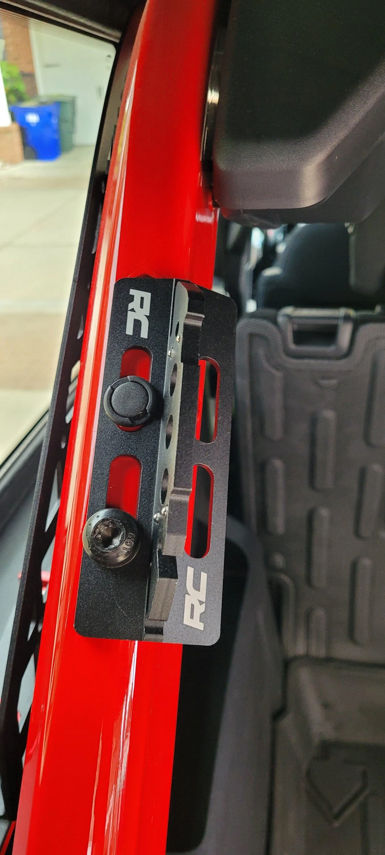

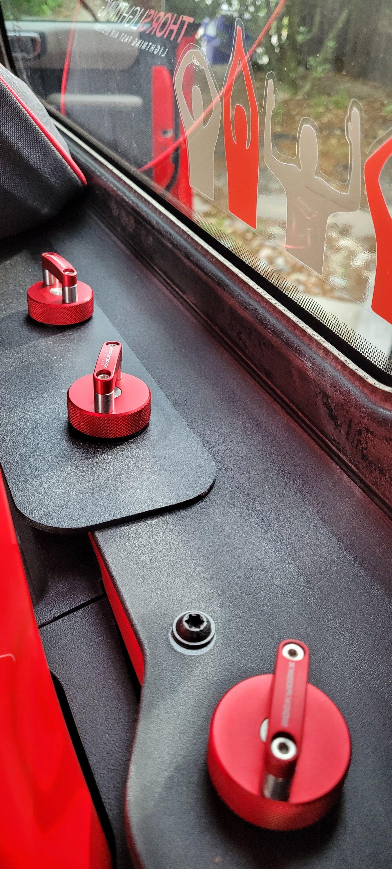

Heare's what I did: Buckeye brand (obviously) 2.5Lb extinguisher mounted with Rough Country's fire extinguisher mount. Utilized the bolt hole on the roll bar and one of the T50 bolts from the hardtop bolts as I had installed Rock Workx thumb screw quick removal fasteners. Then a plastic plug in the other existing hole just for alignment.

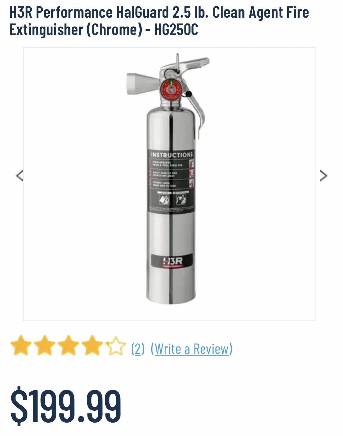

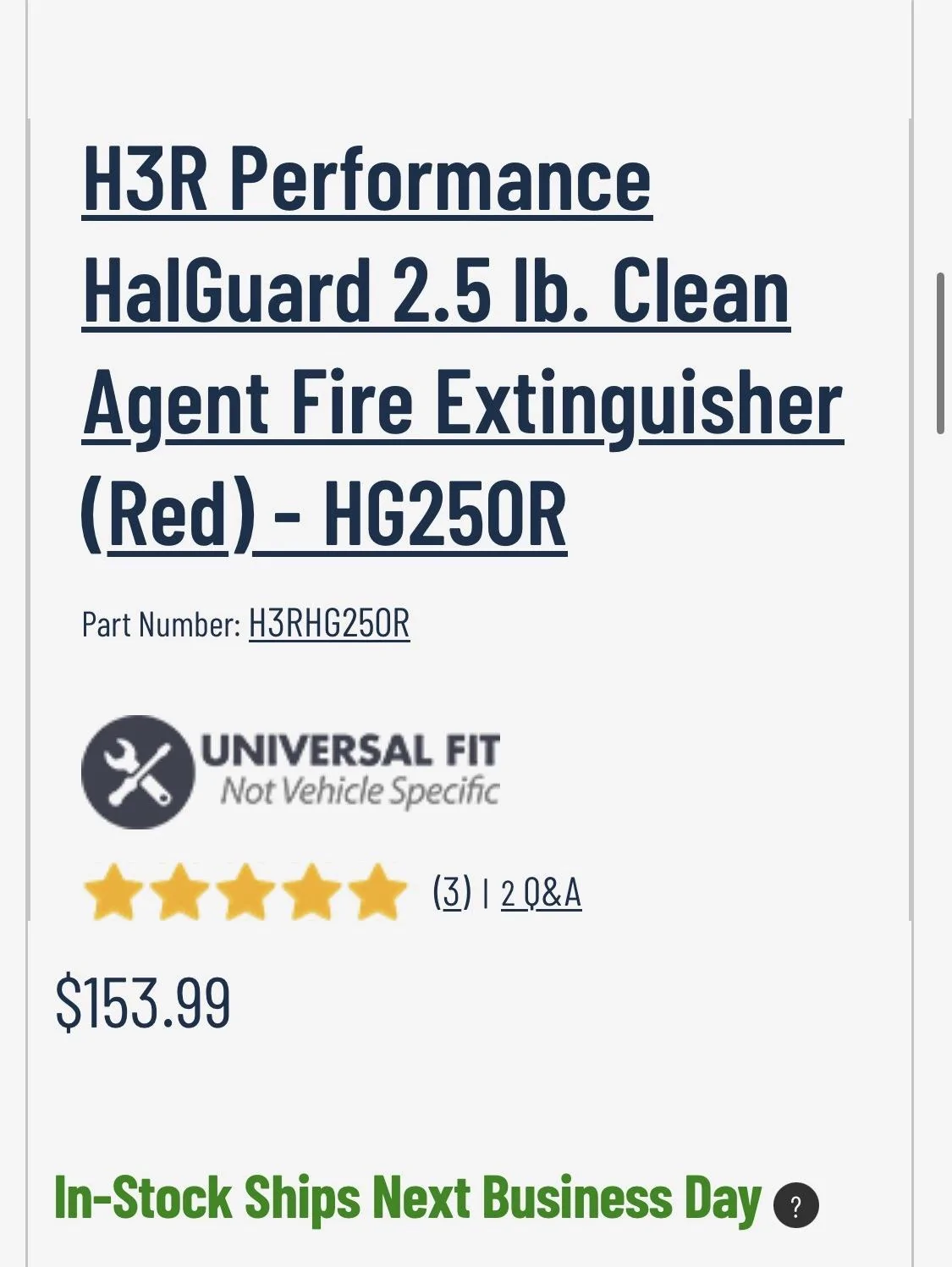

I couldn’t pass it up at 60% off
and no residue
Link? Looks like 4WP, but I can’t seem to find it on their site. I would like to get another at that price.
