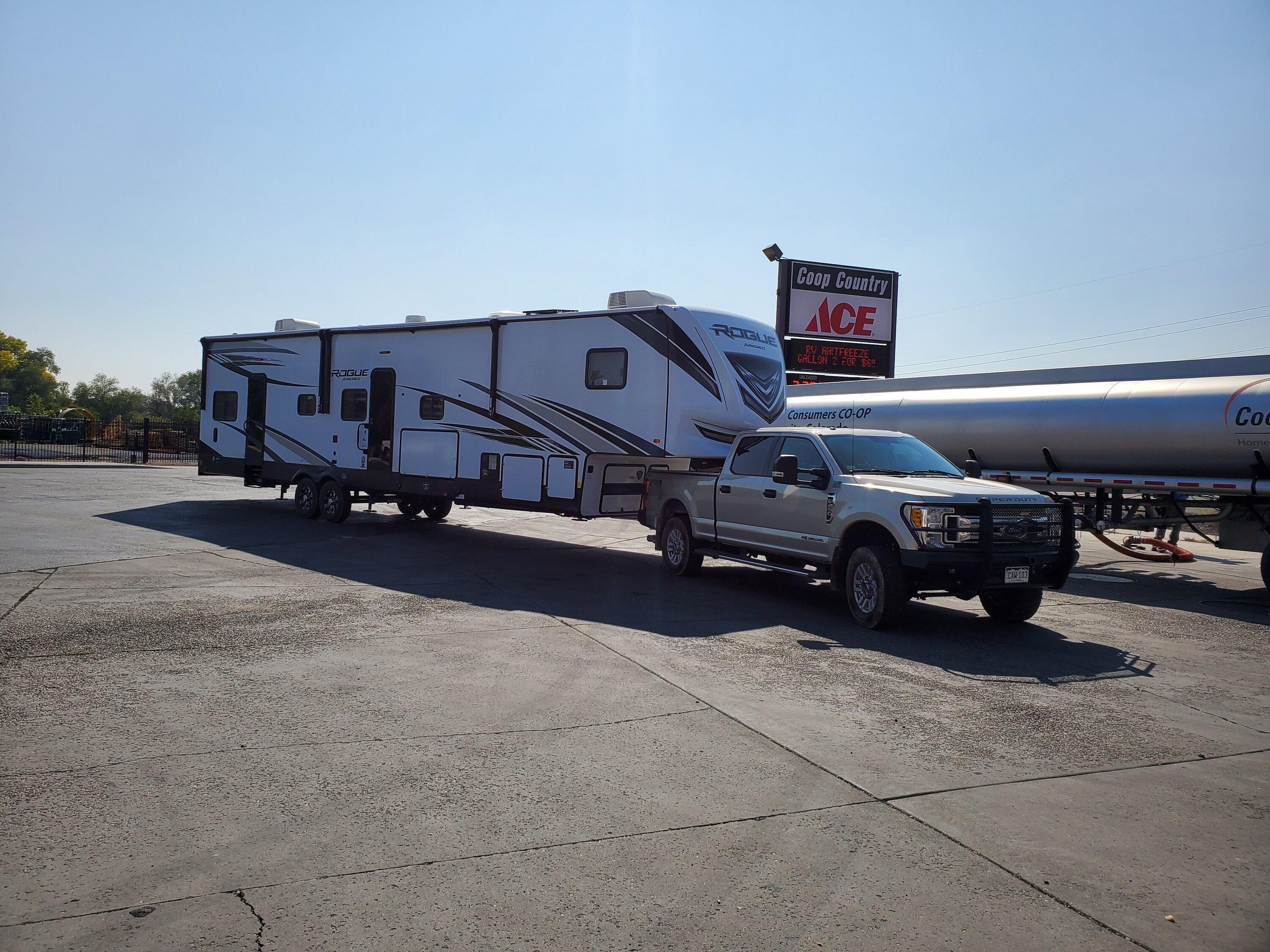

@joes bronco I think it's a non issue! Ford Superduties towing heavy up mountain pases see high 240's. On Ford-trucks.com forum people are always asking about that, being that hot on steep grades with heavy loads, all normal is the responses. I've been that hot many times and have done the drain and fill on my 6R140 twice now. Both times fluid looked great, still red not brown.
Also, are you in 4L when snow wheeling? That will help with temps also, everything doing less work...
