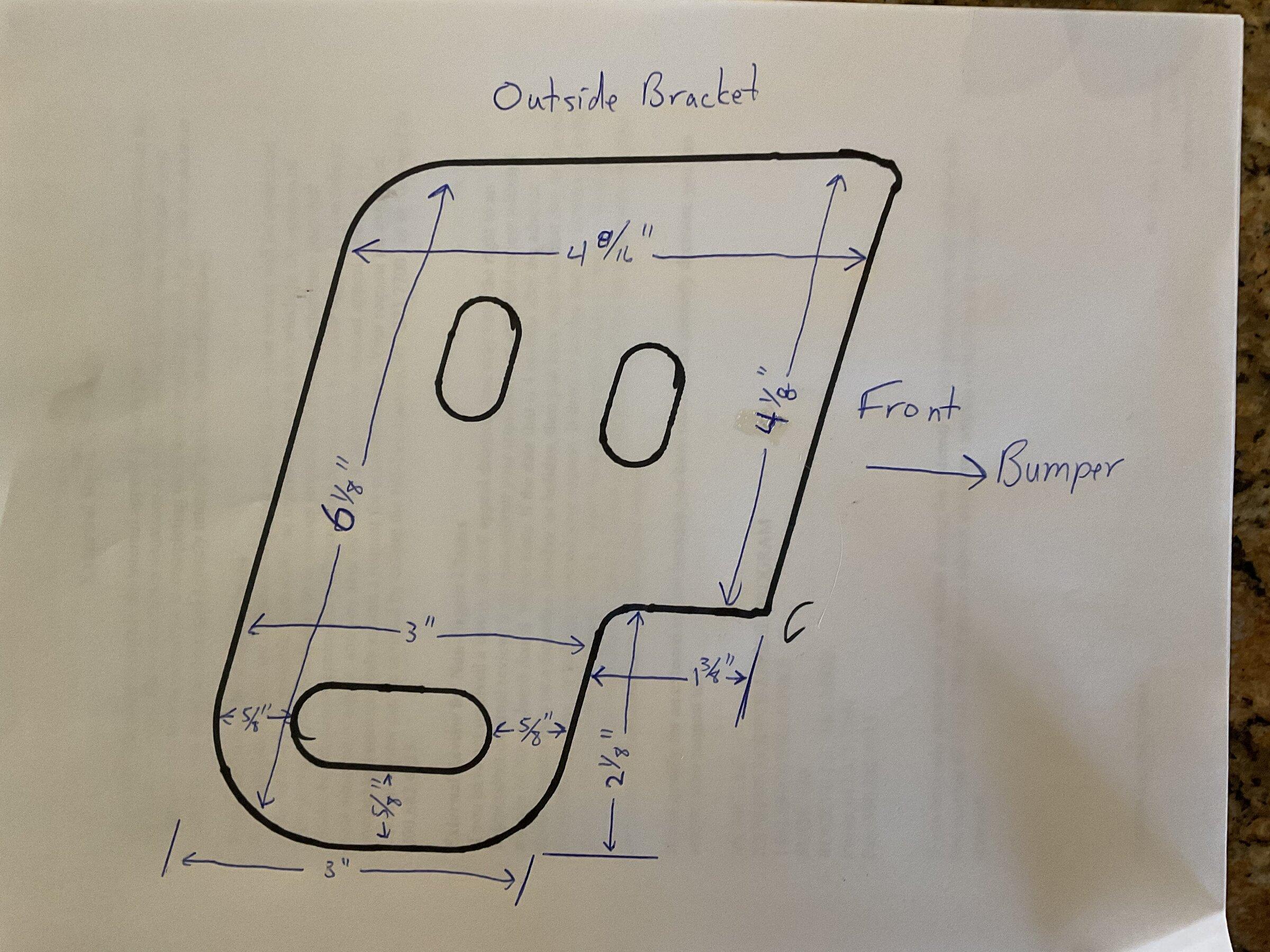

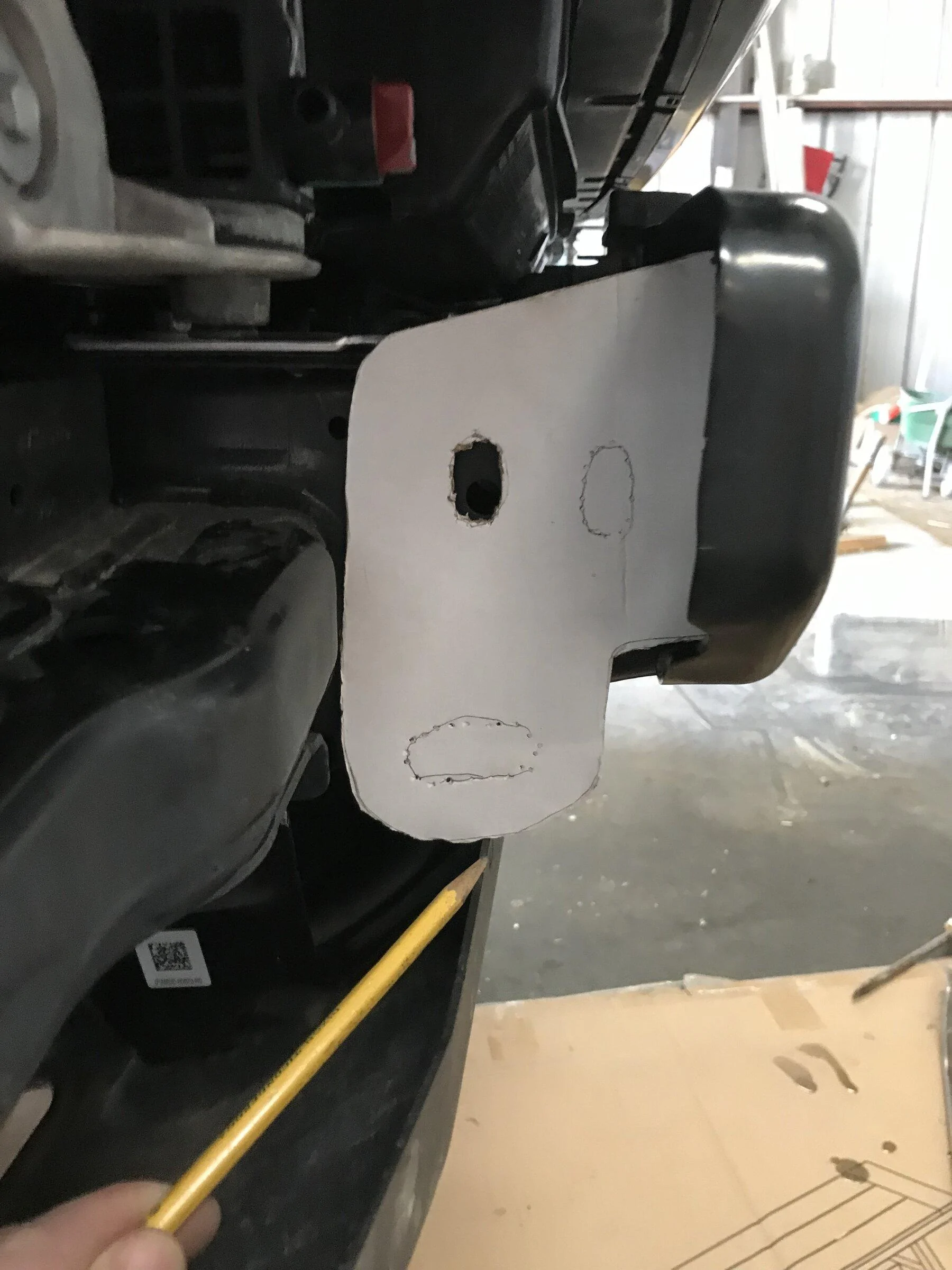

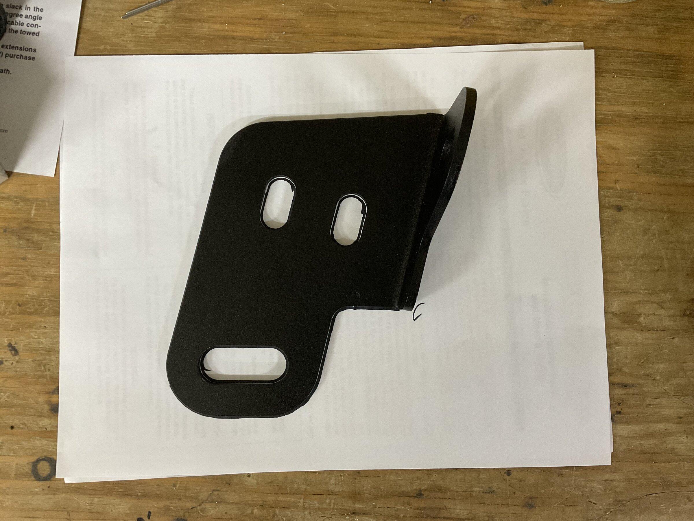

I adjusted my printer scaling and came out with a cardboard jig that is very close to Tilzbow's measurements. I believe those tow points will work so we will order a set.

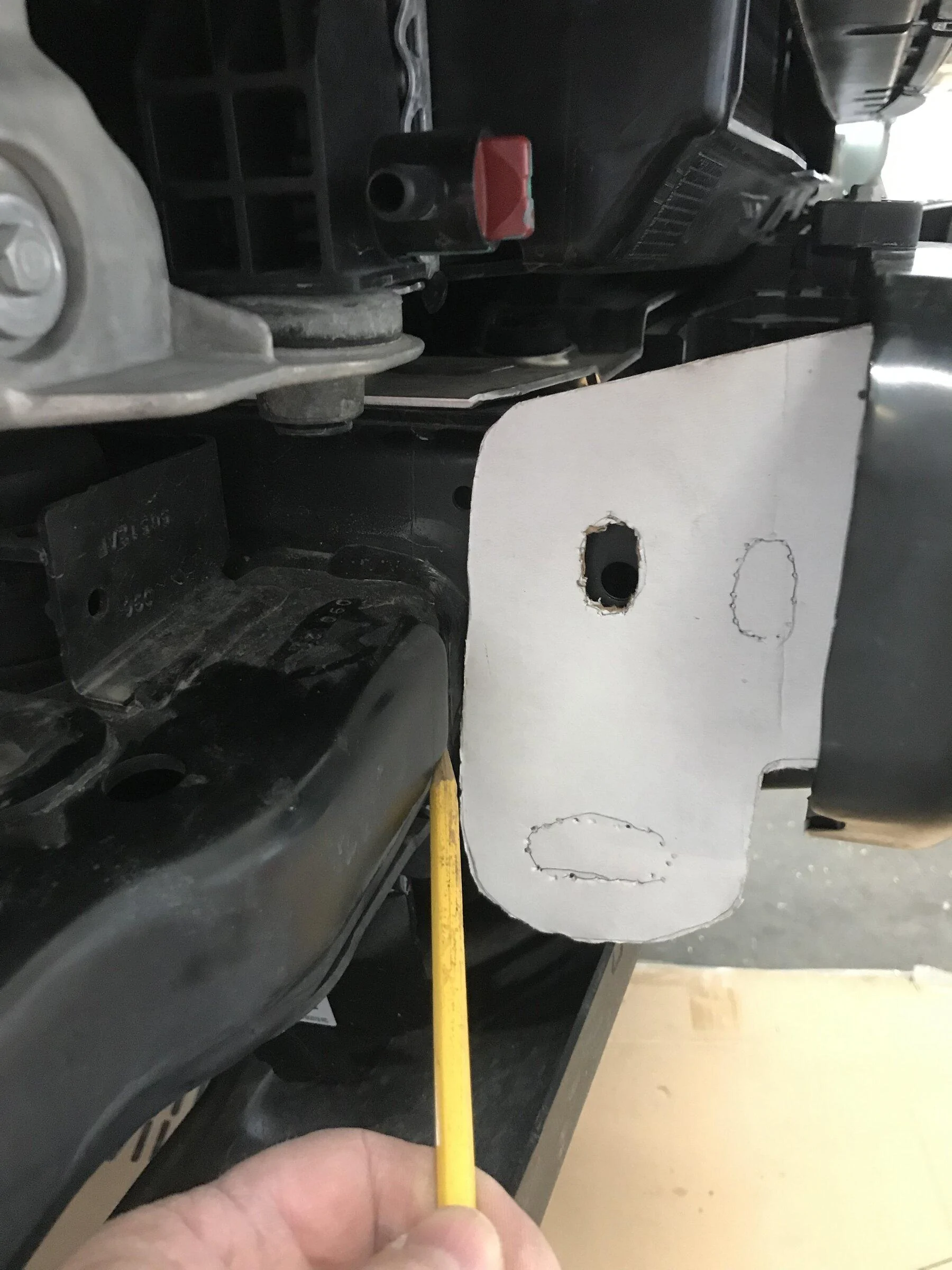

Where the pencil is pointing in these pics are 2 points of a little concern. Picture 1. pretty sure the skid plate will require a 1/2 to 1 in deep notch as wide as necessary to fit an emergency tow hook. Probably 3 inches wide would be all that is required. Without having a working copy, it is hard to tell if the bumper will need material removed. Its may touch an inner bracket in the bumper. If the bumper does require a little material removed it is just in front of where the pencil is pointing to the skid plate. But, if any material does need to be removed , it will be small and I believe I would take it off the LOD bracket.
On the rearward side of the bracket (2nd pic where pencil is pointing) there is a vertical channel on the frame. It appears that the bracket can be fit into this. But if my cardboard model is off a little then the LOD metal bracket may need just a touch of a grinder. Again, I am going to buy these brackets as I think they will work with minimal fuss.

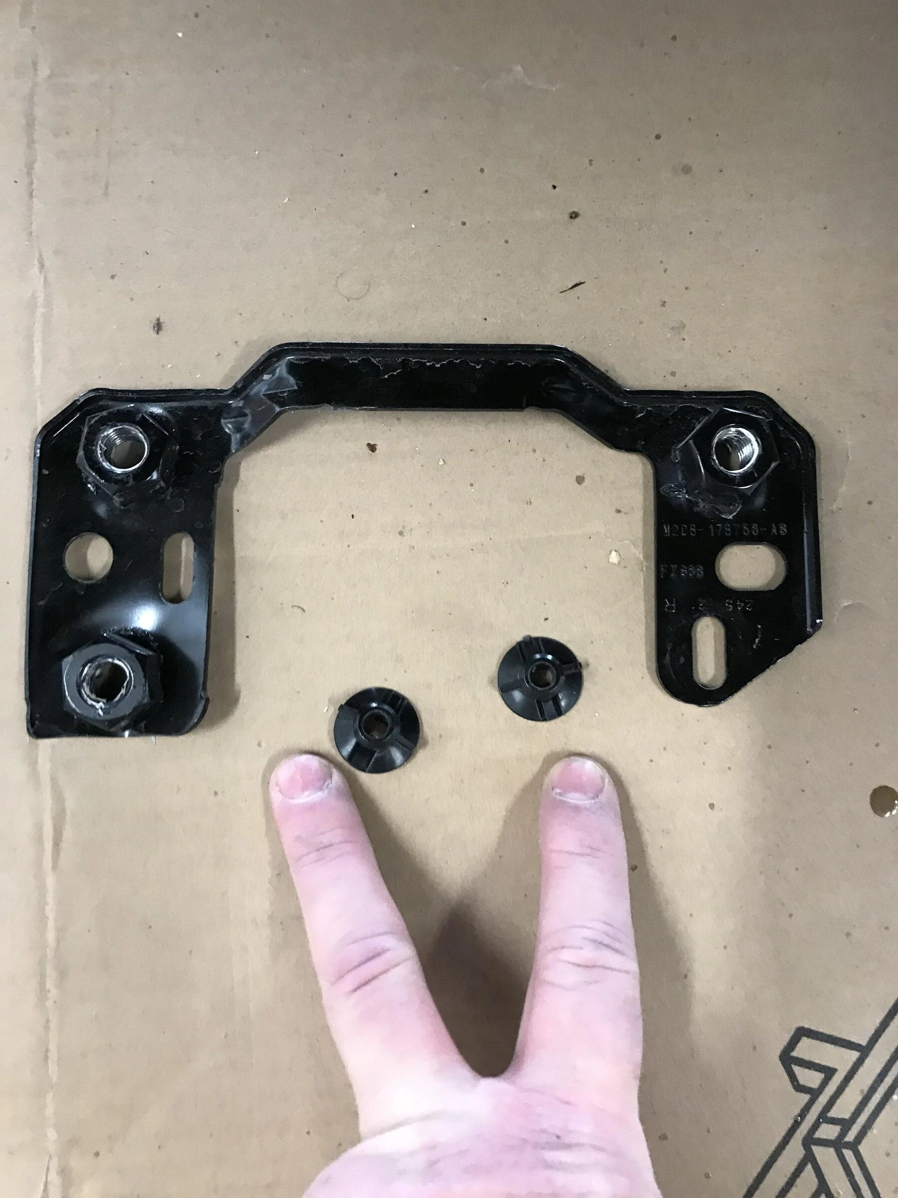

The other part in the photos show the u shaped bracket that must be taken off. The two black items are plastic thumb screws that need to be removed to take off the u-shaped piece. The LOD brackets replaces the u-shaped piece.
maybe all this is clear as mud??
Where the pencil is pointing in these pics are 2 points of a little concern. Picture 1. pretty sure the skid plate will require a 1/2 in deep notch as wide as the bracket is. Without having a working copy, it is hard to tell if the bumper will need material removed. Its may touch an inner bracket in the bumper. If the bumper does require a little material removed it is just in front of where the pencil is pointing to the skid plate. But, if any material does need to be removed , it will be small and I believe I would take it off the LOD bracket.

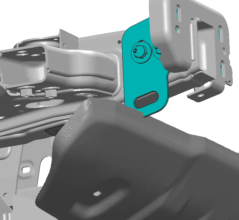

Nice Job!
I was able to get some cad to show what you suspect. Depending on all the tolerances involved, you might see the OE front skid rub the bottom of the Frame Ties. You might be able to avoid cutting the skid plate by placing a couple of "strategically placed" washers to shift it down slightly.

Very good. This is the best option I have seen for an emergency tow hook.

Just to add that if skid plate does need to be cut, it is at a point that is mostly behind the modular bumper. I just placed my order!!

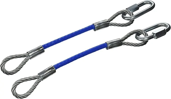

Happy,

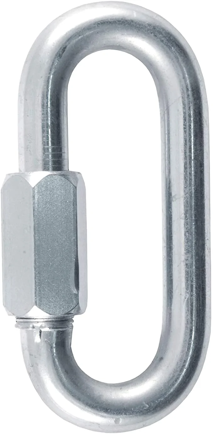

I’m planning to connect a quick link to the LOD mount, then attach a safety cable extension of the proper length to that then click the tow hook from the longer safety cable to that. It actually looks like the Roadmaster extensions come with quick link so the one in the first picture below might not be needed.
From your picture it appears the quick link might hang out far enough to attach the standard safety cable‘s hook directly to that and cable extension might not be needed.
