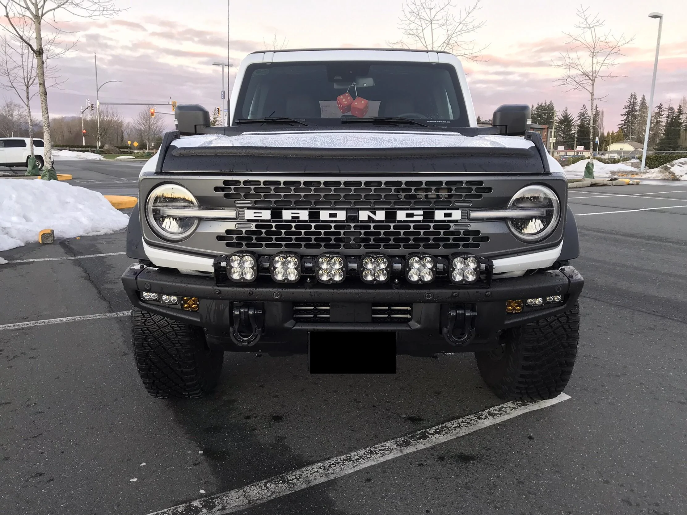

Picture of my current setup, for reference (knowing the light bar would need to go).
Thanks in advance!

As usual, extremely helpful - Thank you!
I really hope some folks have good ideas/setups for the lights. I think some round pods could look good, but I need some pictures of a Bronco with this exact setup and the lights to visualize it on how they mounted them.
Also, regarding the ACC, I noticed the below snippet from their website. It makes it sound like it will work, however I wasn't sure??
LUX Package Radar Adaptive Speed Control must be set to 'normal' using Featured settings. The radar bracket is behind the winch, a driver message "Adaptive Cruise Not Available Sensor Blocked" will be present. Customers desiring a Winch can change Cruise preferences Press Driver Assistance select Cruise Control select Normal. A radar re-location bracket is not available.

So nobody has or has seen a good setup of AUX lights on this "safari bar" in front of the winch? :unsure: I find it odd considering so many folks have this winch setup, or something similar with a bar like that.
Even if you have a smaller light bar attached to this, I'd be interested to know the size and how you mounted it.

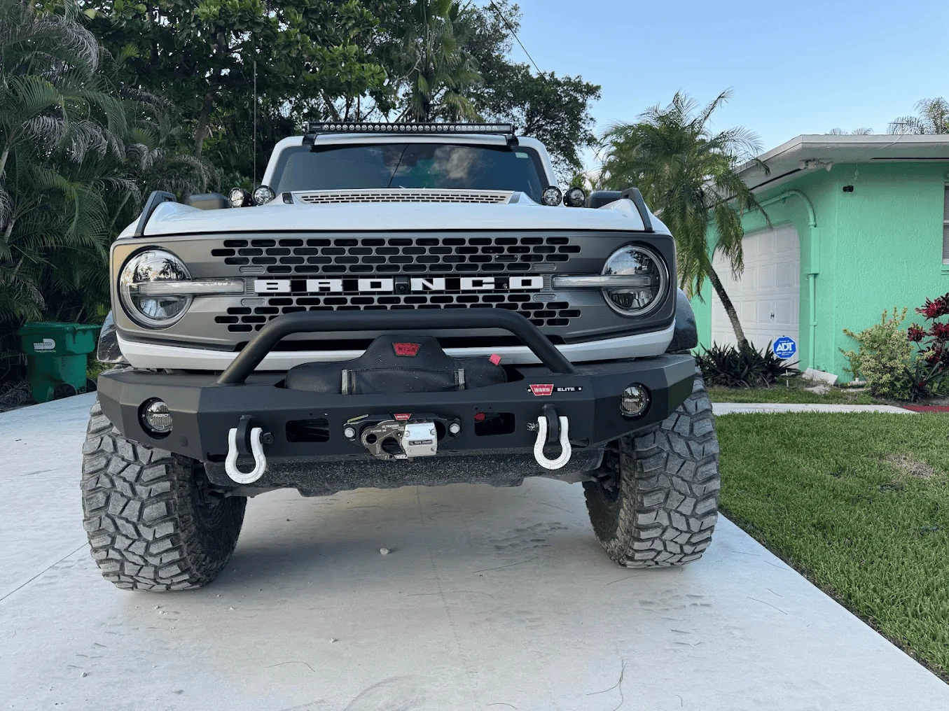

To what you are speaking about, I have a Warn Winch setup, in a Warn Bumper. I used an ACC relocate for it, I think a DV8 ??? and my camera is not really blocked. For lights, well I have rigid pod ditch, and the rigid light bar hooked up to the aux switches.
Where you see the 3 silver nuts behind the grill is where my ACC is now. My ACC works fine btw.
Ford Bronco Ford Performance Winch Kit + Lights 1700785481396

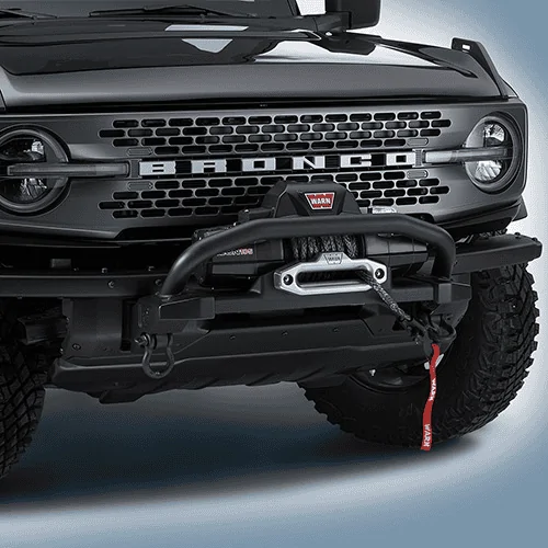

Someone with connections need to ask Ford(or Ford Performance) why they show their winch kit with provisions for the relocation of the front camera, 2 parking aid sensors, and ACC unit on Ford Performance by Factor 55 "Red" Ultrahook pictures on the Ford Performance website???
