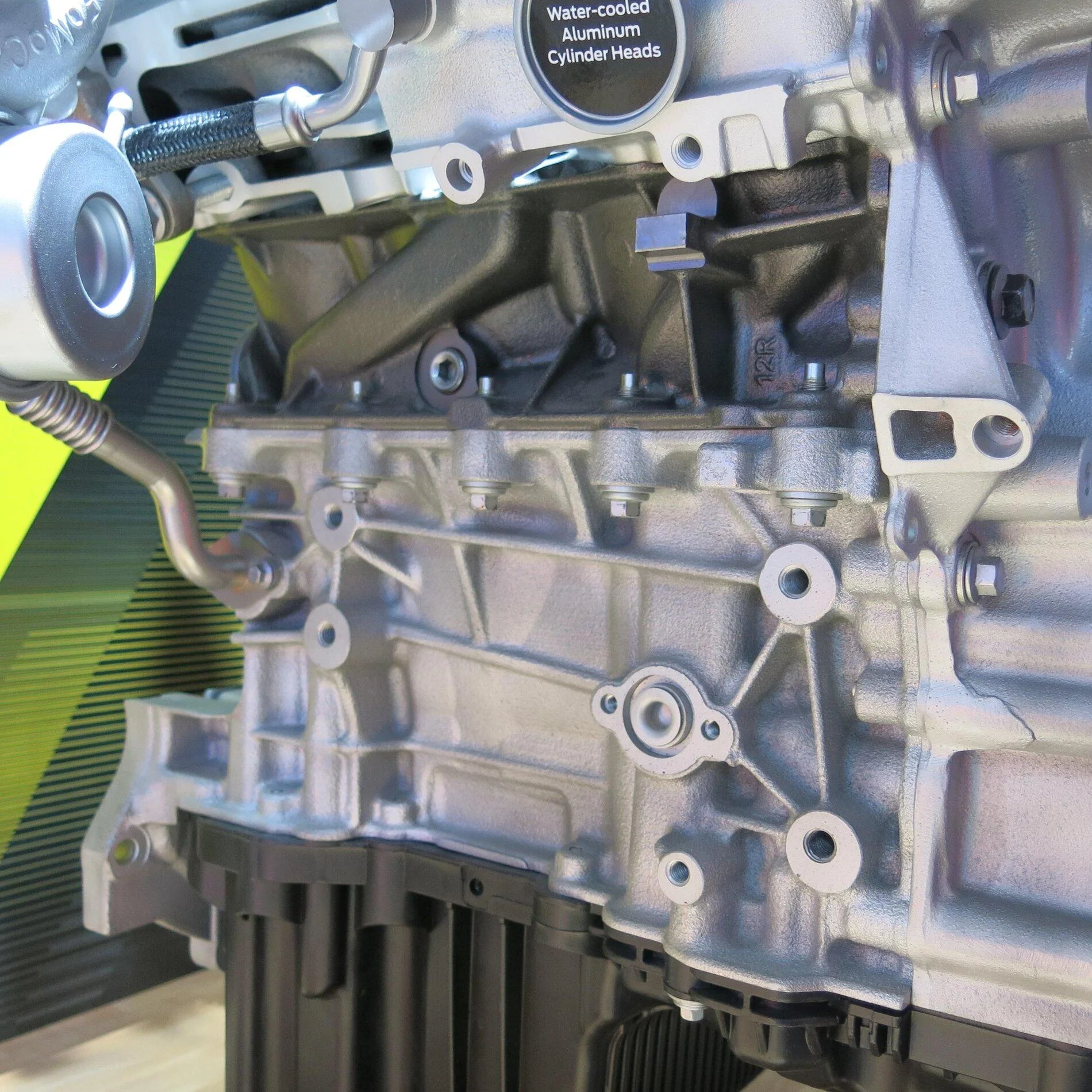

Water cooled exhaust manifolds? What's the reasoning for those?.... I'd figure more heat for the turbos would be beneficial. Unless they do it for durability reasons.
I'm not crazy about the Integrated Front Cover... is the water pump replaceable? Hope I don't have to deal with crazy maint costs 20 years from now.
Anybody know what boost levels these run at? Think I saw 15-ish. Wonder how much they can take.
Not sure of the reasons for the water cooled exhaust manifolds... but cooler air is better for the turbos as it's more dense.
mneblett posted a link to an article which stated the water cooled exhaust manifolds gets the engine up to operating temp quicker, increasing efficiency/gas mileage.
It also makes the engine more compact and lighter.....it doesn't need heavy cast iron exhaust manifolds. A downside is we can't put headers on it to improve breathing and performance.
The writer is confused on his statement:
>>"Also, the exhaust gases exit the turbo at a lower temperature, then they travel through the intercooler and the temperature drops even more. By the time they reach the intake manifold, the air is denser, which means improved efficiency and more power."<<
Um, actually, it's not the exhaust gasses that travel thru the intercooler..... it's the intake charge on the 'other' side of the turbo.
Cool, dense air is beneficial on the intake/compressor side. For the exhaust/turbine side you want hot air.... it's less dense and has a higher volume which is what makes the turbo turbine spin.
