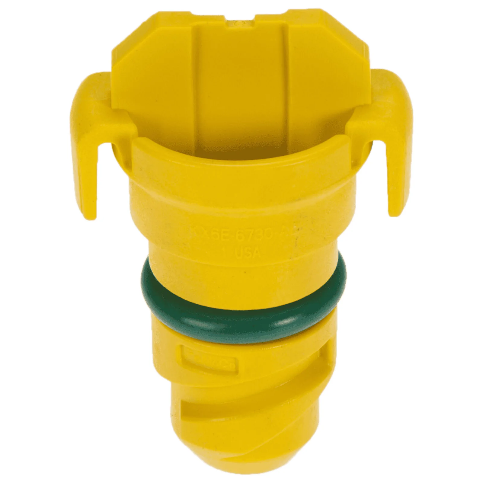

Just curious if the drain plug and threads are plastic on plastic or steel on steel thread insert in the plastic pan . Also regarding water pump can you just replace the pump or does the whole IFC cover have to be replaced ?
It's a plastic plug that turns 90degrees and then releases a deluge of dirty oil at you if you're not careful! ? It is way easier to use then a traditional steel oil pan drain plug that you need a wrench for... (I have actually replaced several traditional ones with Fumoto drain plugs in other vehicles I have owned) This one is similar in ease of use... I am curious about having to remove a skid plate to do this or if there will be an access hole to do oil changes...

That’s a first edition drain plug. All others are black.
Not true. That is the current generation of plugs. The first generation had a 3/8 square hole in the end so you could use a ratchet to remove the plug, but the front sway bar made it tough to get a ratchet in there if you had the heavy duty front sway bar with the towing package. The one pictured is the one that comes on the current gen. It says not to use tools on it, but it's a pain to get it out due to the placement of the front sway bar, so using a pair of pliers is necessary to get it off the last 1/4 turn. Ford also recommends changing out this plug every oil change, however I never swapped mine out on either truck and it's held up just fine. I do however have a few spares in the shop and in the truck, just in case.
