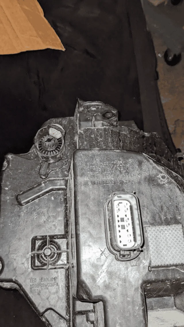

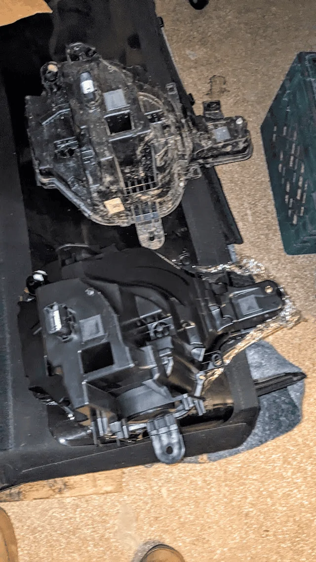

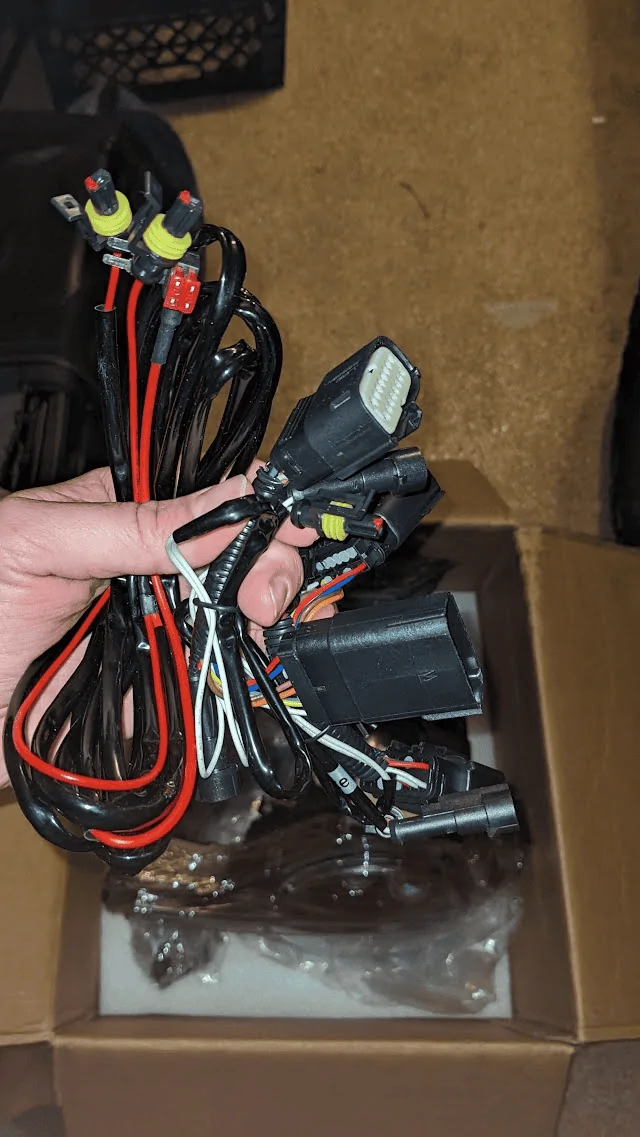

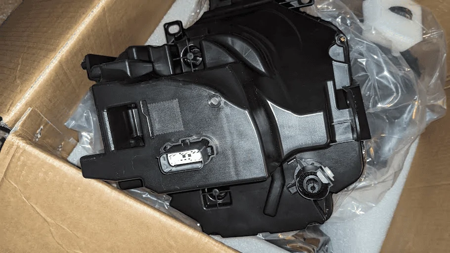

These are the first aftermarket headlights I have handled that look factory! Supplied wiring is on par with with factory and well sorted. Really if you put them in a factory box I would have been sold. The adjusters look the same, the connectors are similar style and the are even the same weight! This is the first time I haven't had to modify the headlights with silicone or drill out holes. FYI my last set of $1800 ram factory replacements where not even this nice. Fit was tight and solid without any feeling of flimsy. No issues adjusting the lights in 5 minutes and if you install the DLR wiring to a switch you can play with the light up feature!
Form vs Factory Adjuster

Very much factory quality!

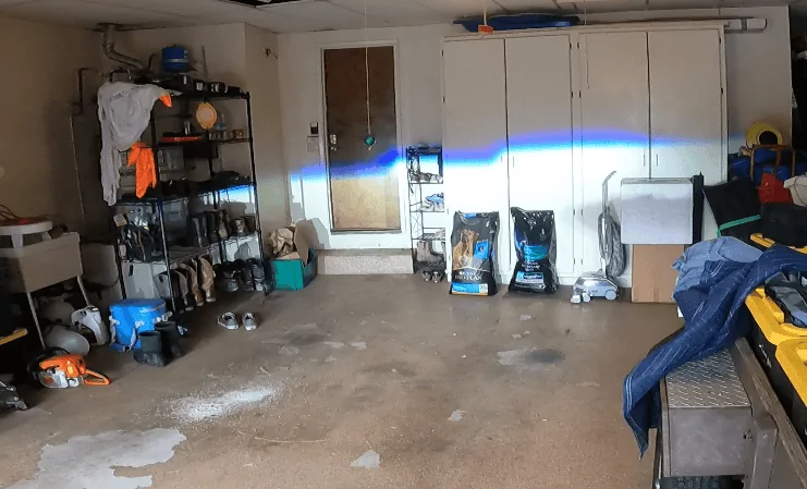

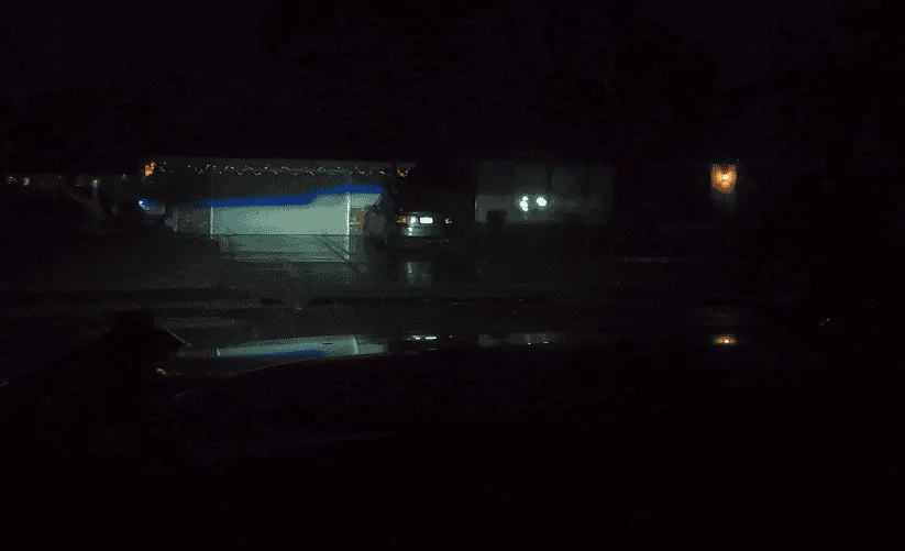

Lighting issues is the blue hue cut off line. Not as crisp as I would like for this kind of money. This is really the only negative, which I can live and maybe forget about here shortly.
Ford Bronco FORM Projector Headlight Review (Diode Dynamics) 1704304659706
Same issue during the day, you can see the hue. These lights also have a step between bulbs, you can see how to properly set them slowly stepping up.

Thanks for the review man, the blue tinge is a bit much for my taste as well, otherwise they look amazing!

Well I should post a little more since I hit the road at 3am this morning. The Form lights do put out a lot more light than factory it is just not noticeable if you aren't looking for it. The light is just a narrow band so more like a flat plane. Definitely a massive improvement in forward side light on a flat road. Think a narrow band ditch light. Your not getting a bigger picture but the extra light helps with seeing objects better(road gators and boxes).
Going to readjust the light pattern a little more as my passenger side is to high. The hue line is right in people's mirrors on the drivers side and really gets people. You can see them wince when they pass. Blue hue is not noticeable driving in the fog and beam pattern works well with fog.

Con: They have a blueish component at the cut-off (blueish light). It looks purple/blue on the road (Alpharex are the same way)
