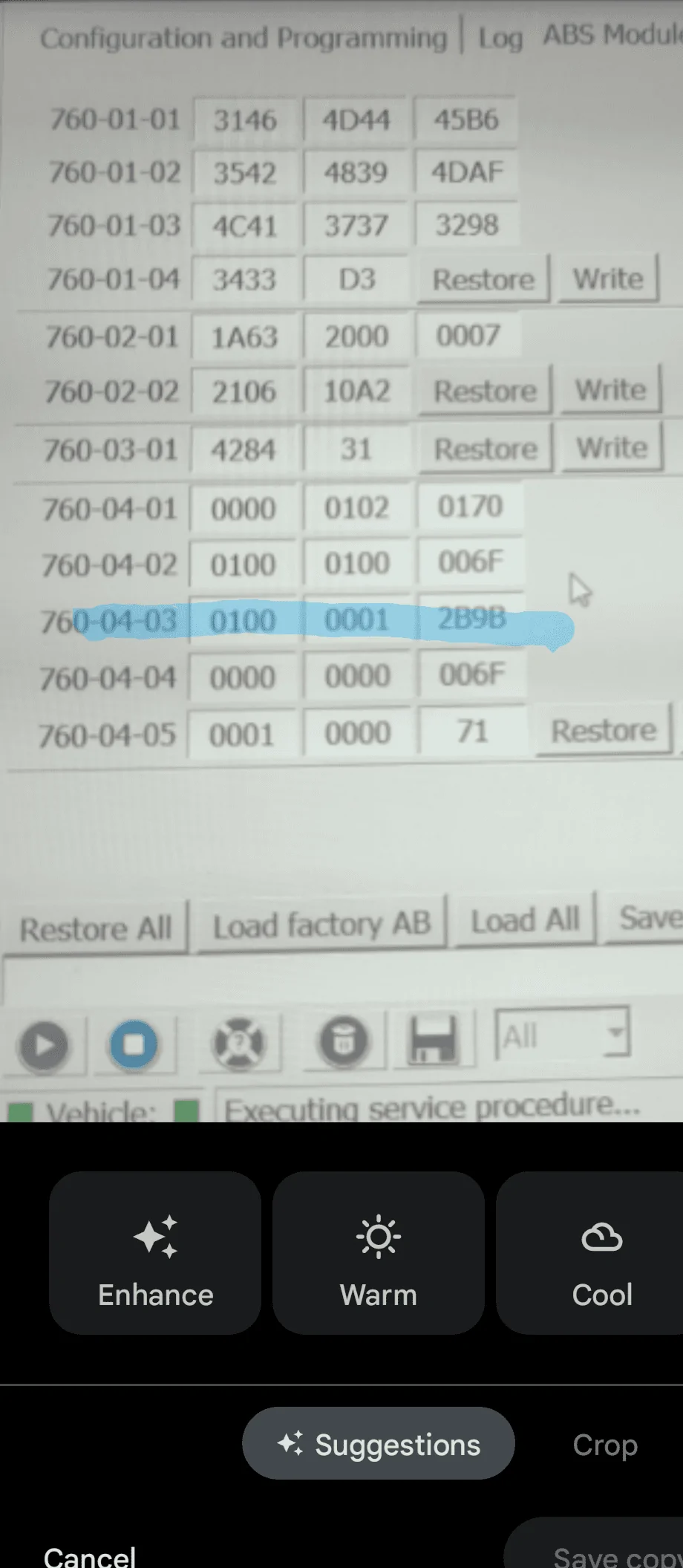

My Parking Brake indicator does not illuminate any more when activated, but does illuminate on initial startup/key on during the dash light test. Any ideas where I can re-enable this??

I have base model and added goat modes through my abs module and got an error message aboute brakes when I wrote the change.
No error on dash or dummy lights but my cruise control will not engage now, it turns out I saved my bronco profile but did not save the abs module so I cannot roll it back.
I did screenshot all values before making the original change and moved all values back to stock but cruise still won't work.
To add all goat modes I changed the line to
760-04-03 0100 0203 AB9b
After I write it and go back in to look it reads
0100 0203 AB1F
Anyone have an ABS module for a base 2.3?
Any advice on this this?
0100 0203 AB1F
any update on this? I just added Baja to my BD tonight and got the same brake error message upon writing. I haven’t tried cruise control since, as I just found your post. I’ll give it a try tomorro…
