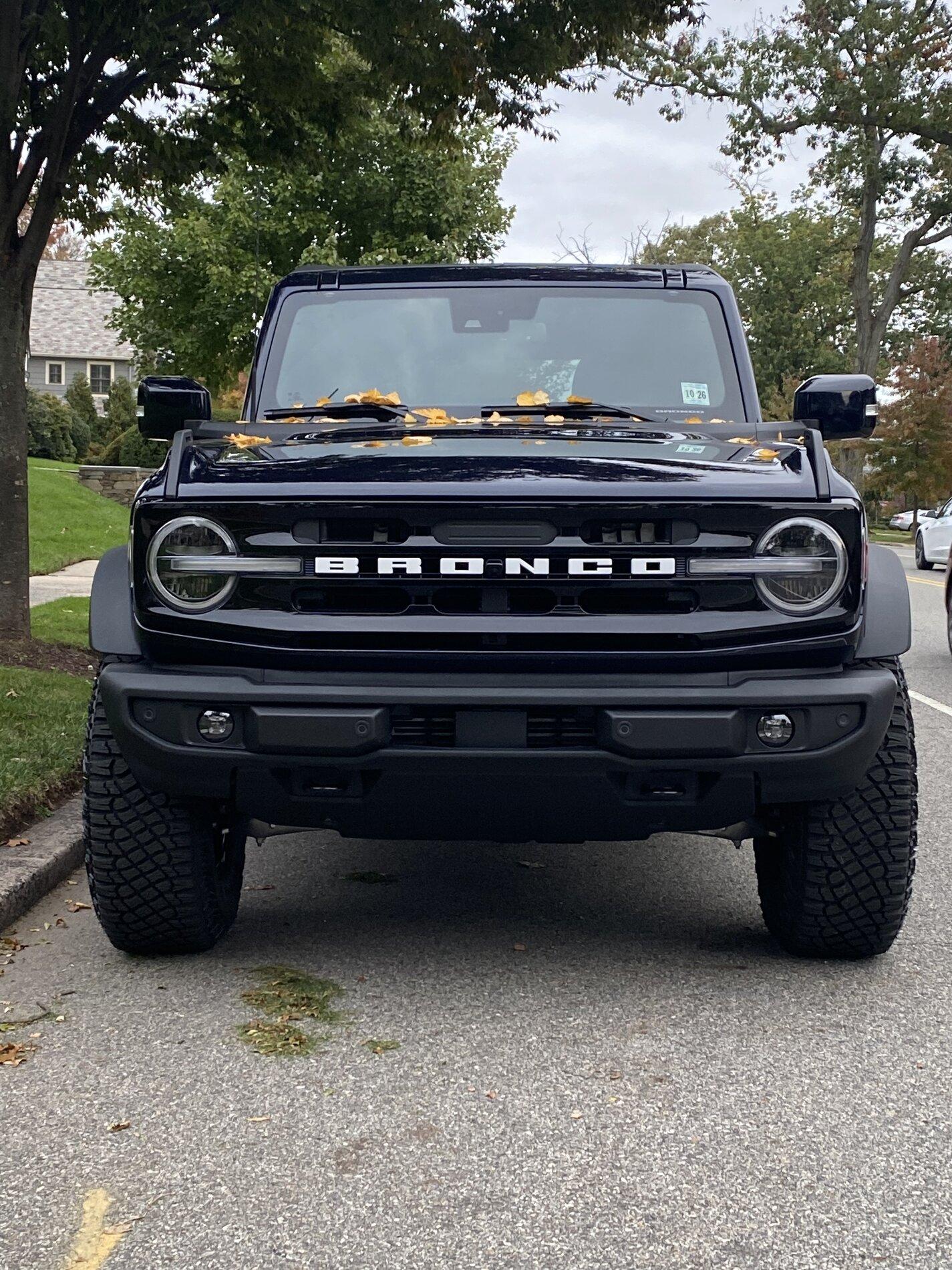

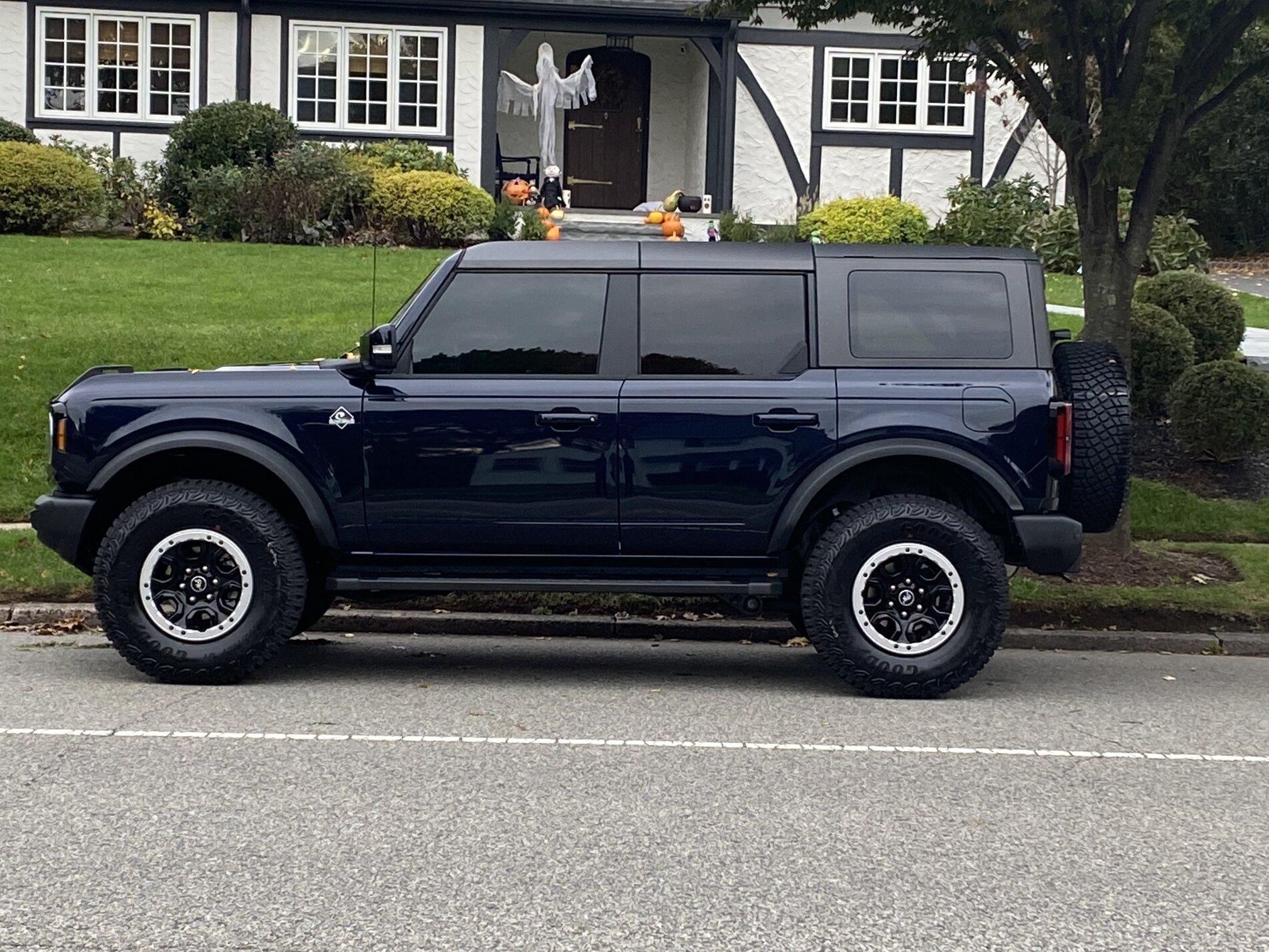

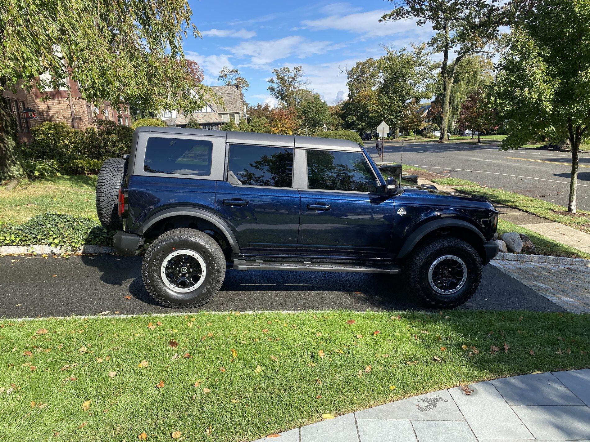

IMO sas flares are welcomed over the painted flares until Ford brings on the painted mod top.
When they dropped the mod top, that was the last straw that had me switch from a non sas OBX…with painted fenders and gloss black top with aftermarket lift/wheels/tires…to simply get a Sasquatched OBX and use the flares to tie in the MIC top. Otherwise the MIC top would look cheapened when paired up with an all painted body and flares. Like you got an upscale loaded Sahara but cheaped out on the unpainted top… Plus the sas flares are even bigger to accent the MIC top…Hell it even forced my hand to drop the steel bumper and get the standard bumper too to tie it all together.
at least that was my rationale and how I pivoted my build through the loss of the mod top. The fenders were part of the equation. I was no longer interested in an all-painted look if the MIC top was the only hardtop choice available.
Back on topic - Really happy I picked OBX sas over Wildtrak now that I could get back Baja mode. My immediate thought was how much is a forscan lol because I paid up $200 over a identically equipped Wildtrak and lost Baja mode. so guess I’m now about $350 in the hole adjusted with the purchase of a forscan haha.
