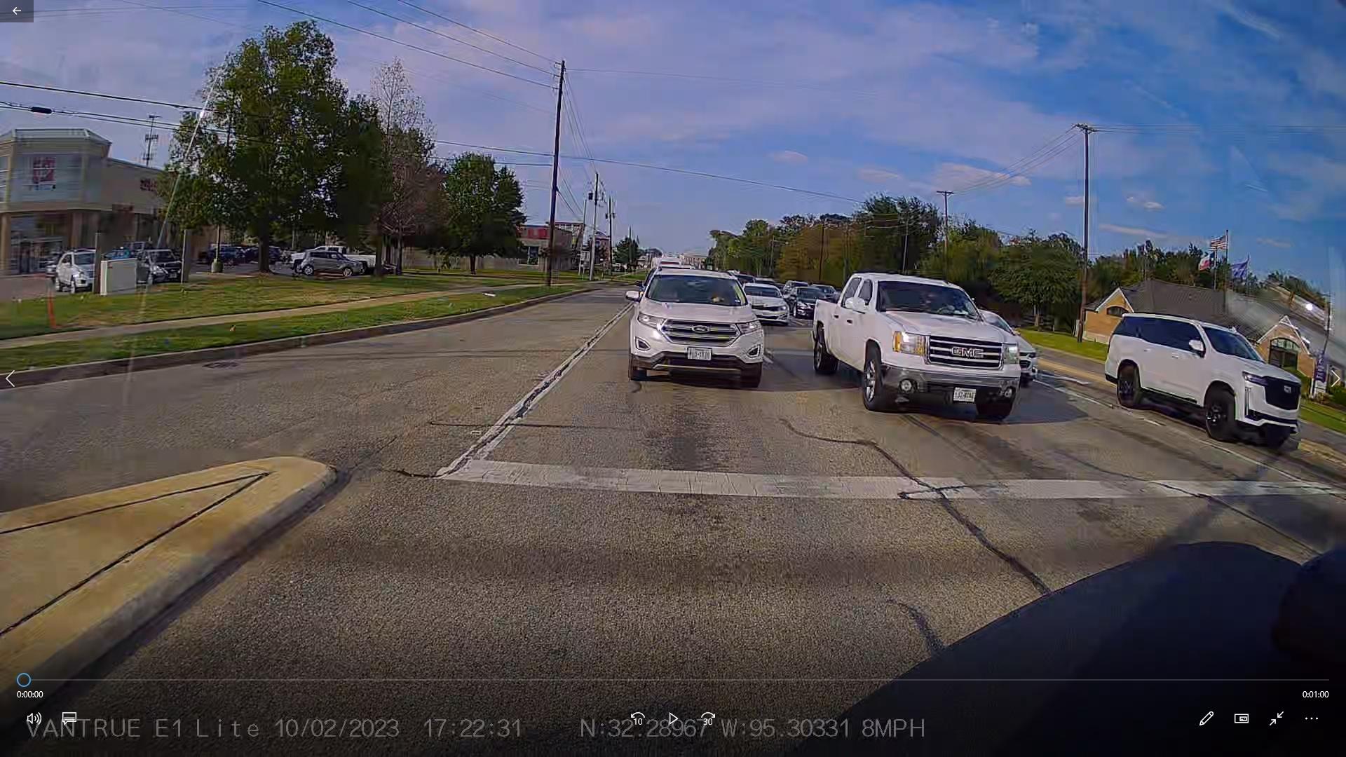

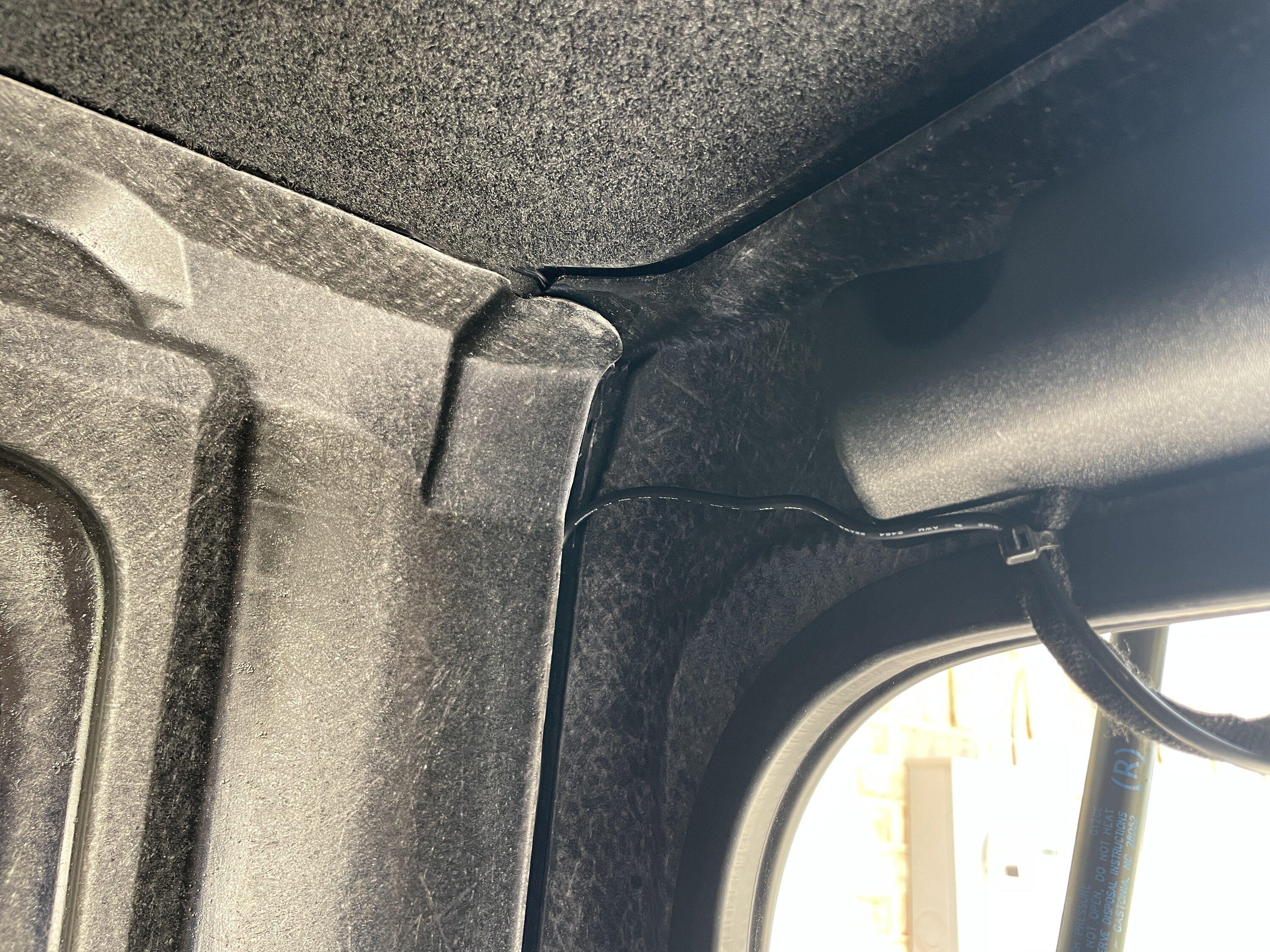

Installed two separate dash cams, one in front and one in rear window. (I didn't want to use the Dual Dashcam and have to run a wire from the front camera to the rear camera) I used the Vantrue E1 and E1 Lite because they are pretty small but still have a good picture. To power the front camera and not to have to run a wire down the A-Pilars I used a rearview mirror adapter made by DongarTech. Links to everything are listed below. For the rear camera I connected the included 12-volt power adapter to the Bronco’s rear auxiliary power outlet. I was able to hide most of the power wire by tucking it in or zip tying it to the rear defrost cable. The rear window opens and closes just fine with the camera mounted. The front camera shuts off when the vehicle is shut off but the rear camera stays on about an hour after I turn the ignition off. Not a problem though really.
