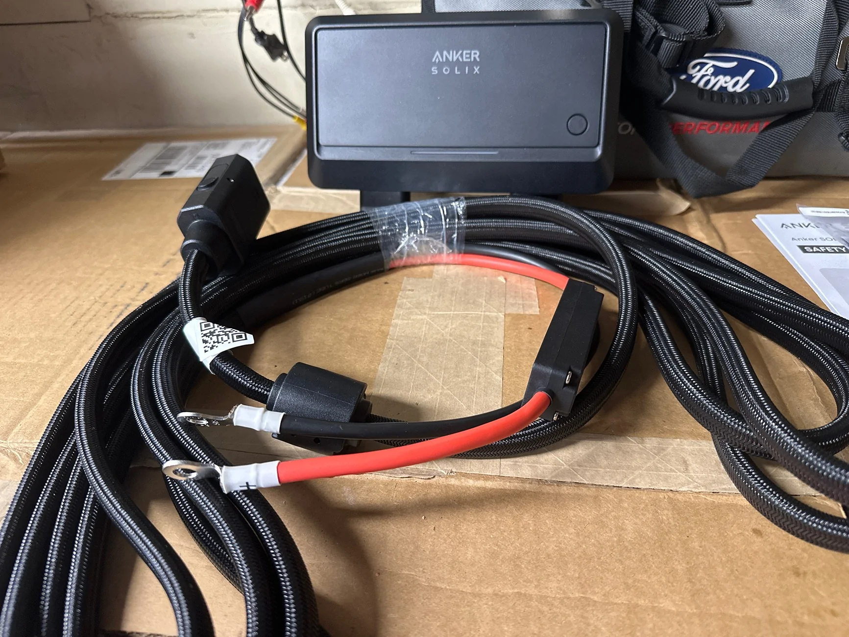

But yeah, I'm looking for a trick set of cables, probably #4. Something like in the picture. Im also fine with just building my own. Easy enough to put wires in a loom, I would need to buy a crimp tool and it might be cheaper to go premade.
