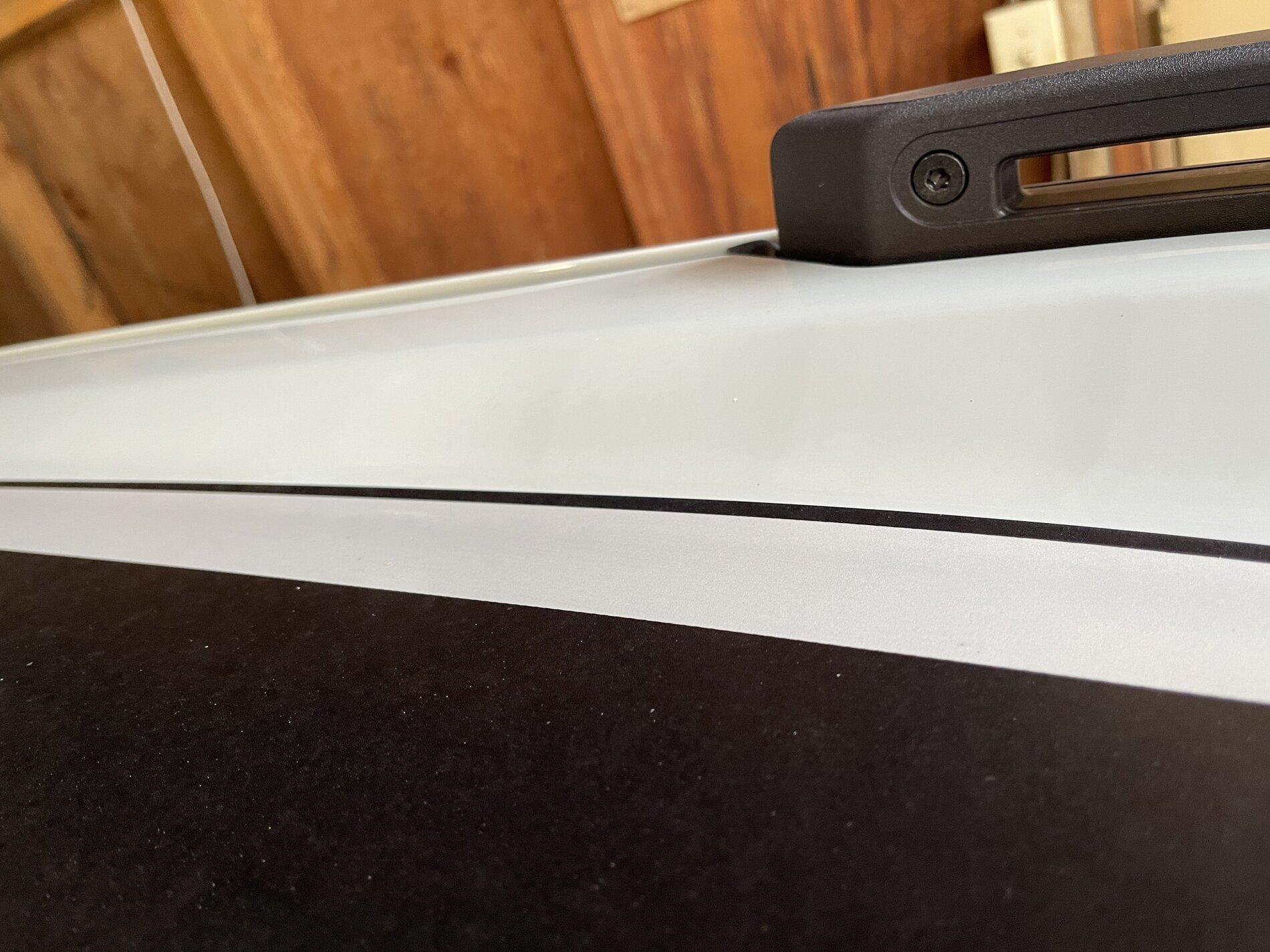

did it cast a shadow like that? I am going to check a few hundred out to see if that is design or adjustment.
That's not a shadow, it's the inner edge of the fender.
Seeing a couple hundred won’t indicate if it’s an assembly or design issue. Just because it hasn’t been happening doesn’t mean it’s not supposed to be that way.
Basically, if possible it should be level/aligned.

it may have been designed to have a step in it is what I am saying. I never noticed this before..that's why looking at several hundred will show me consistency or not. Other than just asking the design engineer.

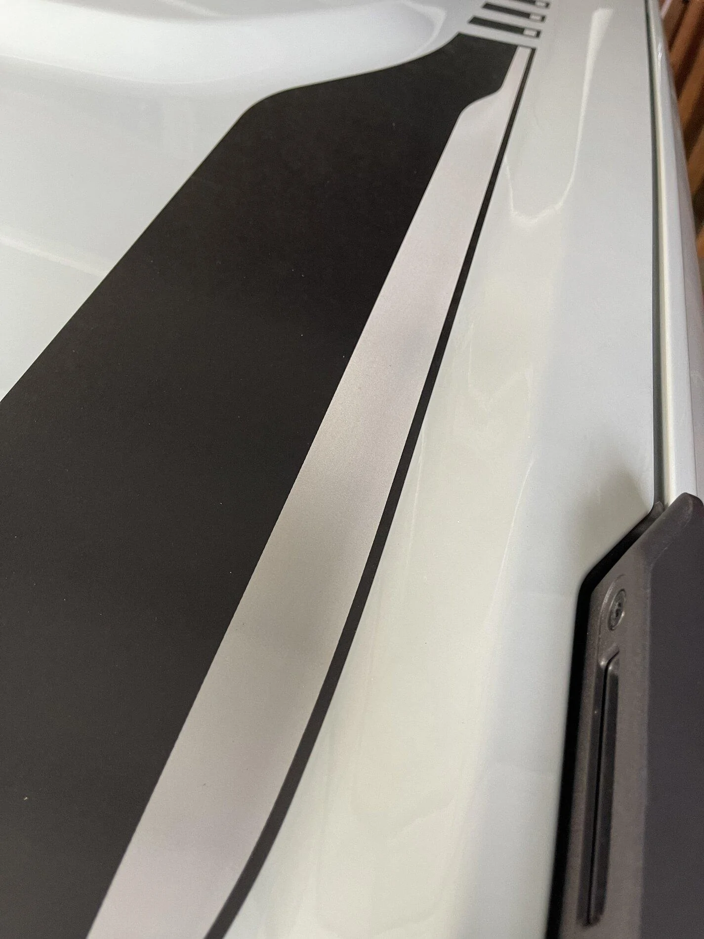

Mine is identical to this. It was also a concern and I verified with others a week ago. There's is the same.
You may want to check the rubber topped adjustable hood stops (when you open the hood). Mine were too easy to adjust and were also a bit too high. They are very easy to bump and make them higher. This could bend the hood. Dangerous.
Additionally....I do think this is intentional. If you raised the hood to be flush with the top of the fenders, the gap between the hood and front grille would be too large in my opinion.

The trail sights tend to mask this, since you can't see the corner. I only really noticed it when I ran my finger down the seams. Purposeful or not IDK if it will bother me long term.
sure but consistent would be more satisfying to me. in my mind anyway.

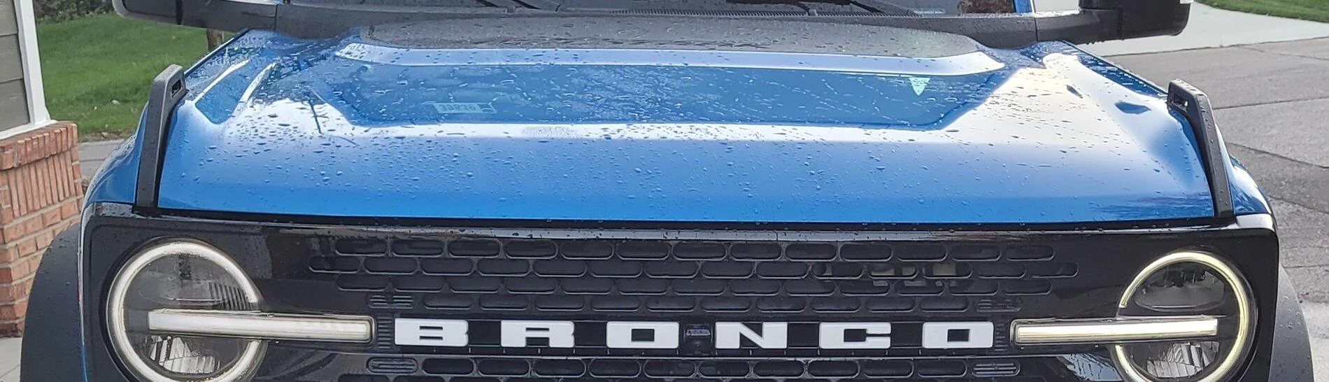

My opinions... I had the opportunity to enjoy a Wildtak for 24hrs. I looked at the hood "issue" on this one and what I see looks to be design intent as to fender to hood. There are 2 main things to look for to describe what one sees as a potential problem, flushness and margins. If the margins/gaps are aligned and even left to right then you have to determine if hood to fender is supposed to be flush or does if follow a curve or crown. Looking at other areas where features come together at other points like at the grill, sights, hood and fenders, look for a continuous line. Look at the areas from different angles to help judge. Uneven lighting and shadows can make it difficult. Regardless of what you want to see or think you should see, it might not be how it is designed.
For Quality Control there can be a human factor if it is left up to the operator/fitter to check and adjust if needed. From shift to shift there can be those, managers & operators alike, that feel they know better and finesse things to their liking and not to a spec. Feedback from the customers help to correct if there is an operator or build issue and serve to improve future design and build processes to lessen the human factor.
Side note: nothing to do with any of this and is not a reason for the water on the vehicle, the front camera washer has a powerful spray. Don't stand too close...
