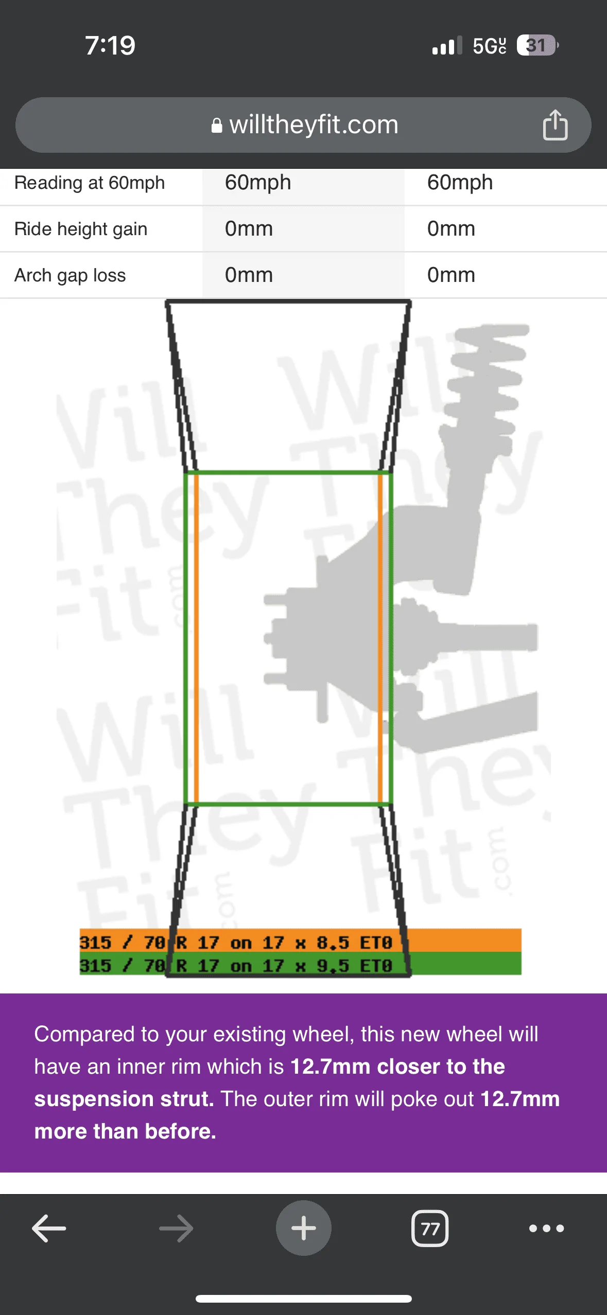

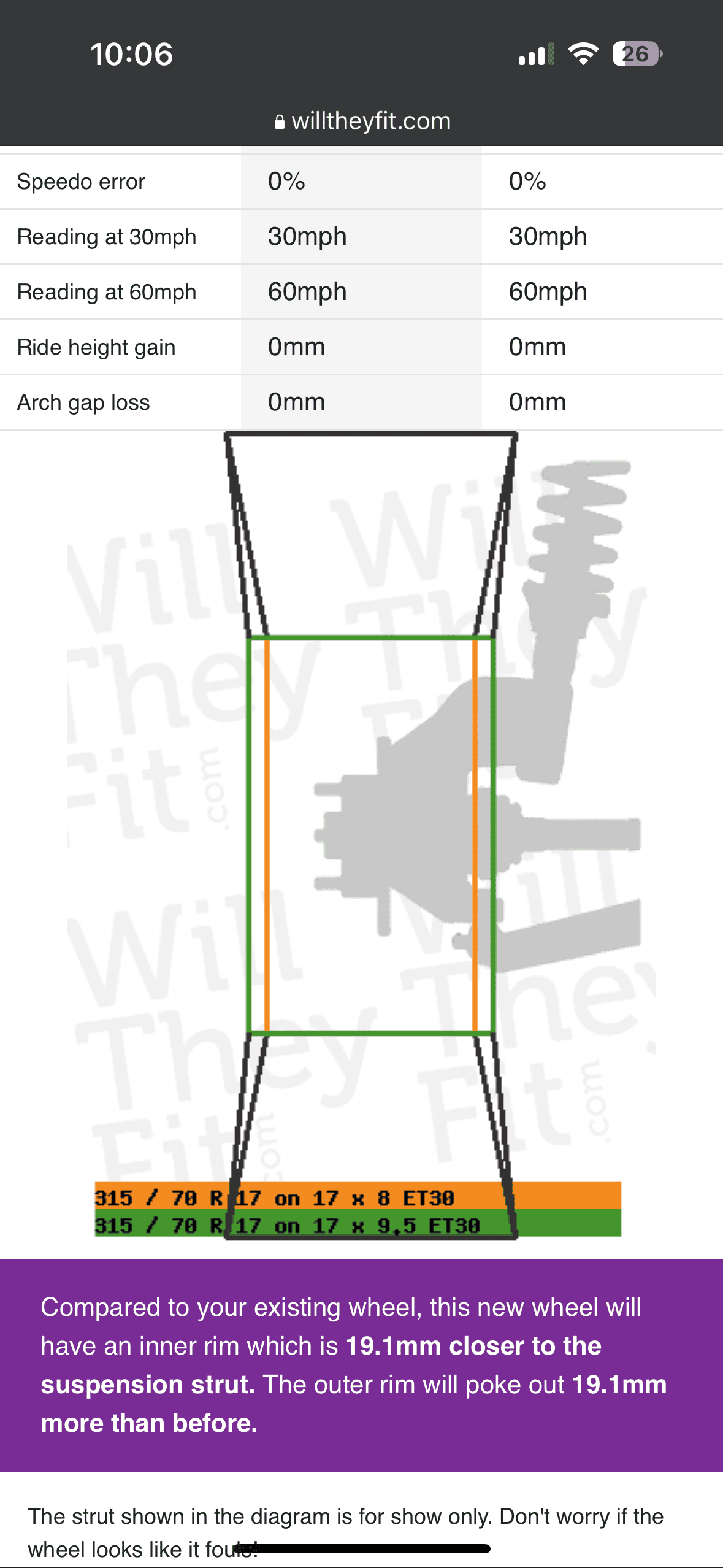

The wheel width does matter as much as the offset. A 9.5 inch wheel with a 0 offset would result in poke and inset that’s nearly 1/2 inch more on both inner and outer. That would definitely affect the probability of rubbing. Now with a 9” wheel is more like a little less than a quarter inch but overall I’m just saying that it does make a difference especially when going with larger tires. I put 37’s on the stock wheels, no lift, and I literally only have a half inch, if that, of clearance.
So, is the rubbing *ever* wheel-on-strut?
Or is it tire-on-X (e.g. wheel well, crash bar mount, etc)?
I ask because I have seen a lot of people talking about tire-on-X rub, but I have never once seen wheel-on-strut issue. Maybe I’m wrong about that, but I haven’t seen it.
And if I’m right about that, what difference would wheel width make at all? Even an 8” vs 9.5” wheel would have no impact. The tire is a full 3-4” wider than the wheel, if you’re talking about typical “big” tires.
And in same way, wheel width doesn’t affect poke at all either — Because the wheel sits entirely within the width of the tire, with plenty of room to spare.
someone please correct me if I’m wrong.
derichio02
Bo
Apr 25, 2022
858
545
Southern California
Bronco Raptor, Bronco Wildtrak, Maverick, Tesla M3
You’re right here. The tire is definitely the first thing that will hit with oversized tires and tire-on-X is the most prominent issue with bronco’s. If it’s wheel on strut something is very wrong lol, strut is behind the knuckle.
I was speaking more in general rather than Bronco specific. It’s honestly a combination of both and depends on the vehicle. If your wheel or tire is big enough(or small enough)with the incorrect offset and width you could run into issues with hitting the UCA(did that on my first Tesla since the UCA sits inside the wheel). Think of your stock non-sas wheel for instance. It has a +55 offset and if you were to put too wide of a wheel with that offset it may hit the knuckle or UCA without even a tire mounted.
As far as poke, wheel width does matter with how much the tire will extend beyond the wheel. Check out willtheyfit website put a 255 tire on a 9 inch wheel and it’s pretty much square with no tire poke. Do the same with a 315 and you see the tire extending beyond the wheel. For our bronco’s running big tires this doesn’t matter as much but I was referencing the overall width/offset for all vehicles.
Overall It’s really a combination of both offset and width, an 8” wheel and a 9.5 inch wheel with the same offset occupy different spaces. Pic below shows how even the tires while they overall reach the same maximum point they do occupy different spaces near the wheel. On some vehicles that may cause issues.

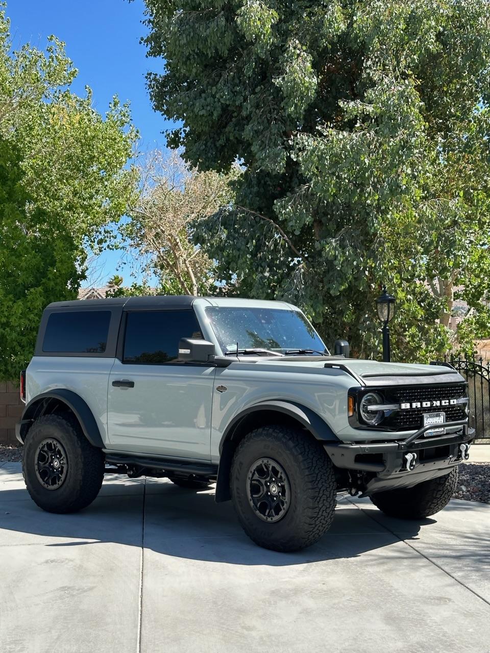

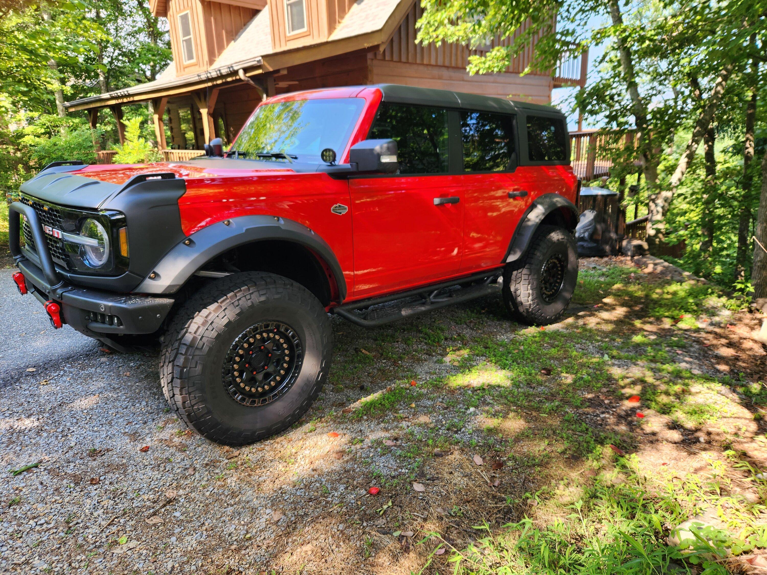

I am using an 8 1/2" wheel mde by black Rhino w0 offset or you can use the Wildtrack wheels with 1.25" Bora spacer, which gets you the same thing. Rides beautiful, no rubbing. My wife's favorite go to vehicle when riding somewhere together now.

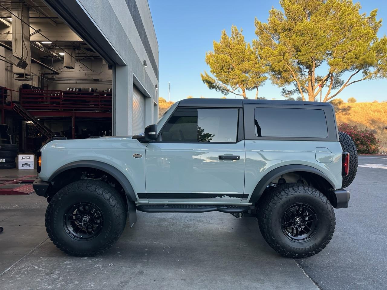

I went with RTR’s 17x9 +0 and 37” KO2’s no rubbing with RPG 2.25 collars.
As far as convincing, there should be a lot of labor day sales, would she be more incline with “hey I’m going to do this at one point, but if I do it now I save X amount of dollars!” She may be inclined with a great sale. You can even do it in progression, 37” KO2’s fit on the stock wheels no spacer, with no rubbing on the street.
37” BFG’s on stock wheels
Ford Bronco HOSS 3.0 Lift options? IMG_1150
37” BFG’s on RTR 17x9 +0 with RPG Collars

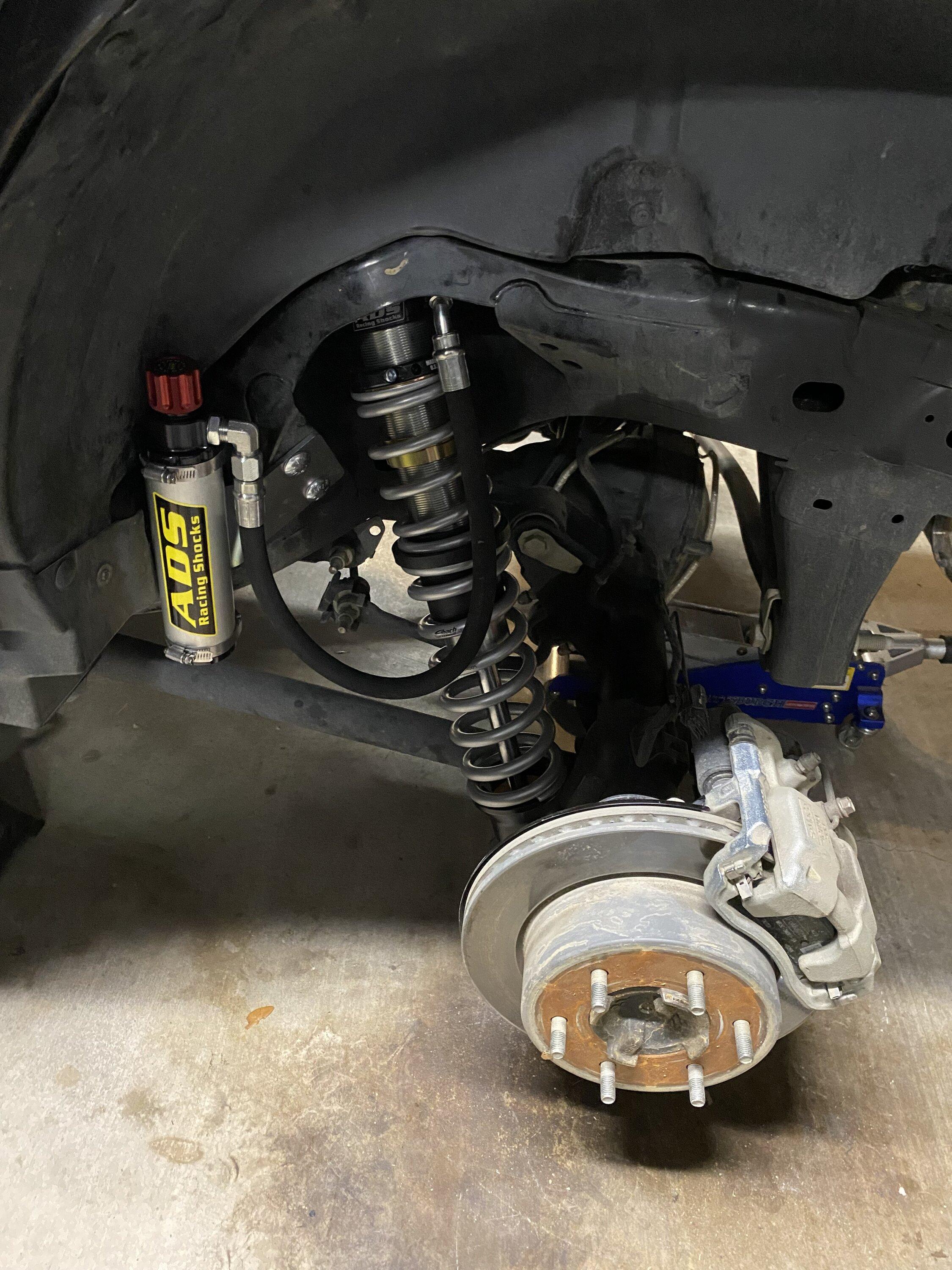

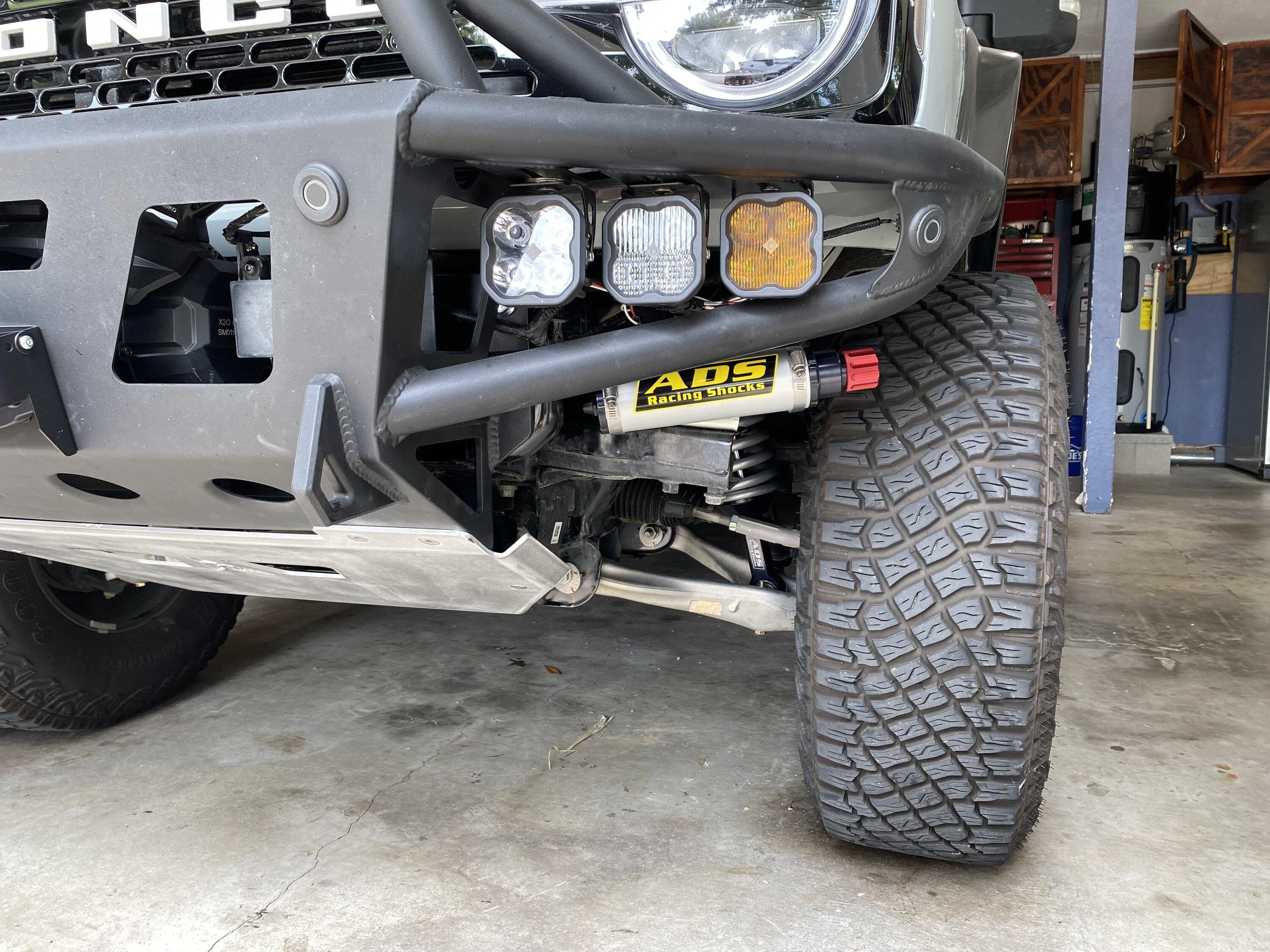

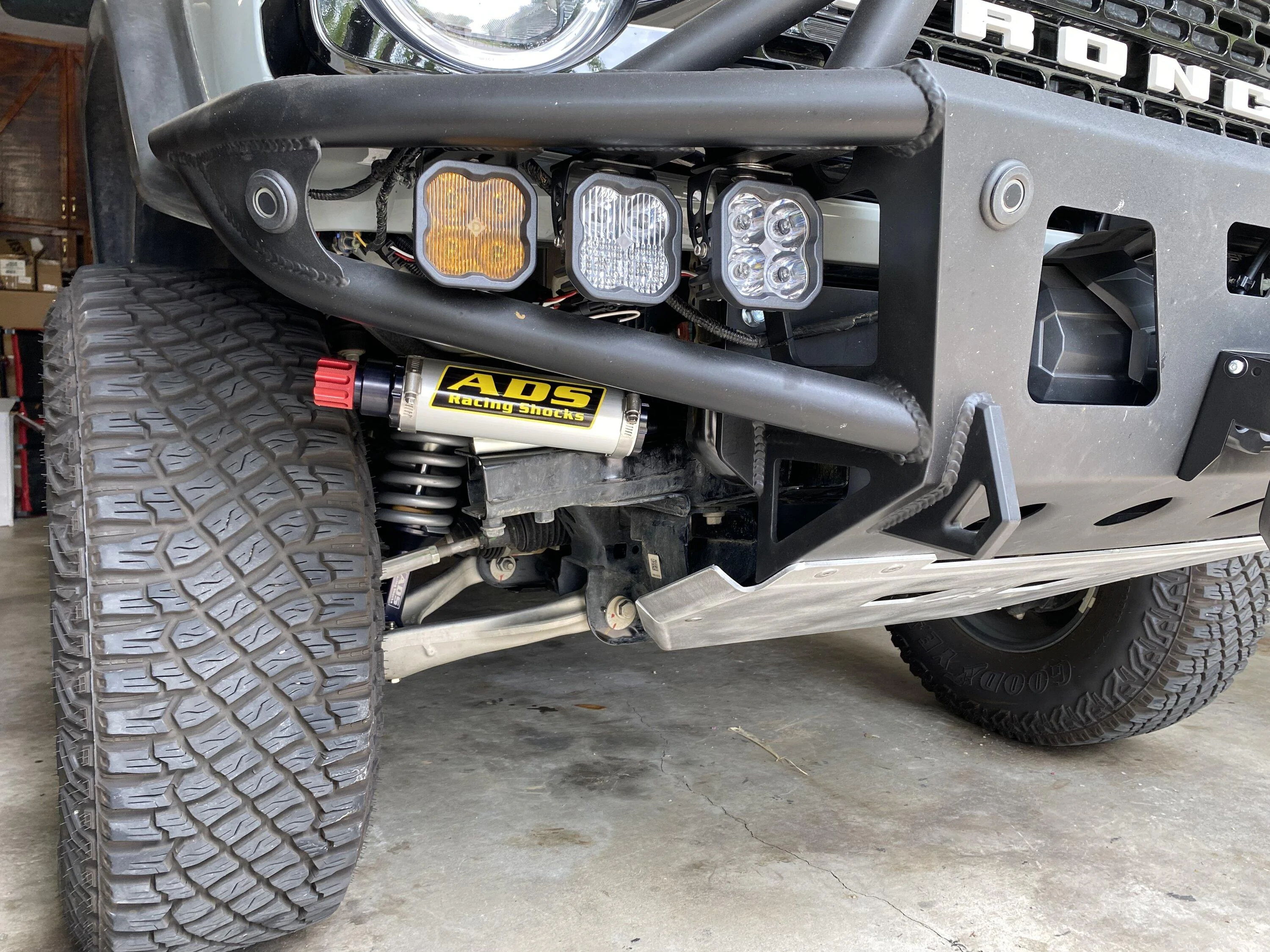

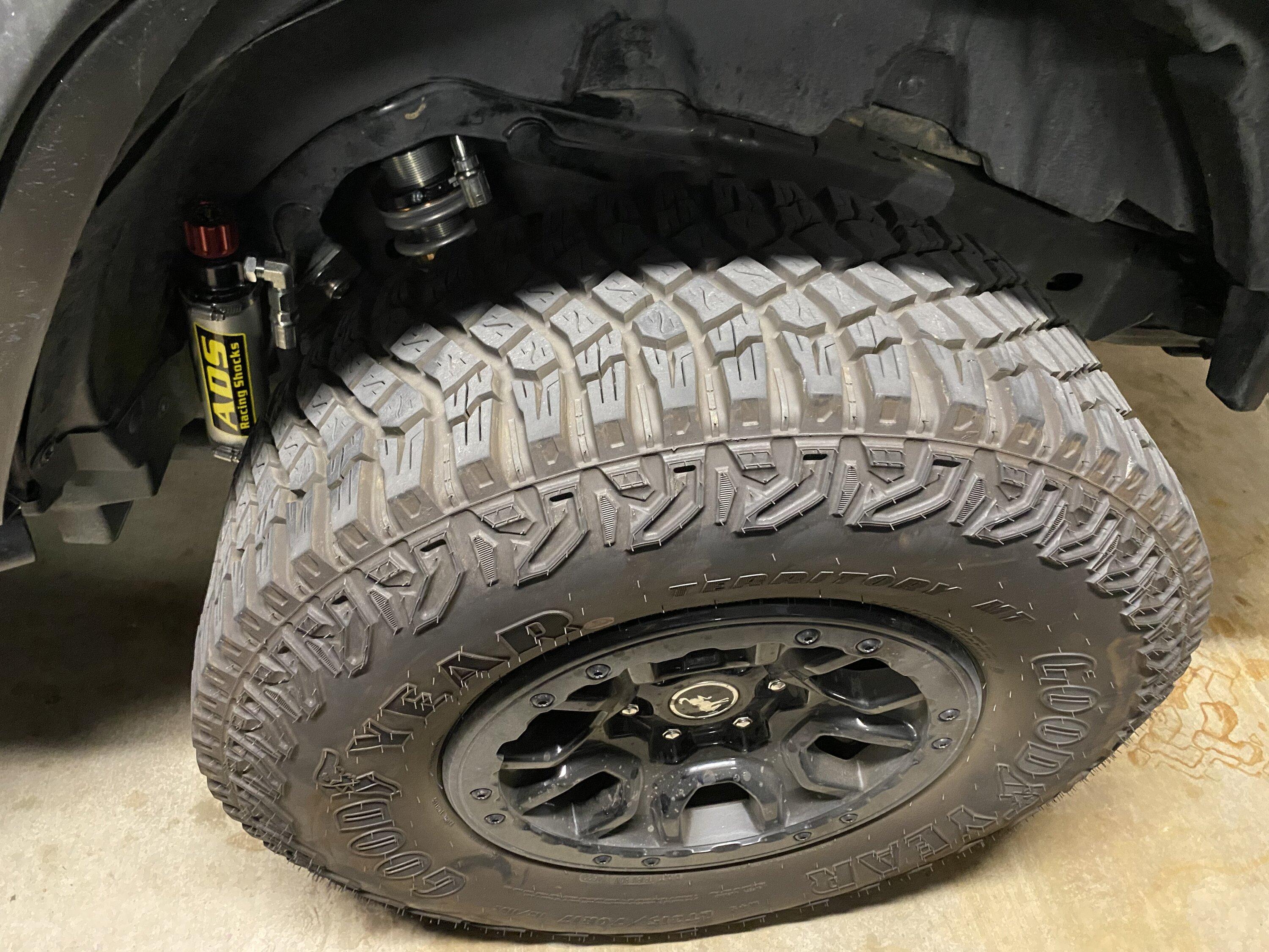

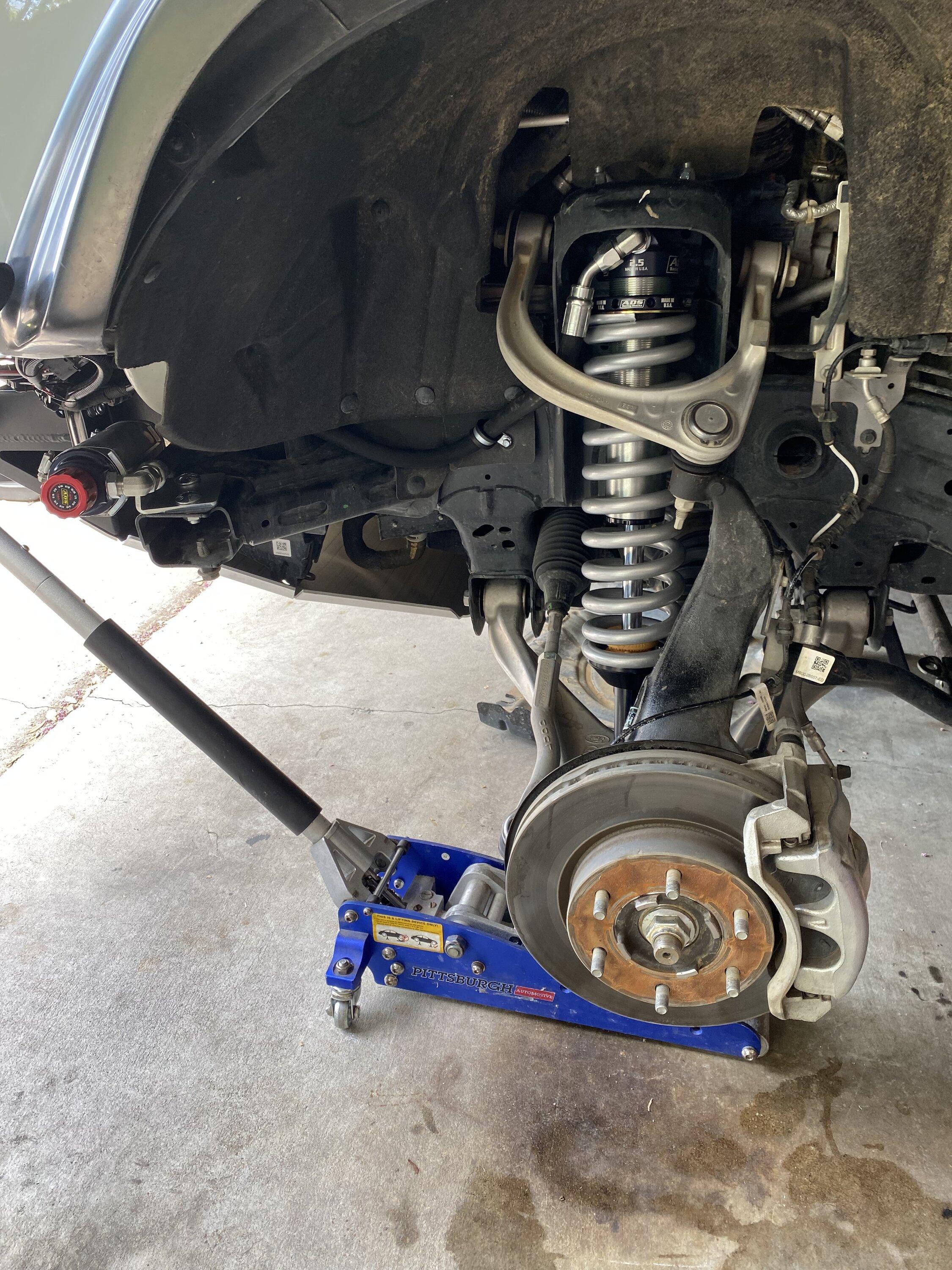

It doesn’t help y’all much, but this is what I ended up doing. The more I thought about what I wanted to do with the Bronco, the more a full adj. coilover made more sense in the long run…so I bit the bullet. It’s getting aligned now and I only have a few miles in it since I installed everything. So far I like the feel though, plush yet firm, and more controlled at the same time. Fronts are slightly more firm than the Fox’s, but the Fox’s were too squishy after adding the weight. ADS swapped the springs to account for my added weight.
Thanks to @Shifts And Grins Fab, Ryan has been awesome to work with.
Base Sponsor (Level 1)
Ryan
Feb 8, 2023
259
475
Gilbert AZ
shiftsandgrinsfabrication.com
2023 Badlands, 2022 Bronco Wildtrak Sas

Looking awesome!!! I’m glad you’re loving it. There was no doubt in my mind you would. The feedback we’ve received from everyone, not to mention our own experiences with the kit on our Bronco has been great.
