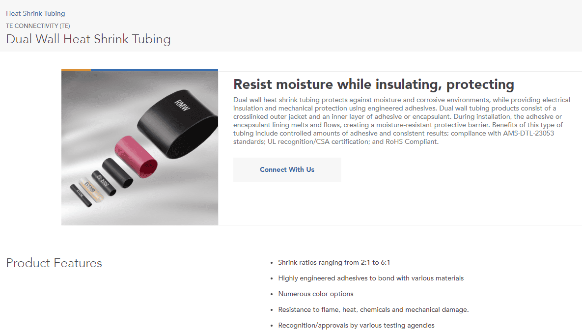

I work for a large manufacturer and some of our customers orders ask to have the electricals 'sealed'. We use what is pretty much a heat shrink tube that is placed over wired connections/plugs. If the product works correctly i'd say they were water resistant, but not something you would want to submerge for ANY length of time. It's like a silicone sleeve placed over the connection, then it's hit with a heat gun to 'shrink' wrap it, thus causing the internal adhesive to 'melt' around the wired connection, sealing it.

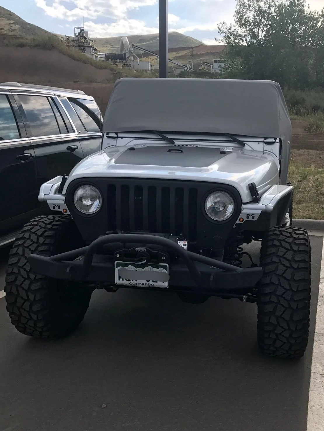

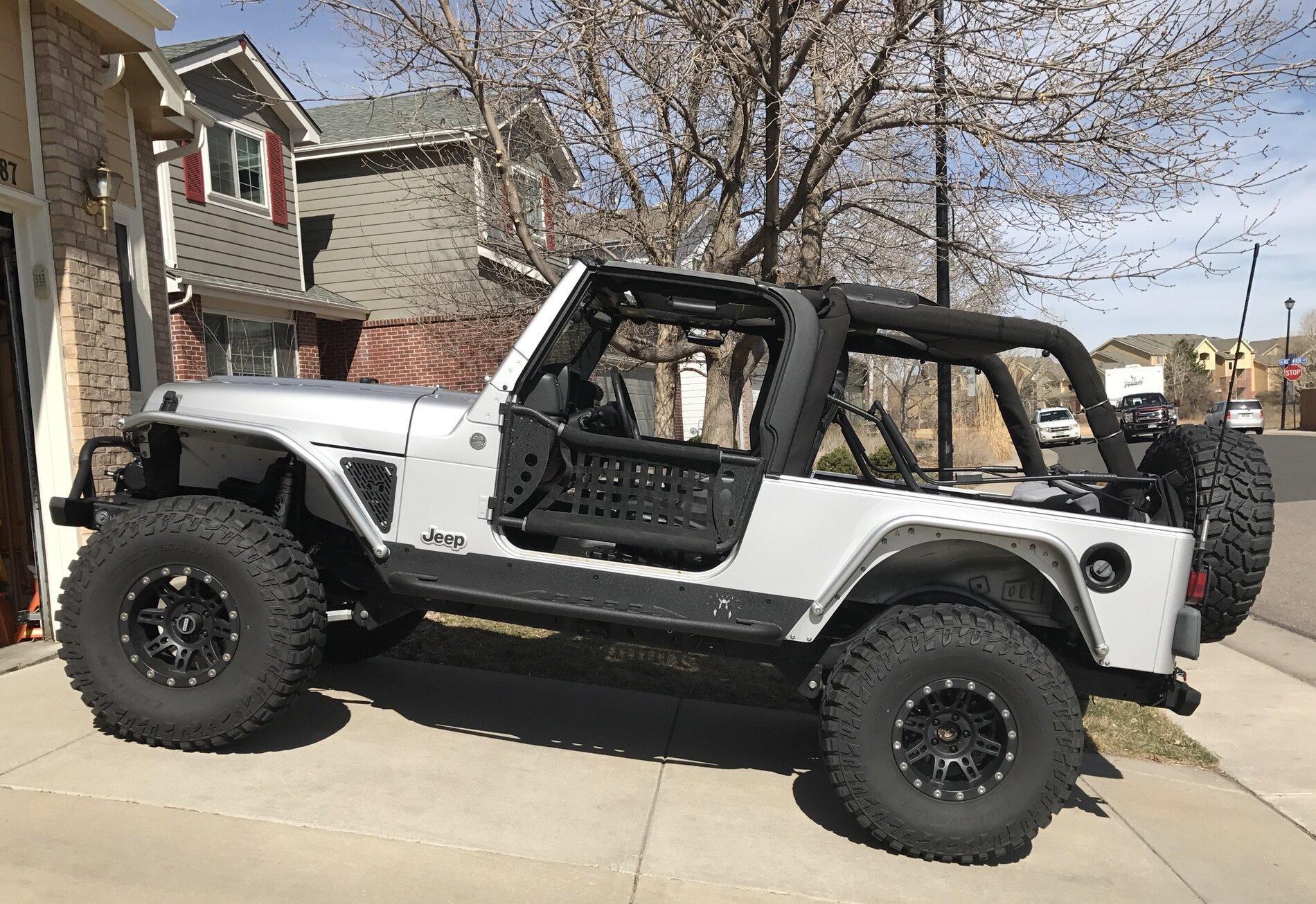

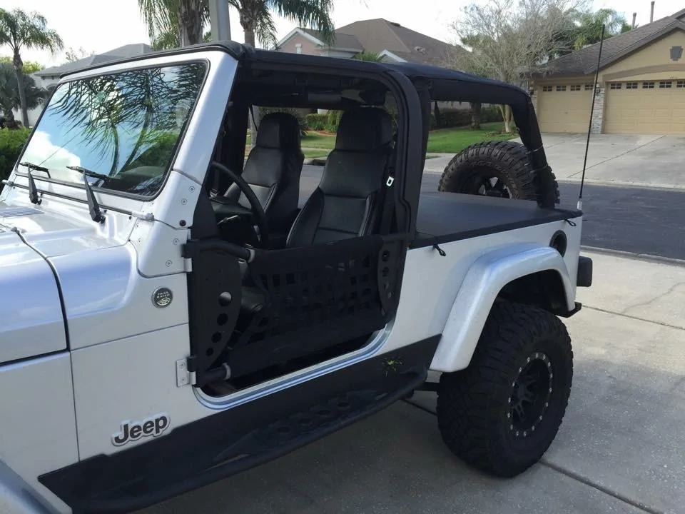

Like someone else mentioned, jeep problems (not just the JK but TJs as well) is the clock spring getting wet. I wouldn't trust the BL being waterproof and definitely not with the 12" screen.
I carry one of these covers with me that's folds up into a bag when I have the top off and doors off or trail doors on. I also run a safari top during summer/fall which at least protects the front cab area and you can see my tonneau cover as well.
