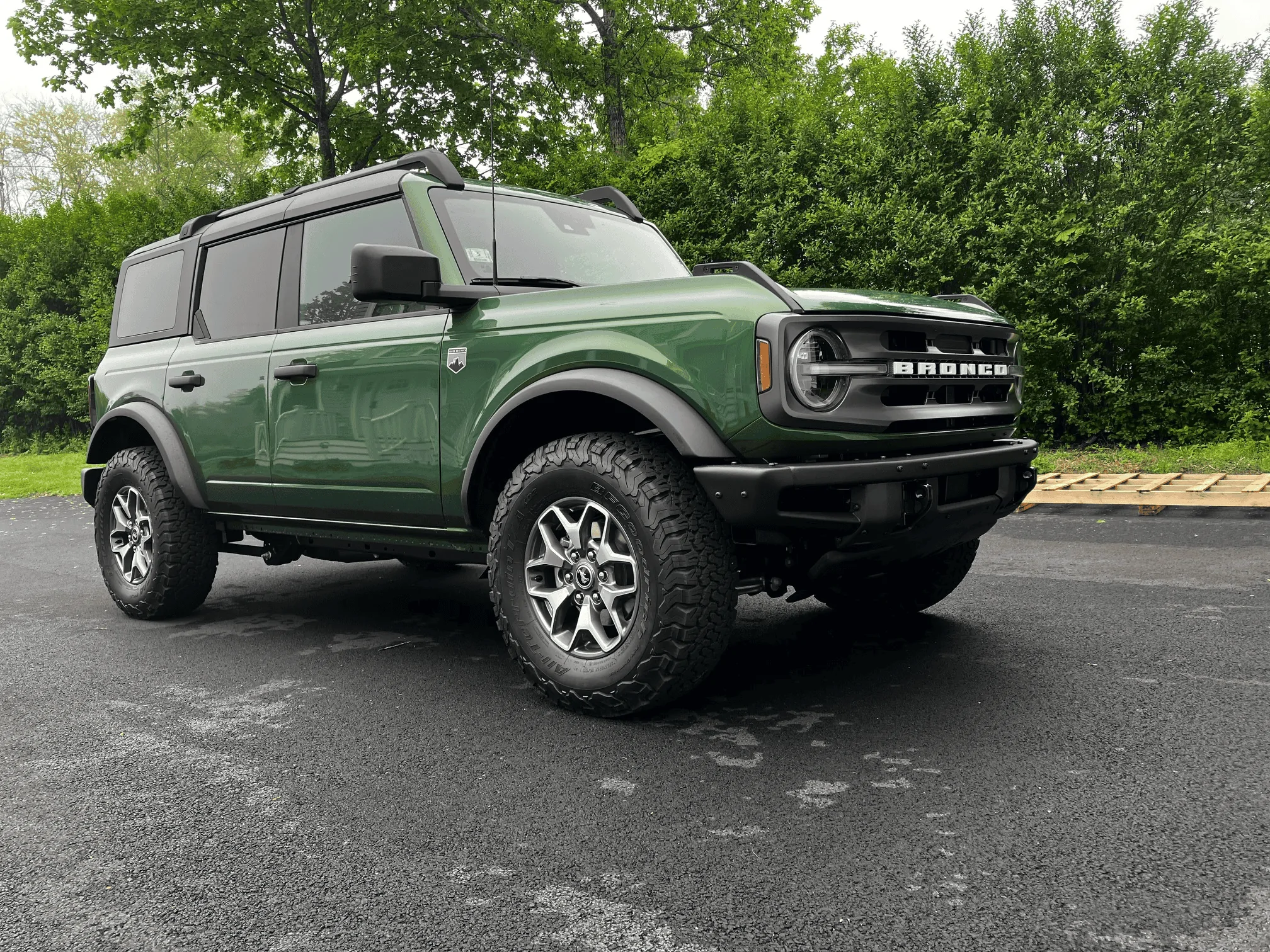

Last Friday I brought my new Big Bend home. The next morning I went out and started it up and nothing but black on the console screen. (no speedo, no tach, no fuel gauge . . .). I jiggled fuses and thumped a few things in the forlorn hope of something was loose. Nope. Called the service department who were less than helpful with a response of "Bring it in on the 21st and we'll take a look". With much self discipline, I calmly told them what I thought about bringing it in on June 21st, and asked to escalate it to a manager. Long story short I brought it in this morning.
I did drive the BB down and back to our summer house this weekend, using the Waze app as my speedometer (and trying to abide by engine break-in protocol), but it was less than a practical solution.
Has anyone else run into this issue? Anybody have any ideas on cause or remedy??
I'll update if/when I hear back from the dealer.
Thanks!
Update - issue resolved. My Instrument Cluster Panel has been replaced (as of 6/16), but it took well over two weeks and because of poor communication/execution (long story that I will spare you the details), five trips to the dealer at 1 hr+ per trip. Ford customer service had been monitoring since the beginning of this thread and requested feedback on the resolution process, which I provided on Friday. Ford reached out again this AM to say that because of my experience the dealer is offering a Premium Extended Service Plan of 75K miles / 5 yrs, which is better than a poke in the eye (I had been researching and was planning to purchase a longer plan, but free is free). The only thing that left a bad taste in my mouth is that Ford said that the dealer would normally offer this at over $3,000. I could have bought the Ford Premium ESP contract through Flood Ford for under $900.
