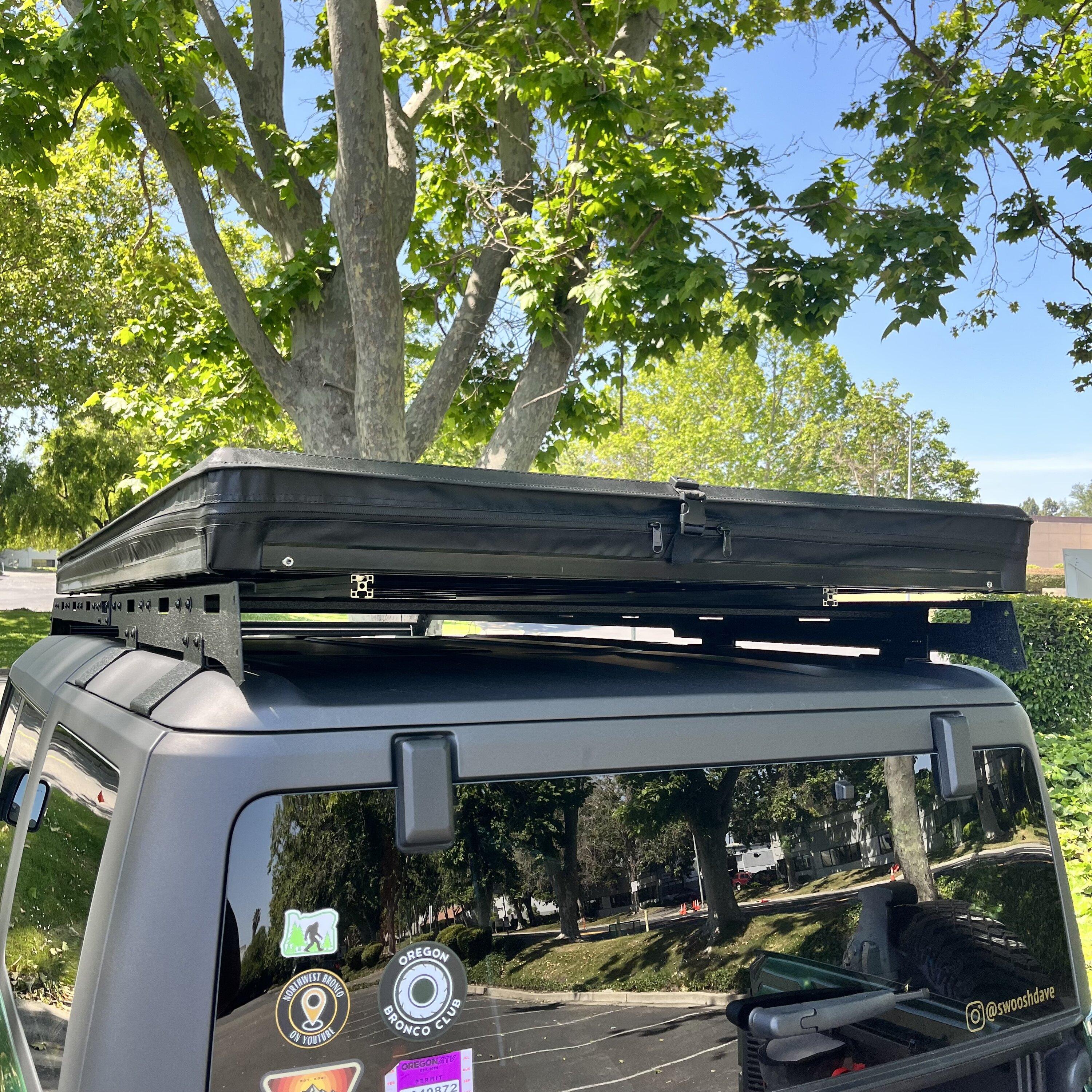

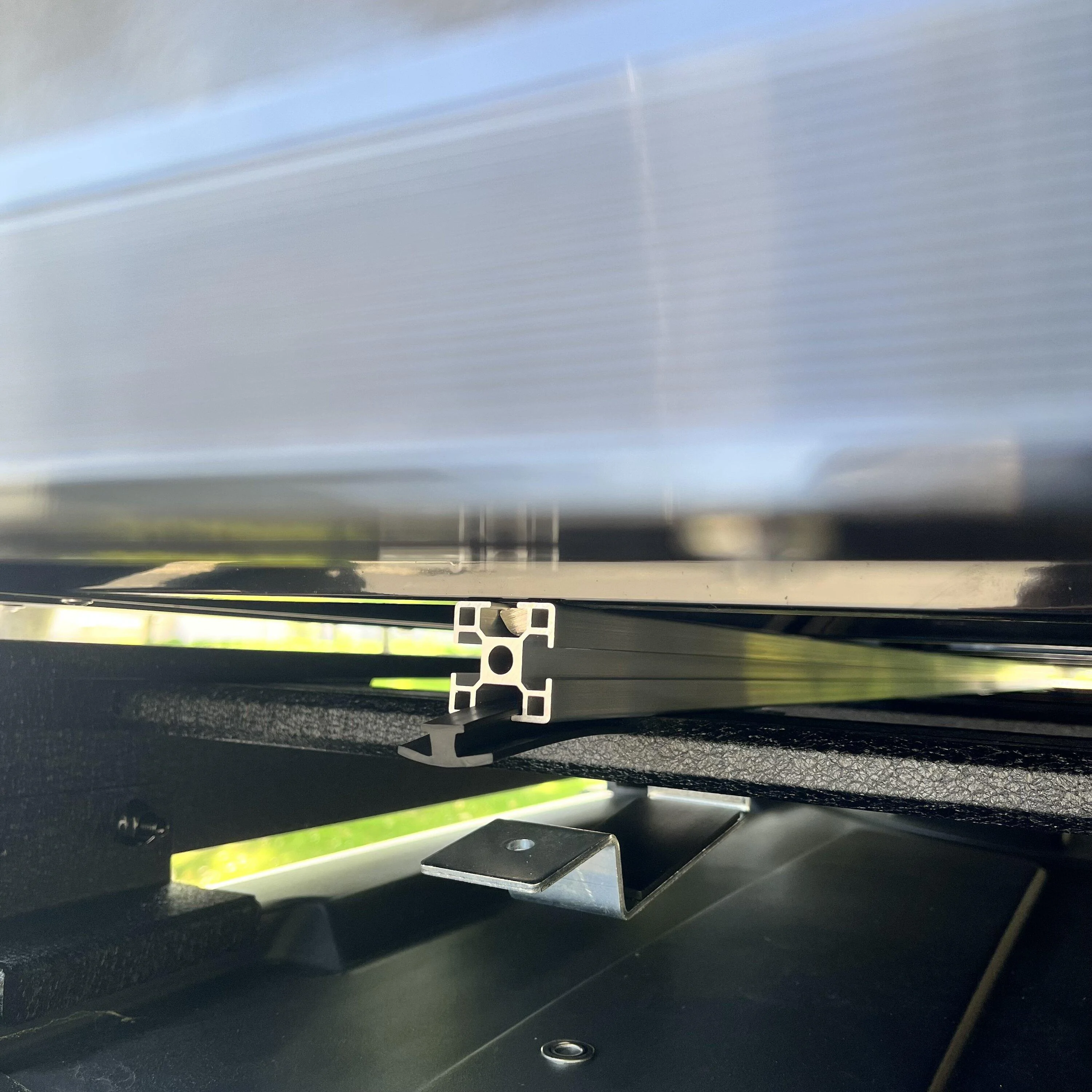

I knew I’d have to remove the rear panel so I had the proper tools. That gave me access to the rear mounts.
Note that the tent comes with two sets of mounts but for this rack you need the optional wider mounts.
Ford Bronco Inspired Overland RTT and Hooke Roof Rack installed IMG_0559
Be sure to slip in the top spacers into the channel before bolting it up. Don’t ask me how I know to do this first. :p

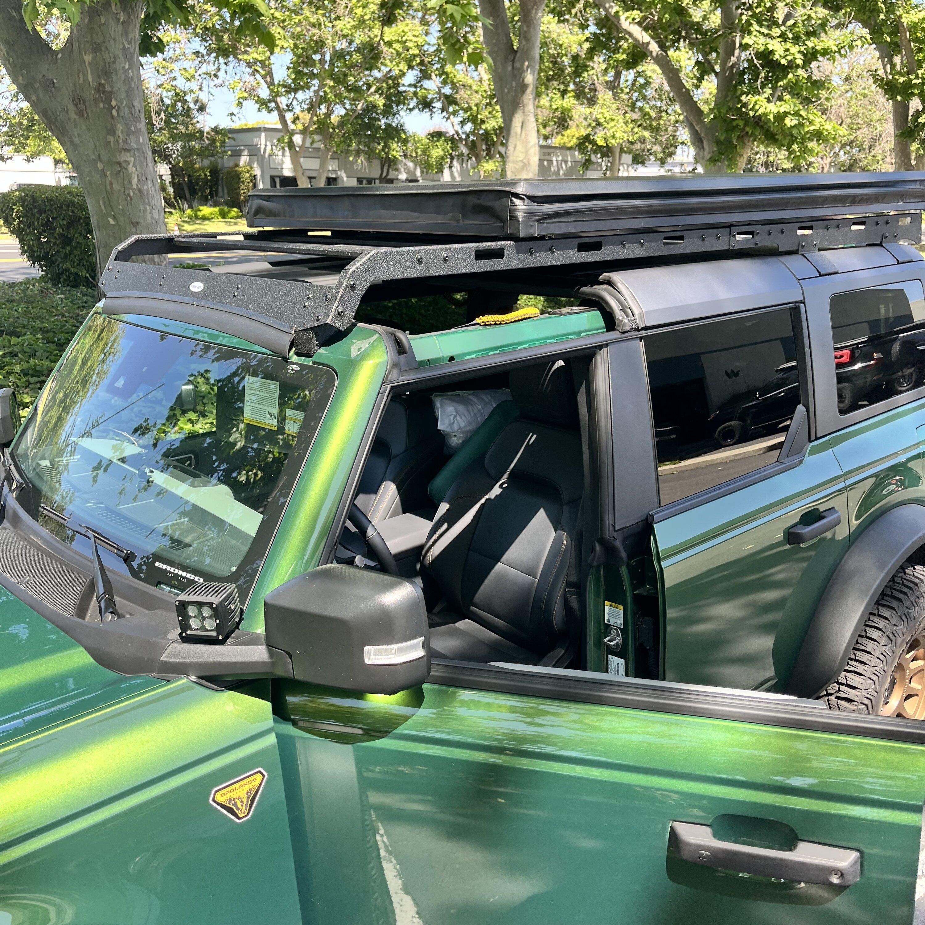

Ford Bronco Inspired Overland RTT and Hooke Roof Rack installed IMG_0558

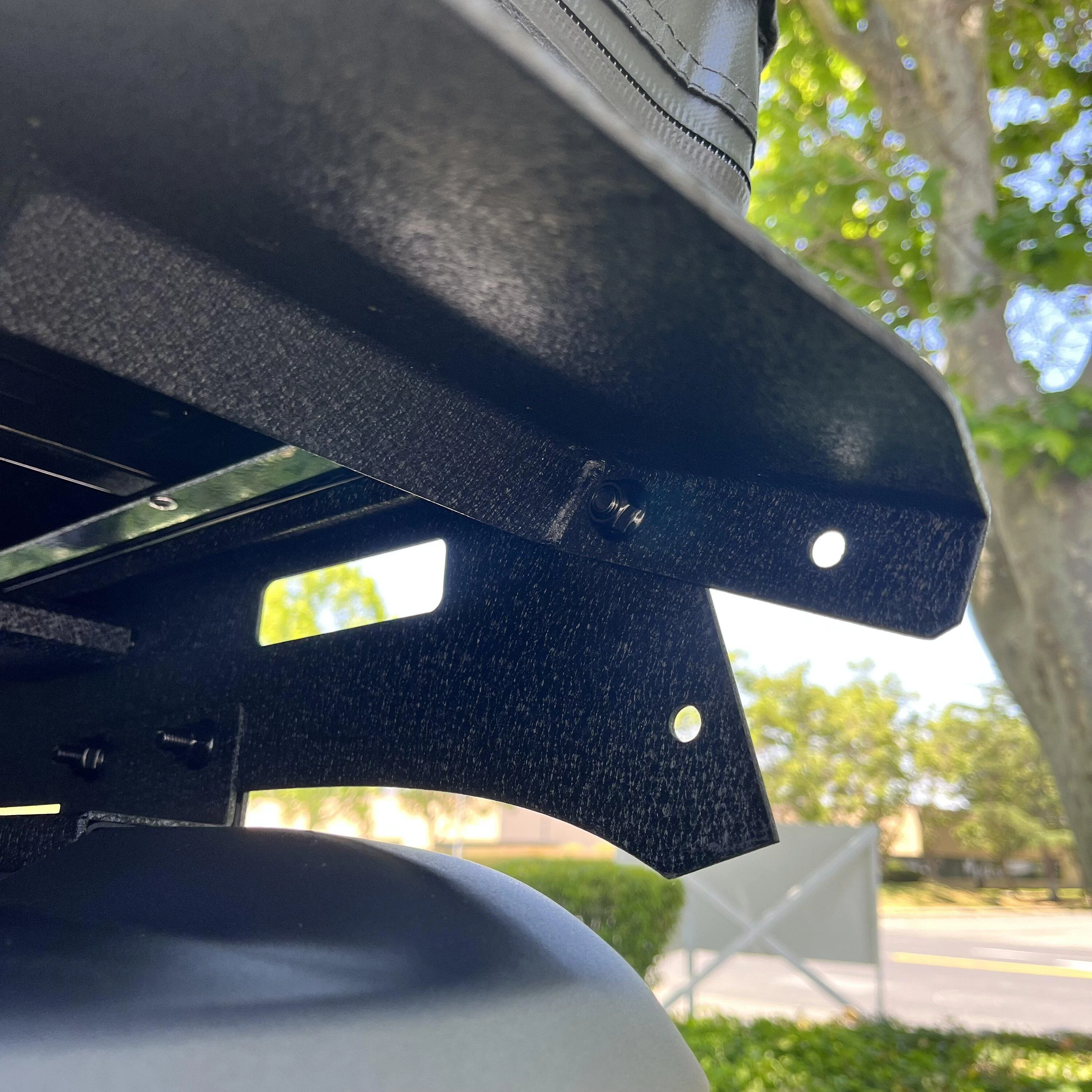

Then moving to the front remove the panels and install the brackets there too. The nice thing about the Hooke rack is that’s it’s actually pretty easy to get the panels off.
Before final tightening recheck the alignment.
Ford Bronco Inspired Overland RTT and Hooke Roof Rack installed IMG_0560
Ford Bronco Inspired Overland RTT and Hooke Roof Rack installed IMG_0561

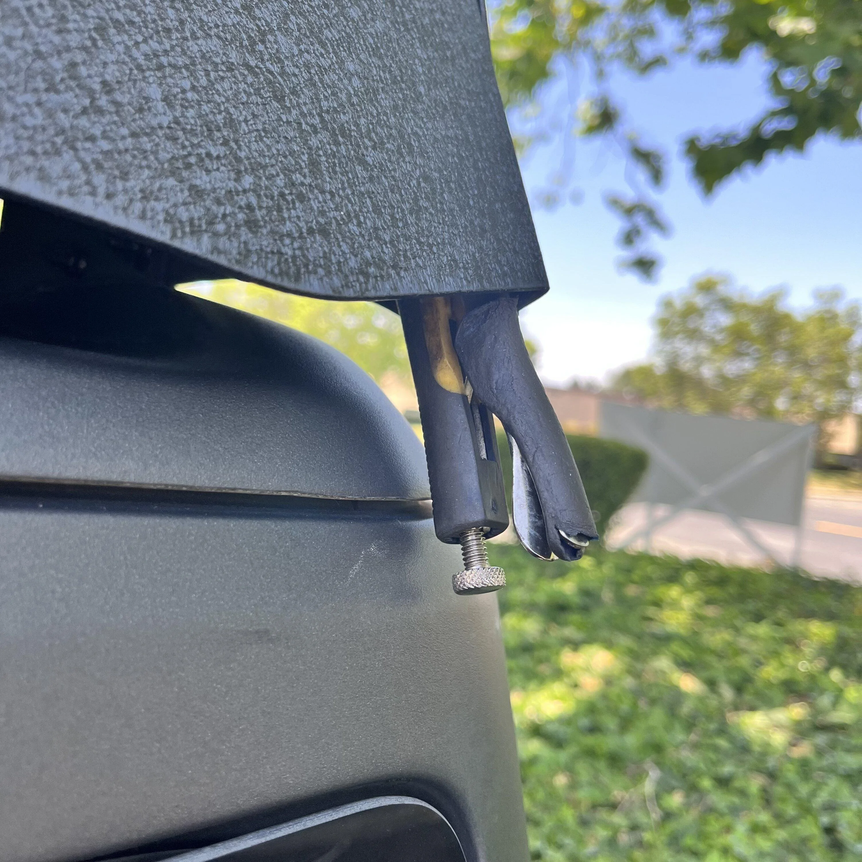

Then put the rear panel back on. I had some needle nose vise grips that worked perfectly to hold the top nuts.

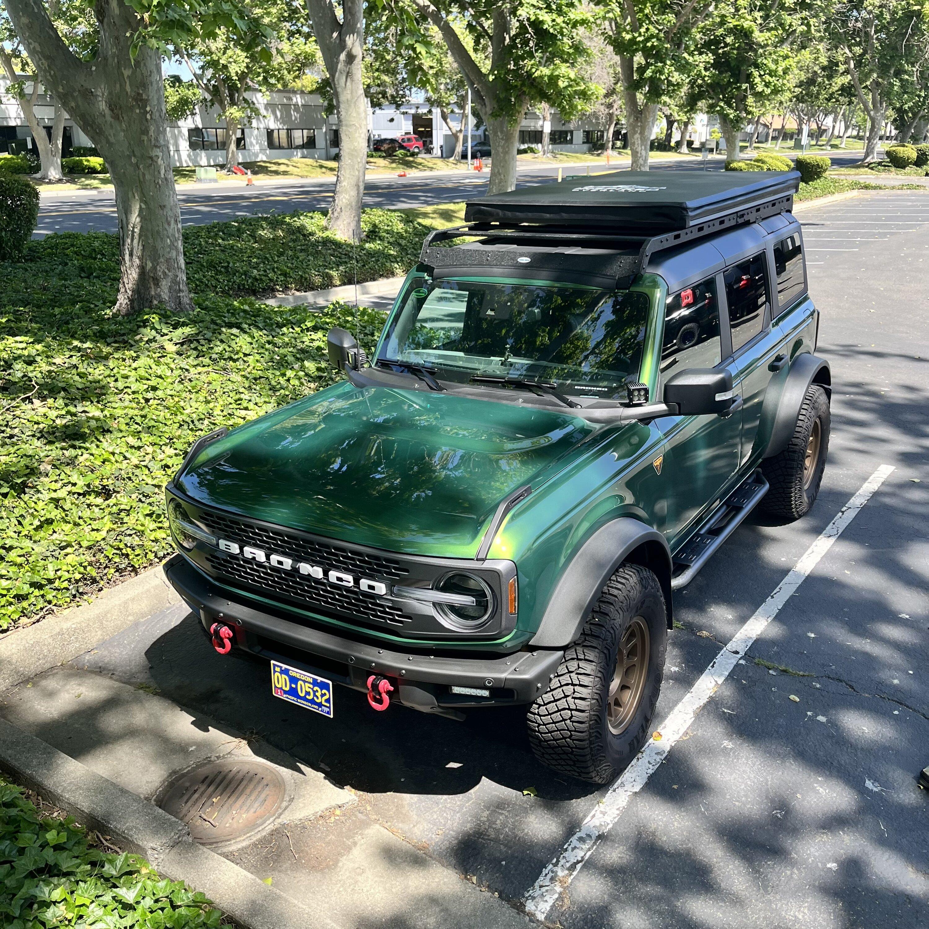

Ford Bronco Inspired Overland RTT and Hooke Roof Rack installed IMG_0570

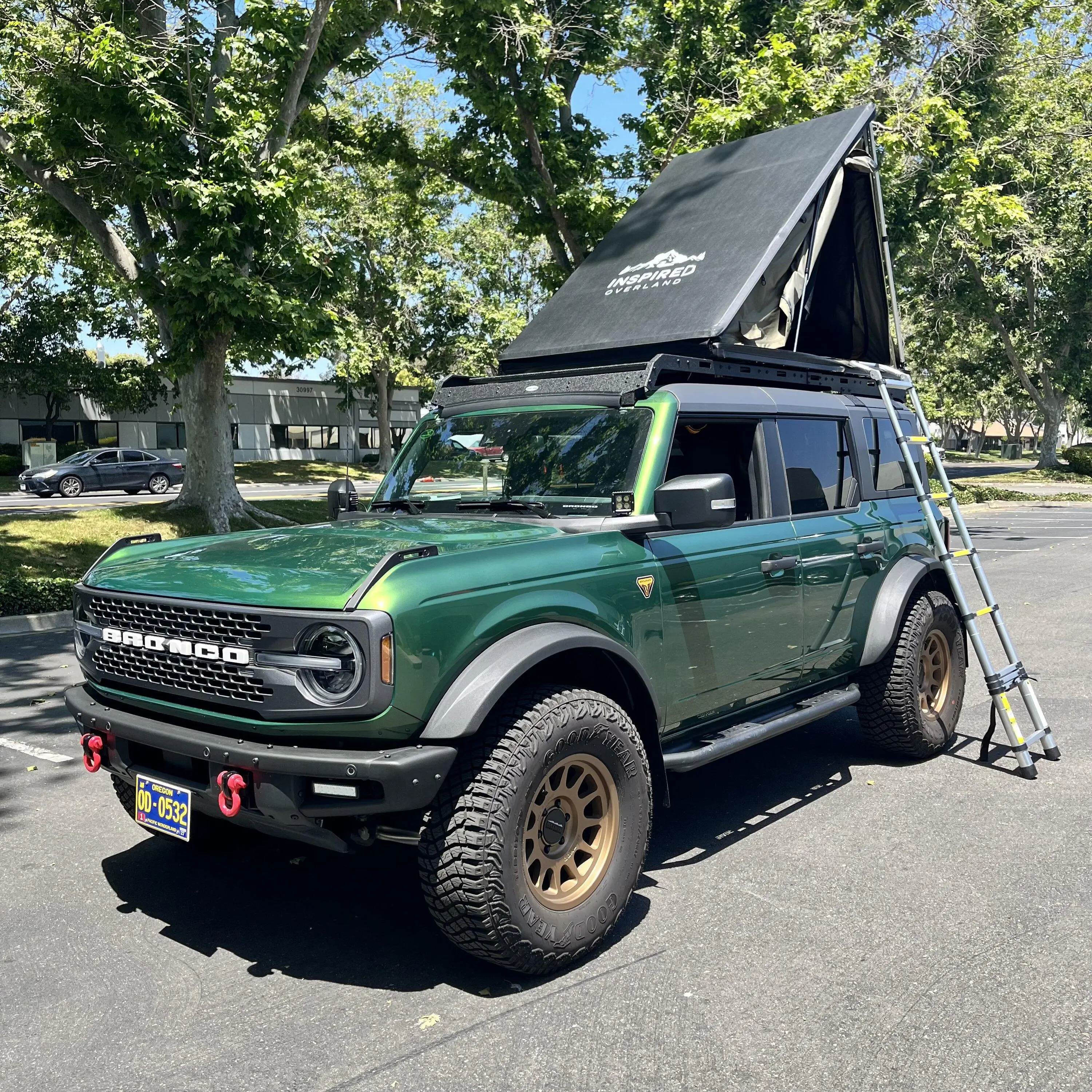

I head out into the wild in a few days and will update my impressions of the tent. The tent doesn’t seem to add any wind noise on top of what the rack produces.
Ford Bronco Inspired Overland RTT and Hooke Roof Rack installed IMG_0568
Ferdinand was great to work with. There were three other rigs there at the same time as I was.

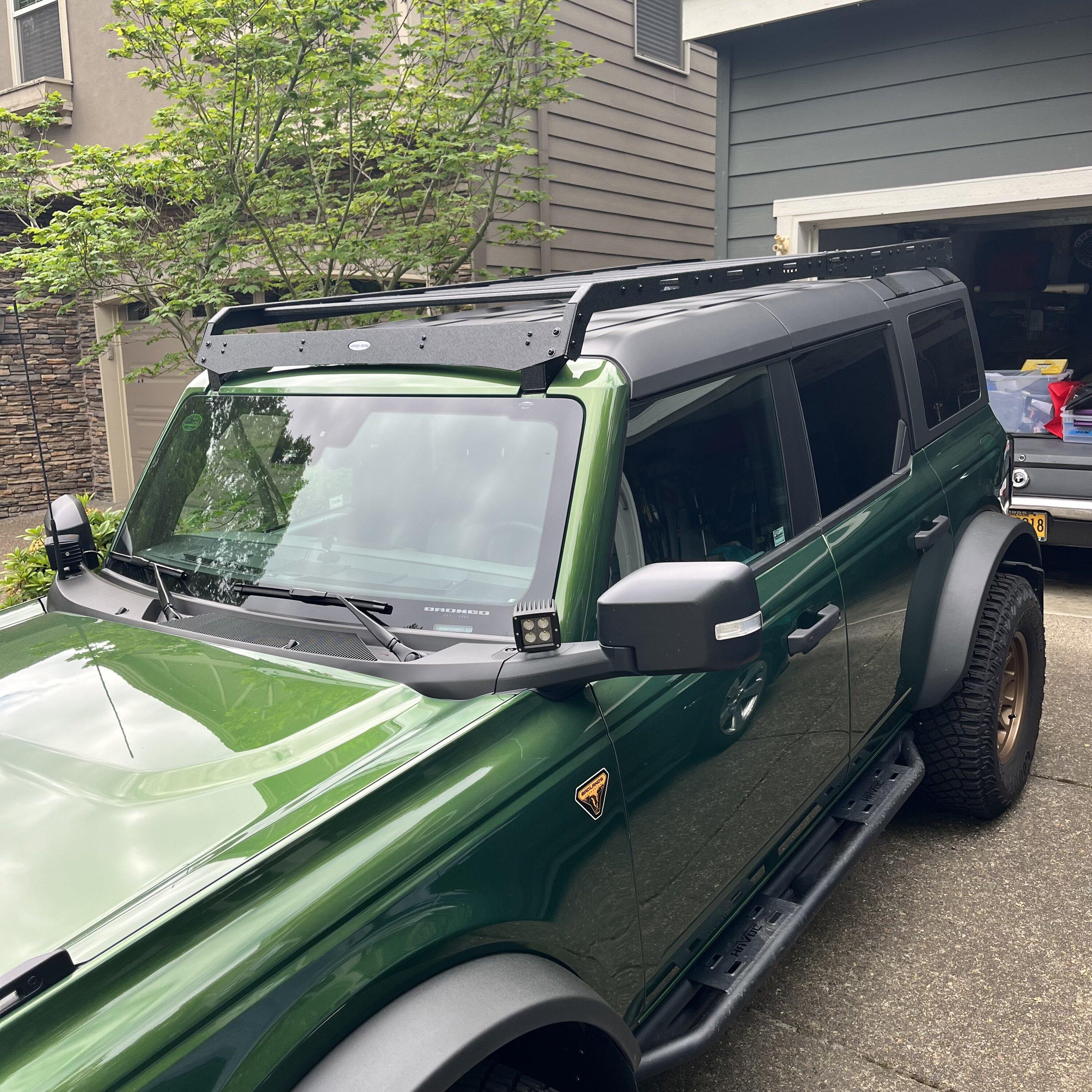

Snap! Nice set up. I'm trying to get my OVS 180 awning on the OEM roof rails. Not as easy as I'd hoped!
Ford Bronco Inspired Overland RTT and Hooke Roof Rack installed 20230429_151658
Ford Bronco Inspired Overland RTT and Hooke Roof Rack installed 20230516_181605
