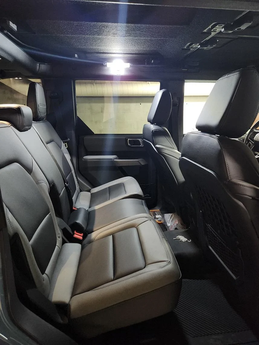

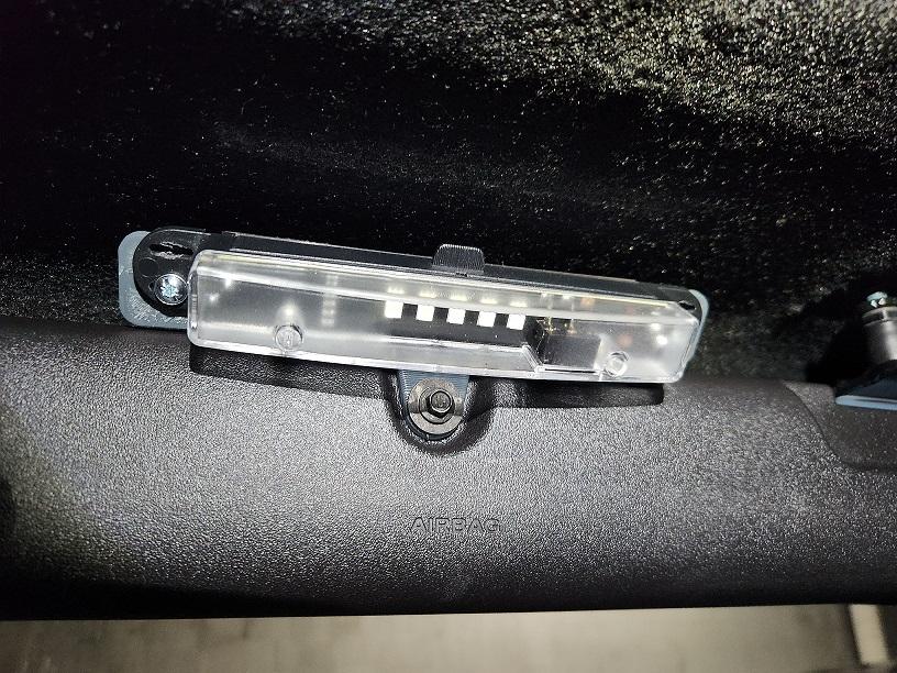

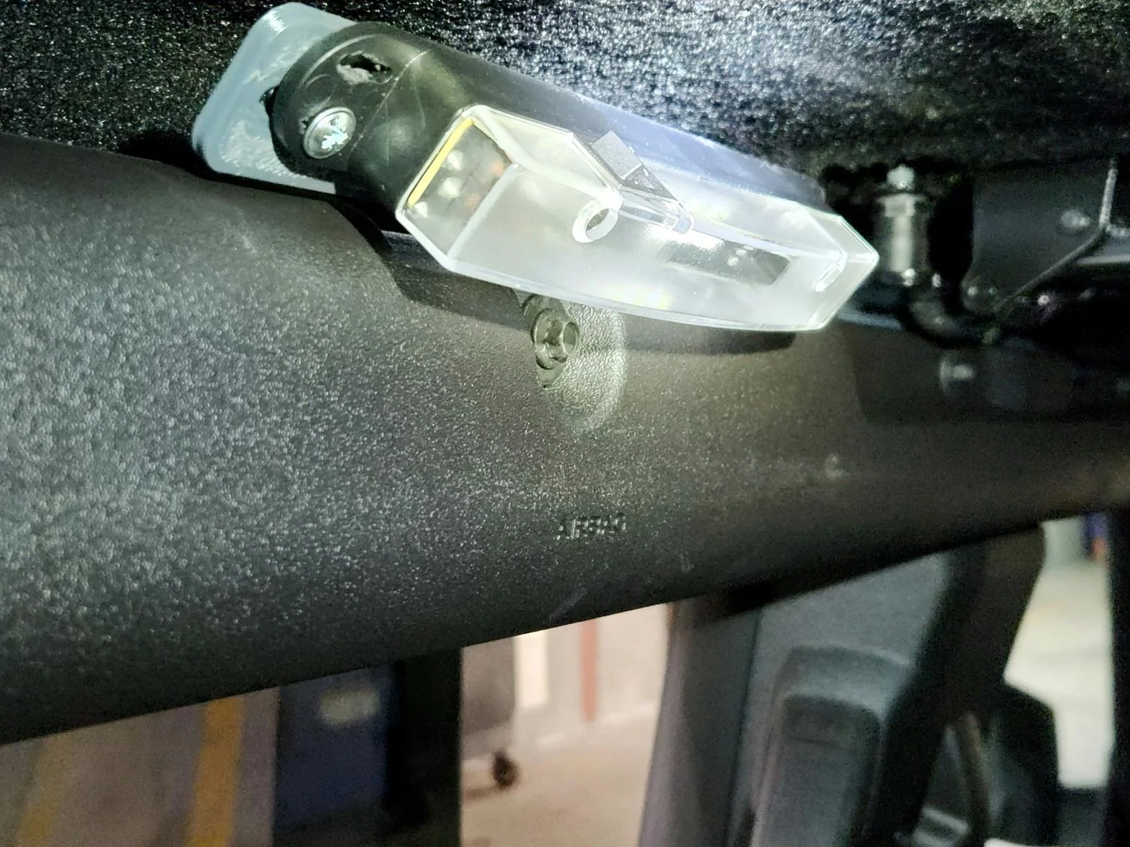

I designed a special bracket that I 3D Printed to fit above the Rear Passenger overhead bar using the bolt that's the single recessed V spot. I used a battery-powered LED light that has its own switch from Amazon. I had to drill out the slots on the LED light so that the M4 bolts with Flange Nut could go thru.
Click my Amazon link below for the light I used. I purchased two and I mounted the second one on the Rear Roll Bar in the rear cargo area since these lights come with a Roll Bar Velcro Strap as well.
This was my idea to fix the dim lighting in the rear passenger area. I wanted something that wouldn't need to be hard wired.

That won’t affect the side curtain airbags?
I don't believe it will affect them since it sits above, and the light I used only comes down like 1 inch from the angle. You could get a smaller flatter light to mount on it too.

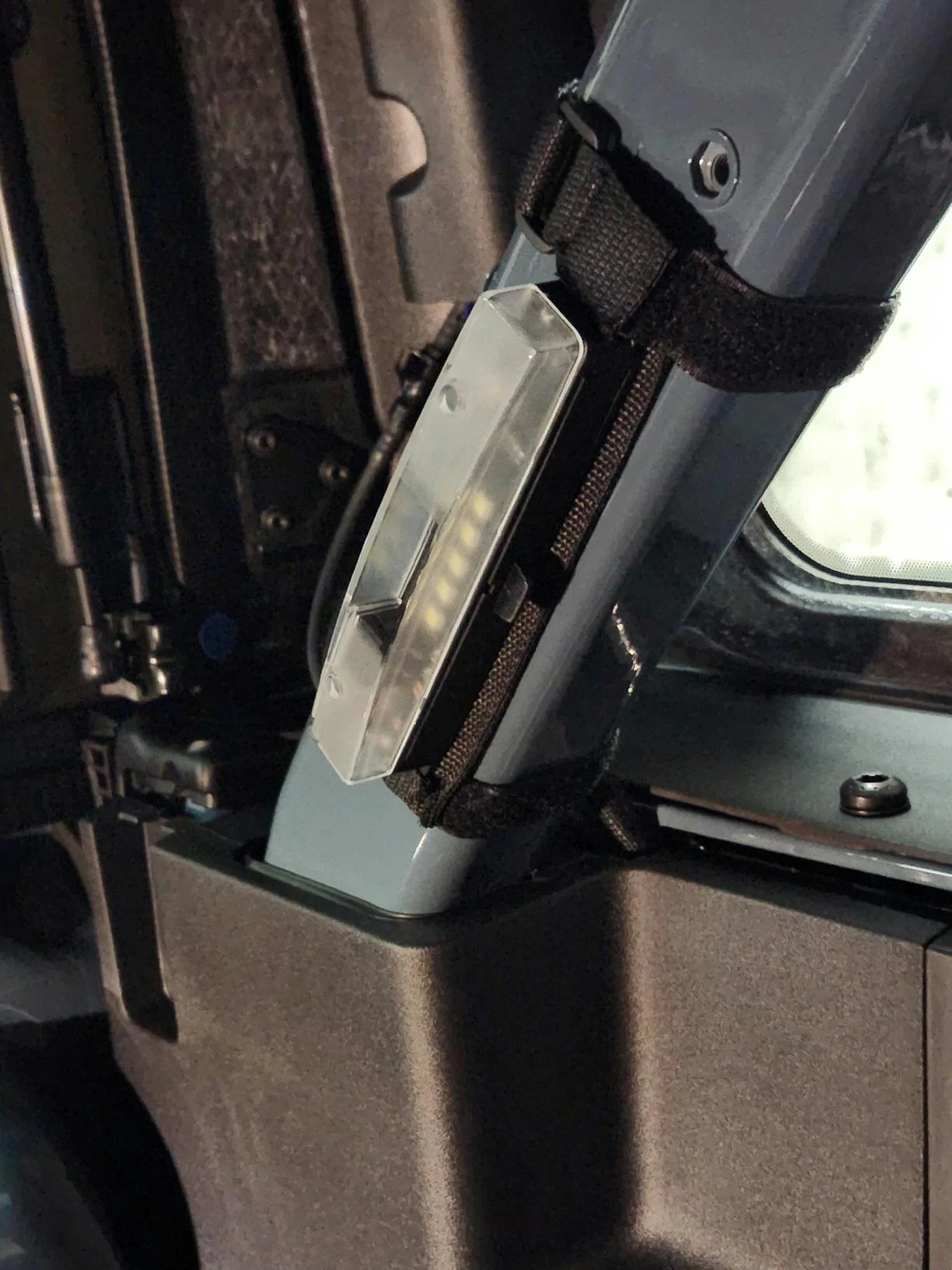

Did you use the velcro straps for the one in the rear & just the bracket for the side ?
I would be in for one.

Here is the light in the rear using the velcro strap and a close up of the bracket mount.

The main mounting hole was made to fit the bolt above the airbag which is smaller than the holes on the Roll Bar. I can change it or you could drill it out. The slots can fit a 1/4" dia bolt and the overall length is 8in.
