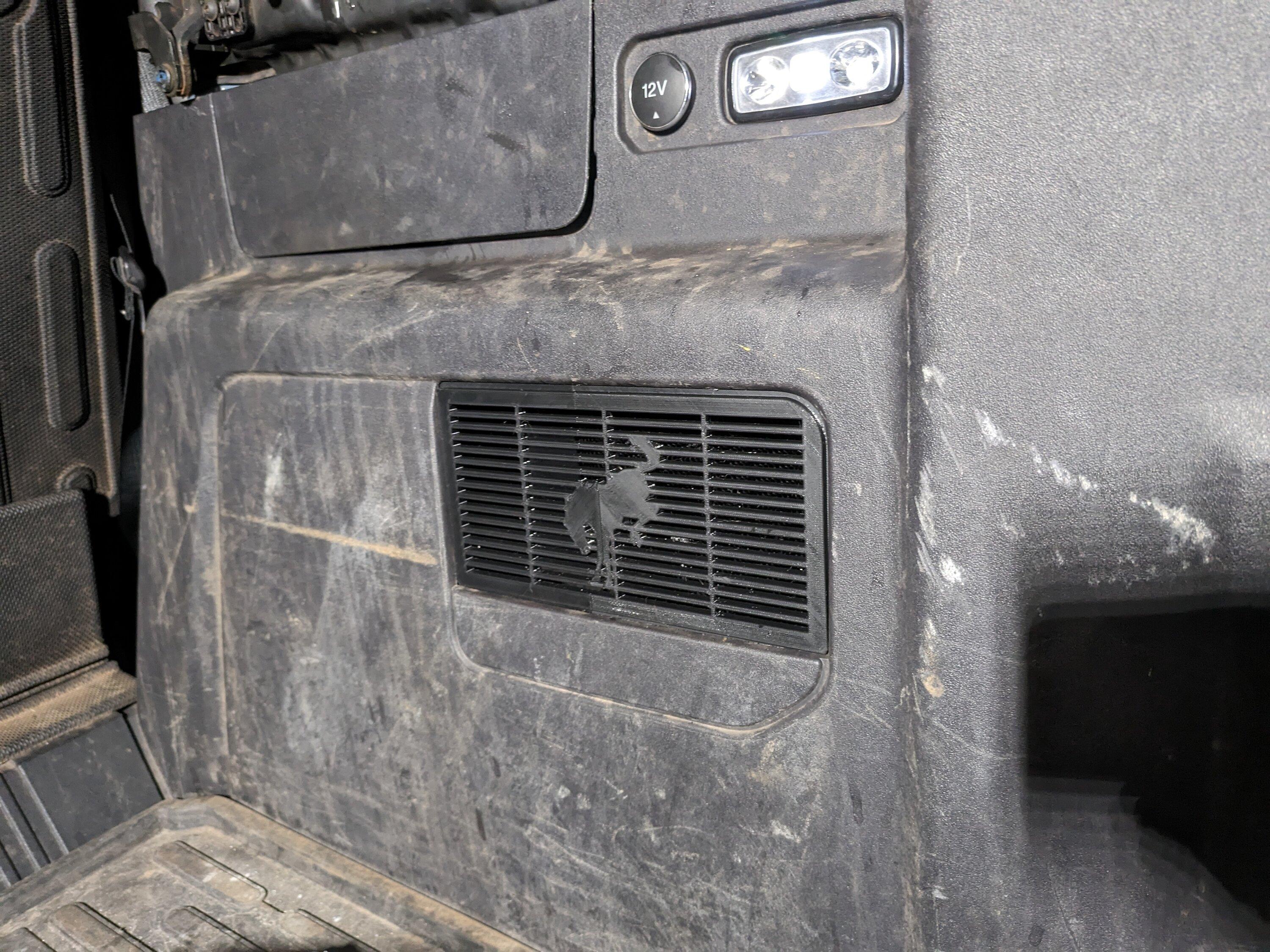

Added a Kicker HS10 subwoofer to the bronco (non-BO). I put the HS10 in the factory sub location, where it barely fits. I needed a grill cover for the hole left from removing the cubby, and made this custom logo grill. I wasn't up for paying $50 online for the only option I could find.
Ford Bronco subwoofer install, custom 3d printed grill (non-BO) PXL_20231228_163930255
(yes, picture is not great, and my cargo area's a mess right now :) )
3d files attached

What does the woofer enclosure look like?

I sent the file to a buddy that attempted to make one this past weekend but had a problem with his machine. Hes gotta fix something then giving it another try. I'll report back when he gets it done about fitment.
Note, i didn't do much for mounting. One file has a larger area (what could fit in my printer) to mount on the back of the trim panel. For now it's just hot glue'd on there.

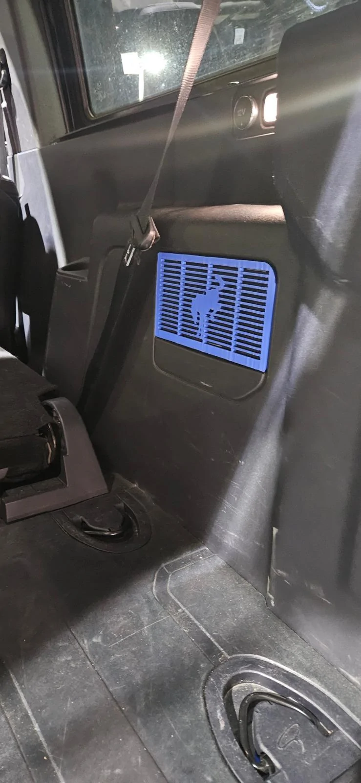

Forgot to post the final product. My buddy had some blue filament so I chose that. He is still learning his printer so with time it might be cleaner but I'm pleased with the outcome. Thanks again for sharing the file!
Edit: 2dr and 4dr are the same
